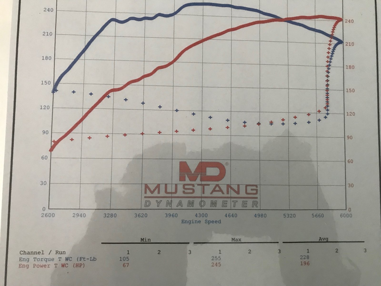

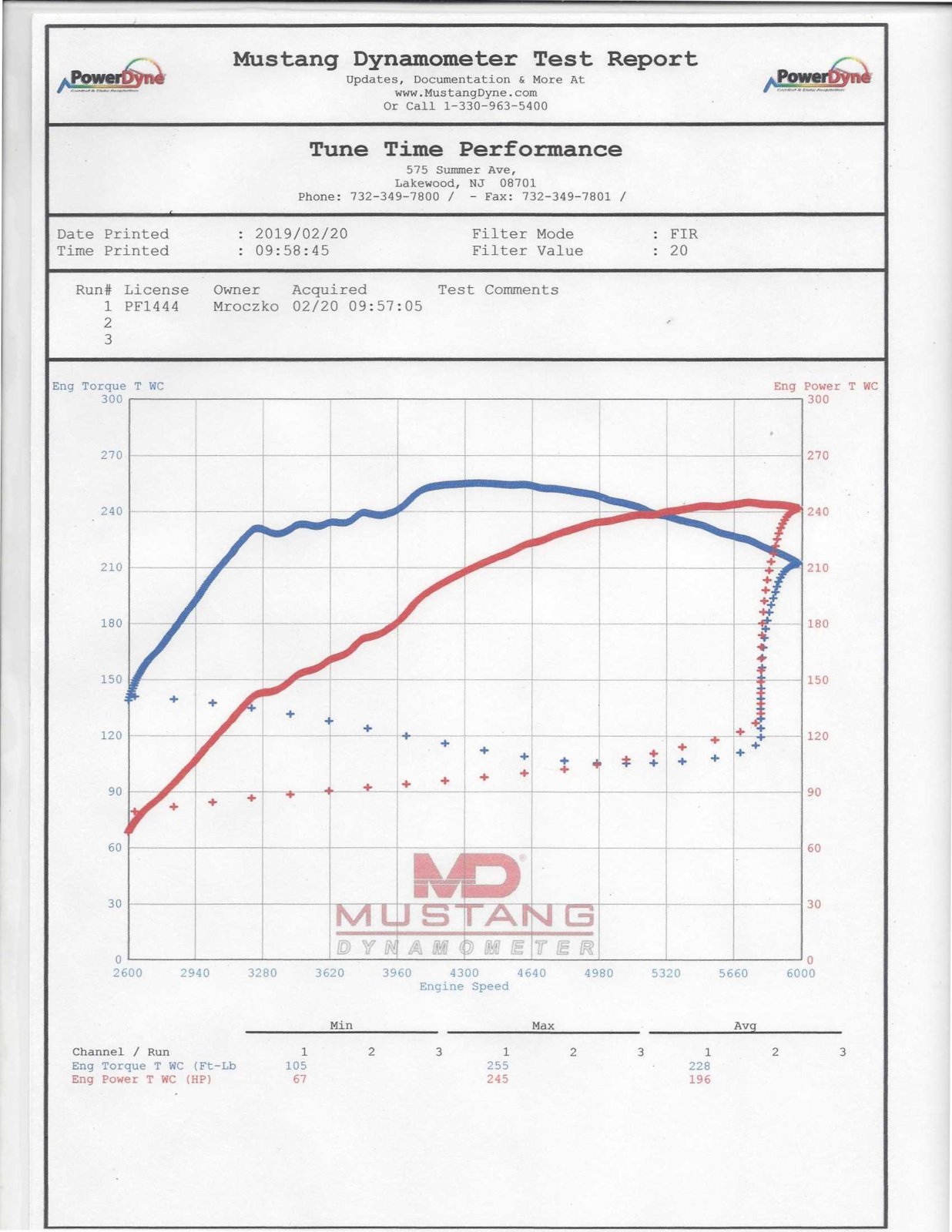

Came up blurry for me, can't really read it. What were the baseline numbers?
They have laminated the print out, is this any better?
Much better... Surprised it made close to its peak torque so low, not bad for a stocker. You'll see 150hp at the wheels I'm sure with the blower and cam if not more depending on supporting mods. Maybe close to 200hp since you're doing headers and exhaust. Which heads are you running?
