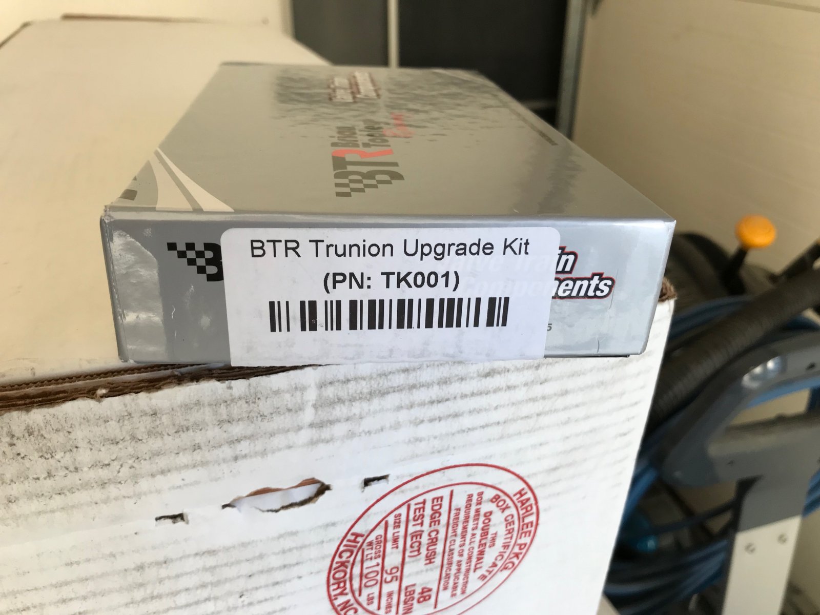

Here is the kit I got, I believe Matt has the same one. I don't know enough about lifter failures so can't help you with that, will tackle when it comes. It’s best to give BTR a call they will make recommendations. Thank you for head up.

Thanks, yeah I have the trunion upgrade. That's for the rockers. Good luck with the trunion upgrade..******* the fingertips lol..

sorry wrong box, have them at the mechanic shop already. So you don't recommend changing them?

Correction, didn't even get them yet. Ordered them last week along with the trays, too much going on at once lol
