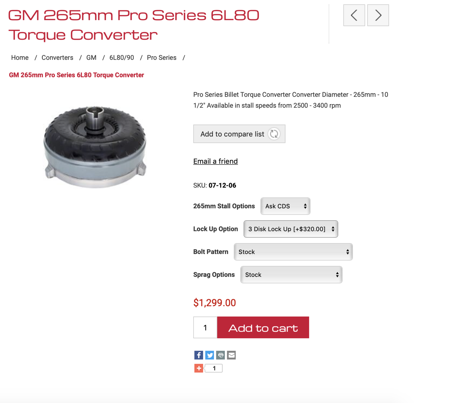

is that the one you guys are talking about 265mm triple disk lock up?

how do I know that is a 265mm not 258mm or other? sorry if it a dumb question
Not a stupid question.... Get ahold of Chris or Glenn @ Circle D and see what they suggest. I got the 265mm Pro Series Triple Disc. 2,800 stall in the 1A Stator combo (for a tight stall in a heavy truck). I got mine from GWATNEY Performance for $1175 shipped direct from Circle D. They do one free stall change or repair if you blow it as many of the high end companies do. I considered others, always came back to Circle D. Nothing but great things and service from them.

now why would I need to replace the stall?
Just in case you break it or decide you want a looser (higher) or tighter (lower) stall. You want it as tight as possible with these blowers since they make so much torque down low.

You want to spec your stall to the cam. The idea is for the stall to be 500 rpm above where the cam starts making power. I had a 26-2800 circle d and liked how tight it was, but at times it felt too tight. I went to a Precision Industries 3k billet triple disc (5yr warranty, free restall within 1st 2 years). It gets into the power quicker and is slightly looser, but I like it.
Also you want to spec a PD blower cam with less overlap. U don't need a big cam for forced induction application. My Vinci trucker cam is real close to the BTR stage 3 truck cam specs but i have a 6.0 and it's a blower cam. What works in a forged 402 may be a big cam in a 5.3. It will be weak down low and you will need to compensate with more stall. No amount of tuning will help that.
