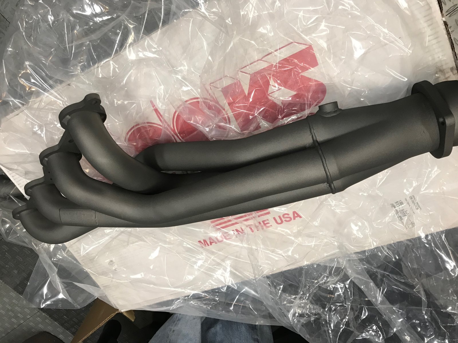

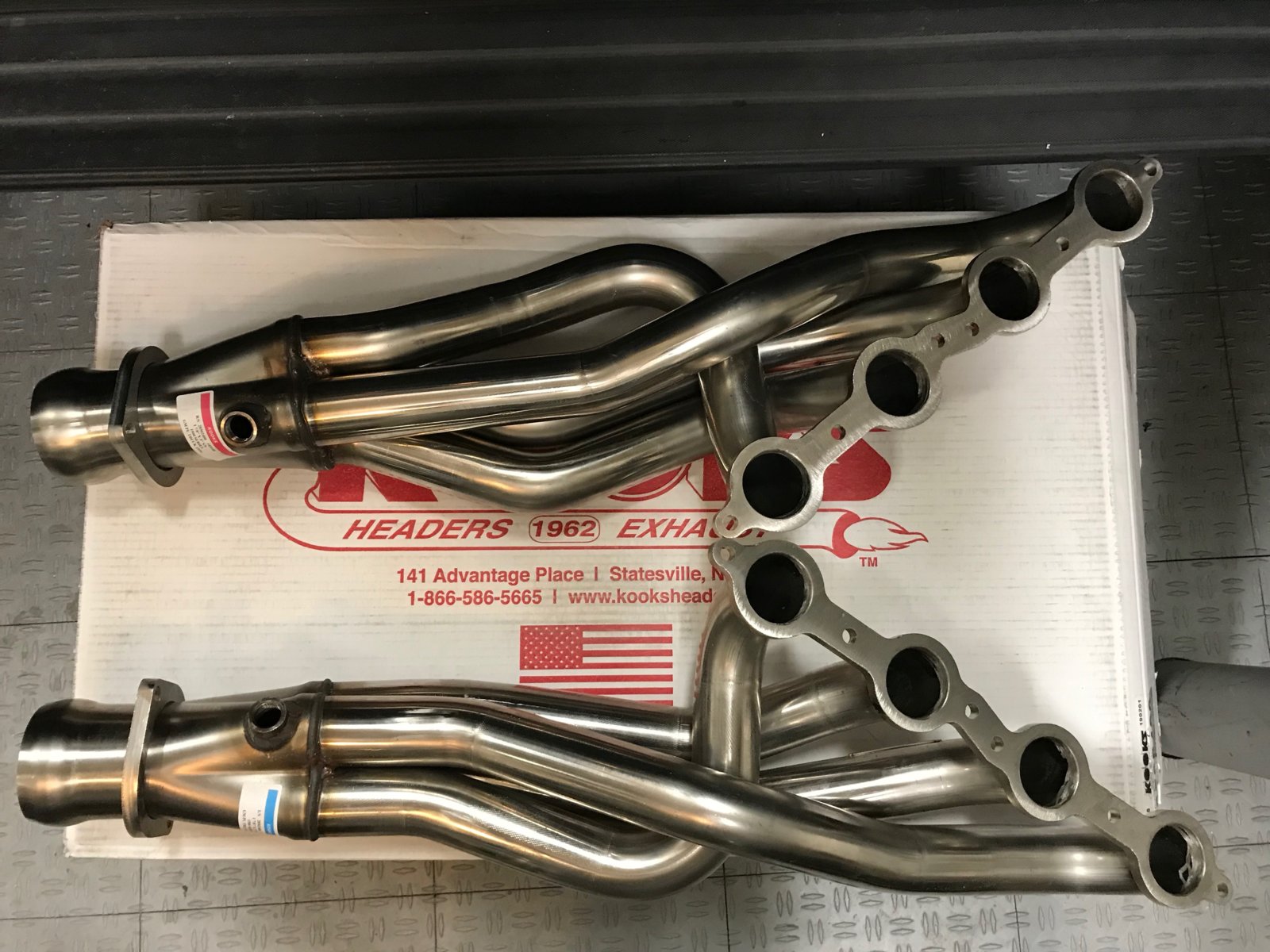

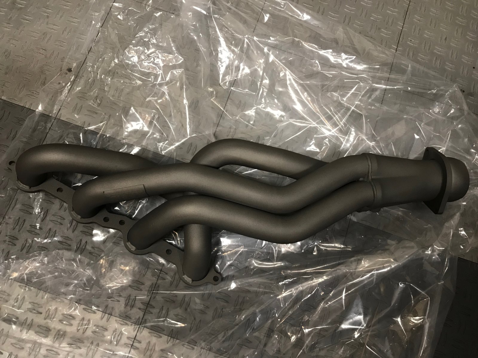

Got my headers back from ceramic coating.
