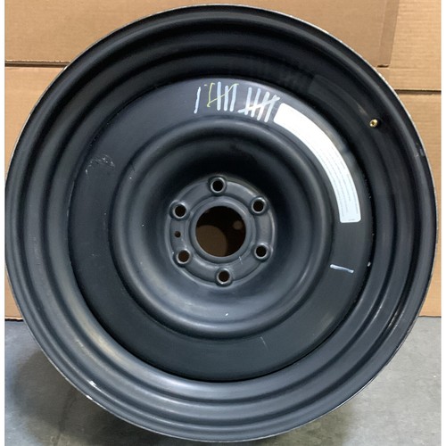

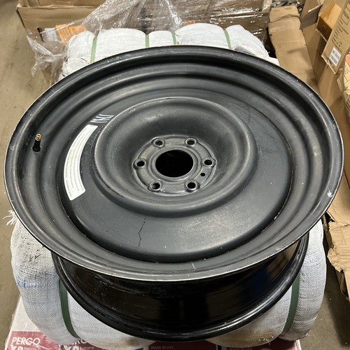

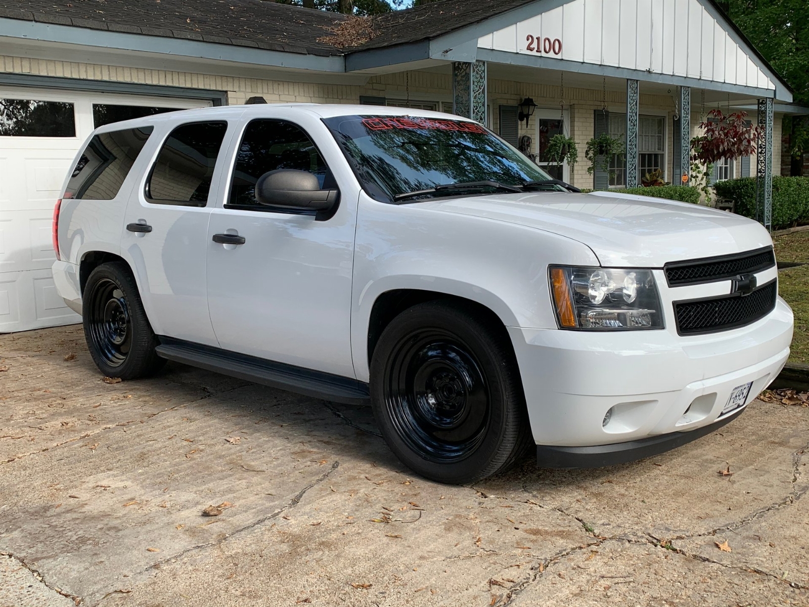

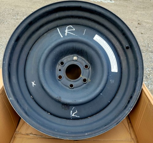

My wheel plans just finalized.
I'm doing the 22x9 transport steelies with chrome caps, to keep the police theme.
The below picture shows the wheels I'm talking about, but without caps. Credit goes to whoever owns the car.

Every time I've seen a set they were $1500+
That didn't take very long.

They're so damned hard to find for a fair price. I saw a set on my local MarketPlace a couple months back. I think he wanted $800.

Why are they still hard to find after 3 links were posted?
My point was that they're hard to find for a fair price these days. Really, the ones in that first link you posted wouldn't be bad at $720 shipped. It's the market and what you're willing to pay that determines the deal. My feelings are from the perspective that, a few years ago, they were $400-$500 any day.
