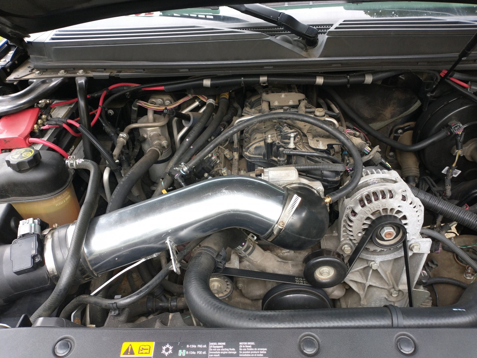

A fricking spectre cold air intake showed up at the yard today!
I grabbed the tube and rubber couplings. Yay.

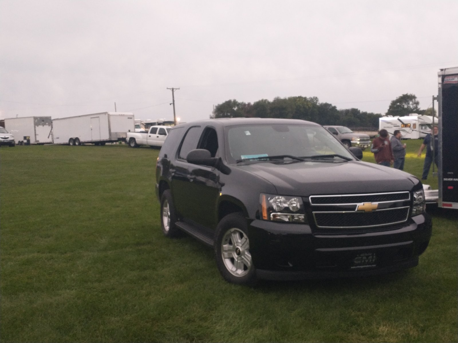

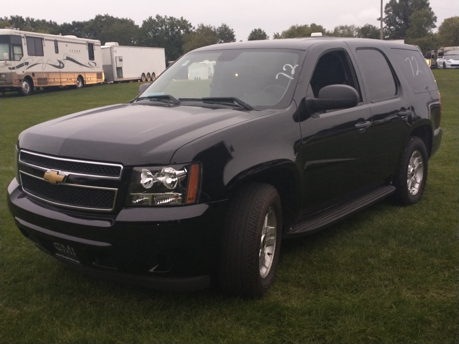

Today is race day!
The weather looks perfect. Nice and cool, with no rain.
I will experiment with a few different methods... Traction control on/off, manual vs auto shifting, etc.
Coming soon is a picture of this intake tube, and some crappy phone videos of me racing a Marauder.
The intake tube was kind of an awkward fit, since I'm not using it for it's intended purpose, but it works.
Caddylack
Caddylack
May 12, 2022
236
215
I'm not sure if I have a way of hosting a video file right now. I don't use social media, other than car forums.
My buddy didn't run his Marauder, but I have a good video of me running a 4th gen Z28.
My times weren't quite what I was expecting, but still respectable for a full-size truck:
Best 1/4 was 15.8 @ 87 mph
Best 1/8 was 10.2 @ 70 mph
Best 60 ft was 2.4
Best reaction time was .000 (no joke)
The shift points are definitely too high right now, but it may just be because I still have stock exhaust. Getting rid of the suitcase muffler might help the top end a bit.

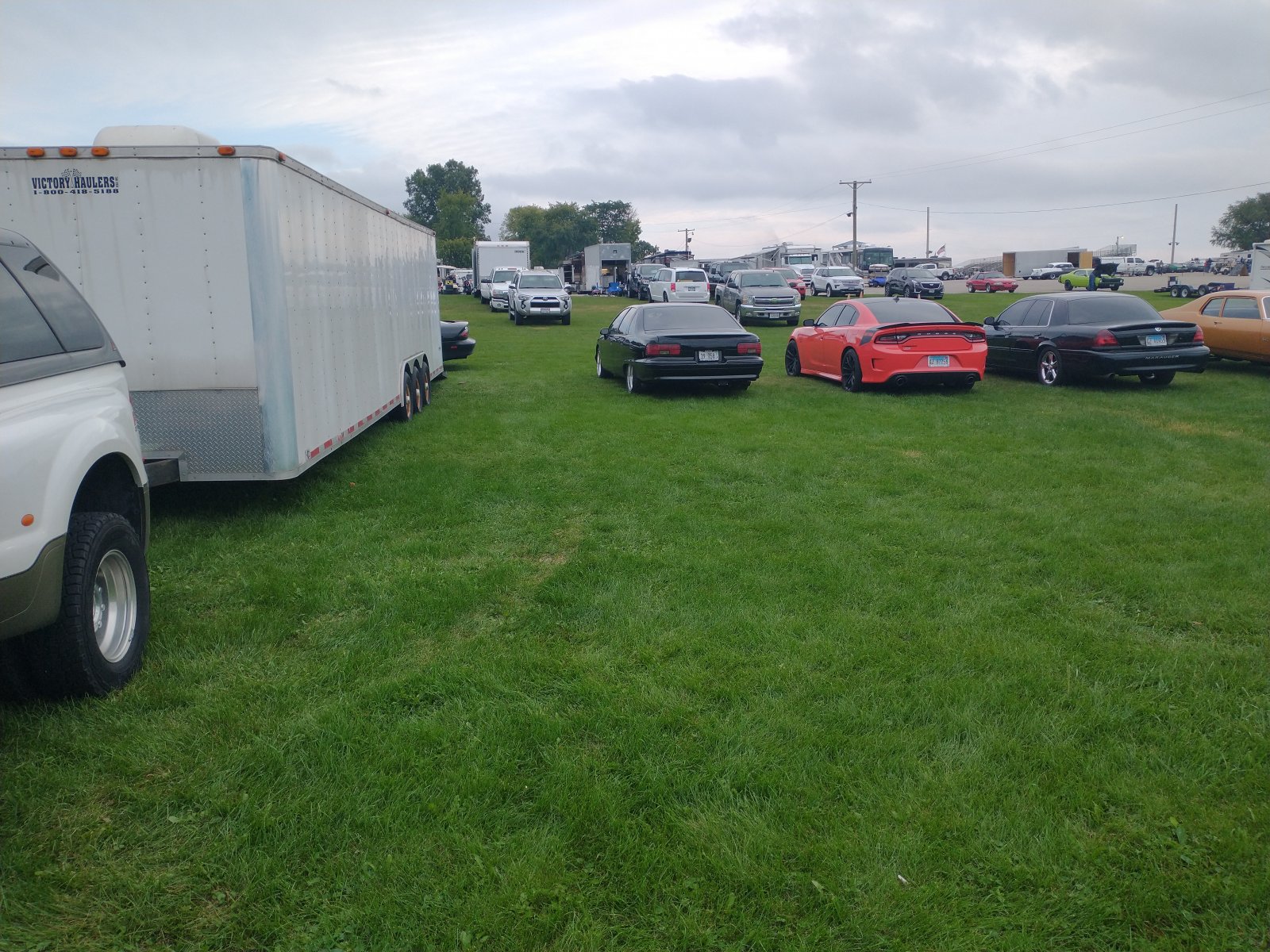

Some pics.

I think the exhaust is holding me back quite a bit. I have the suitcase + the stock resonator, which reduces the pipe diameter there at the tailpipe.
I'm also a bit skeptical of this intake tube. If you look closely at the pic, you can see how the tube extends really far into the elbow, almost like a kink. The analogy would be like mandrel bent exhaust vs non-mandrel bent. Actually, the rubber elbow itself is kinked like this, so it gets narrow at the bend.

Oh, as far as my buddy with the Marauder...
I honestly think he was nervous about losing to an SUV, and he wanted to see what I ran. His Marauder is stock, so it's surely somewhere in the mid-high 14s.
He brought his 92 Caprice, which runs high 10s, but he had street tires on it, so he was really just messing around.
The same friend also has a TBSS, a lifted Duramax truck, an old GTO, and a WRX hatch.
Byron, correct.
Again, my shift points are too high for my setup. There is a couple hundred RPM of "not much" at the top of each gear.
One thing I should add is that my times were shockingly consistent. I mean, all the way down the time slip, the numbers were basically the same on every pass.
I wouldn't focus so much on that reduced diameter at the very back. This is by design. By the time the exhaust has made it through the cats, muffler and all the piping, it has cooled considerably. The smaller diameter pipe after the muffler helps to maintain the speed of the exhaust gases to maintain evacuation.
Until you're moving considerably more air (FI, boost or cam), I'd throw a straight-through muffler on it and let 'er rip.
The MIT does flare out then tapers back to the size of the TB inlet. So, maybe there is something to be said for that versus the tube you have. Running consistent times and being a quick swap, you could put the stock duct or another tube back in between runs and see if there's any notable difference. FWIW, the MIT was shown to yield around 6-8 HP on the top end. Likely nothing you'd notice.

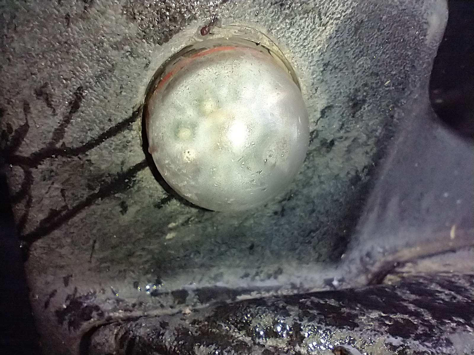

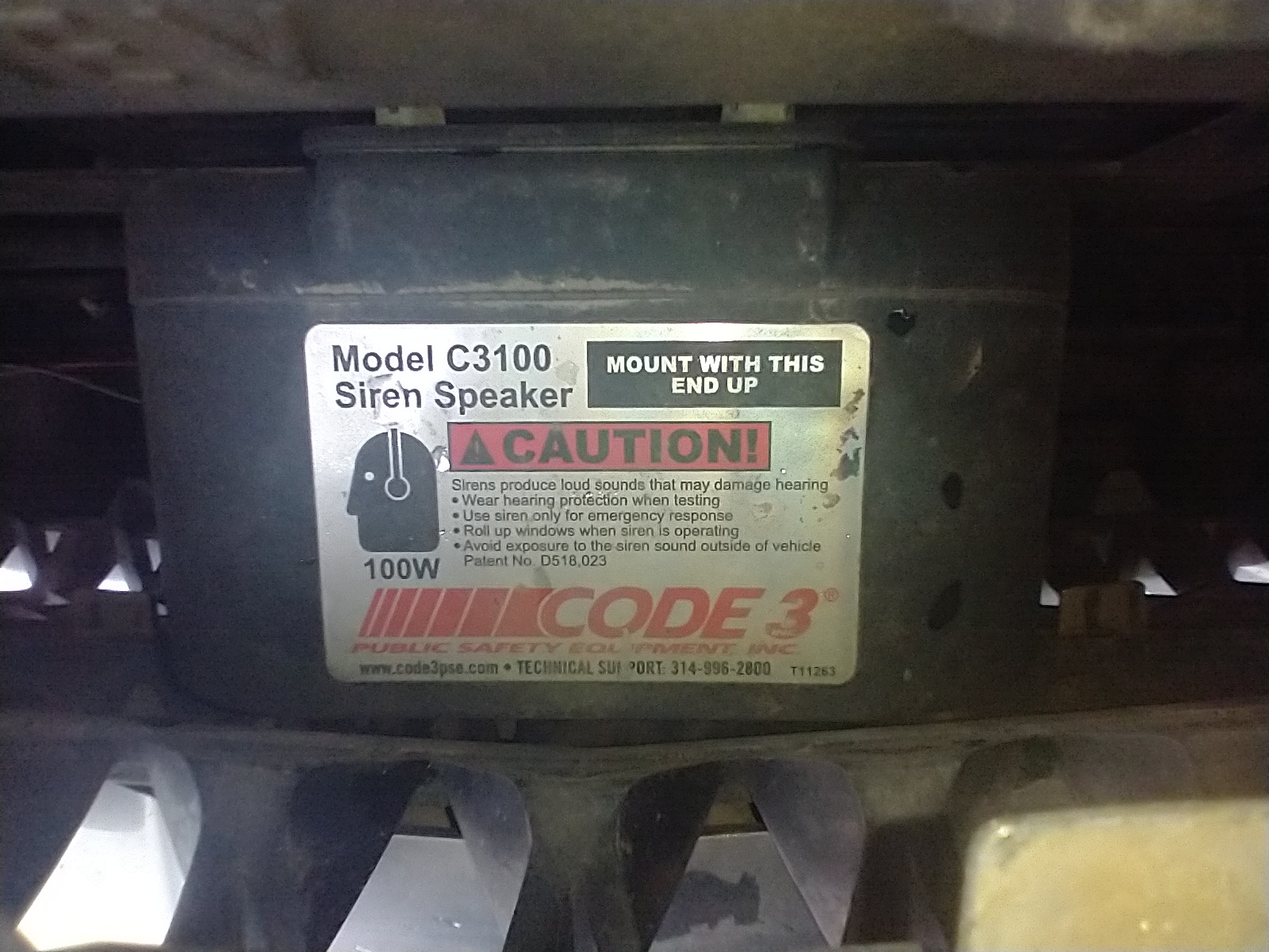

Here are the siren and lights that are still present.
