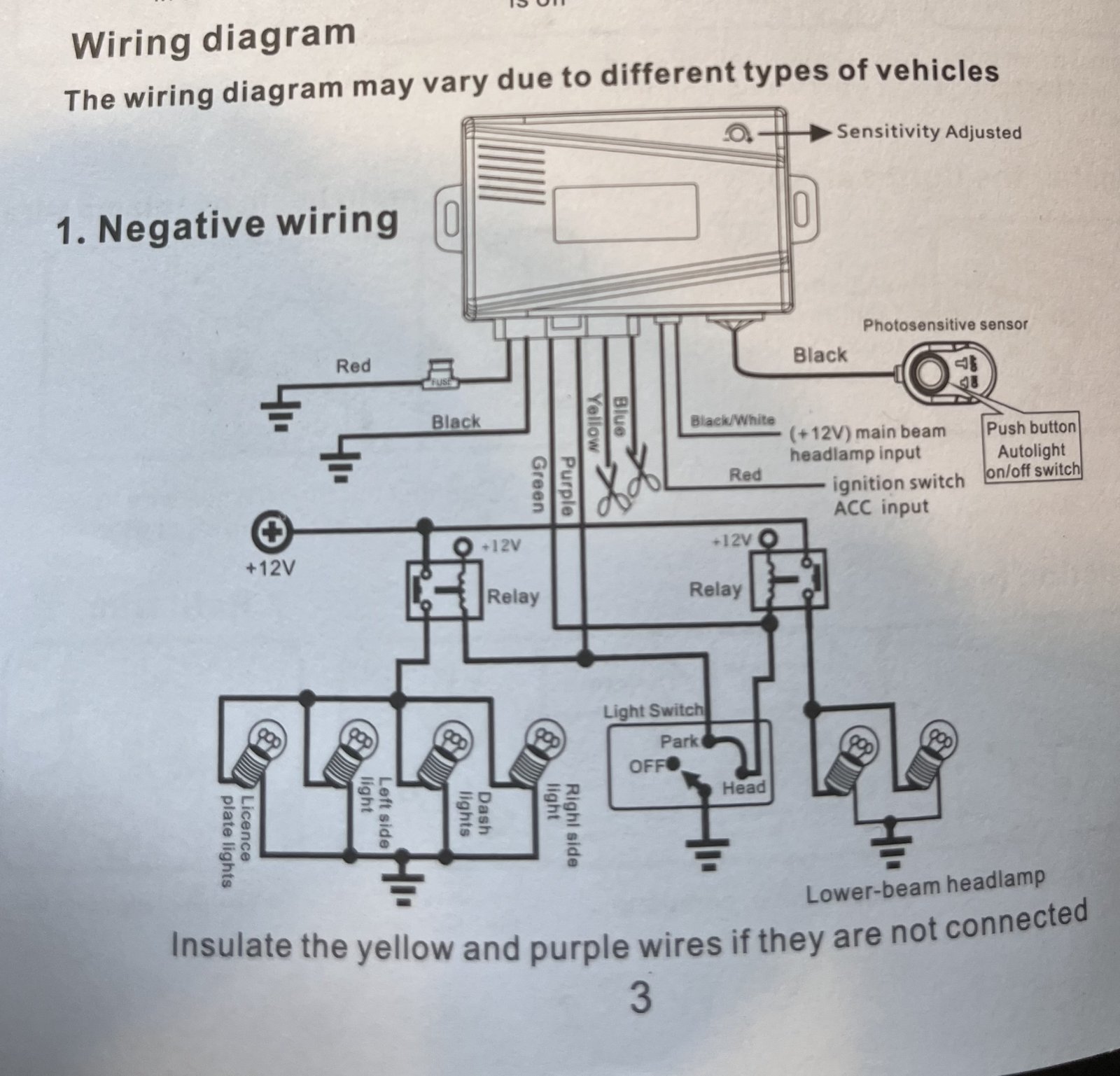

In dark mode our Tahoes headlights switch rest at “auto”. But it does not function as it should. So with wiring this module in it will work and appear as it does from the factory.
These modules have multiple ways of wiring. I chose negative trigger so I could wire it right behind the headlight switch.
Tie in the parking light trigger to green/gray at the switch.
Tie in the headlights trigger to the yellow/purple at the switch.
Tie in the module headlight input signal to chassis ground.
Wire up the rest of the module as specified in the instructions.
Run the photo sensor to an inconspicuous location.
Tuck it away behind the dash and forget its even there. $30 is much cheaper that $500+

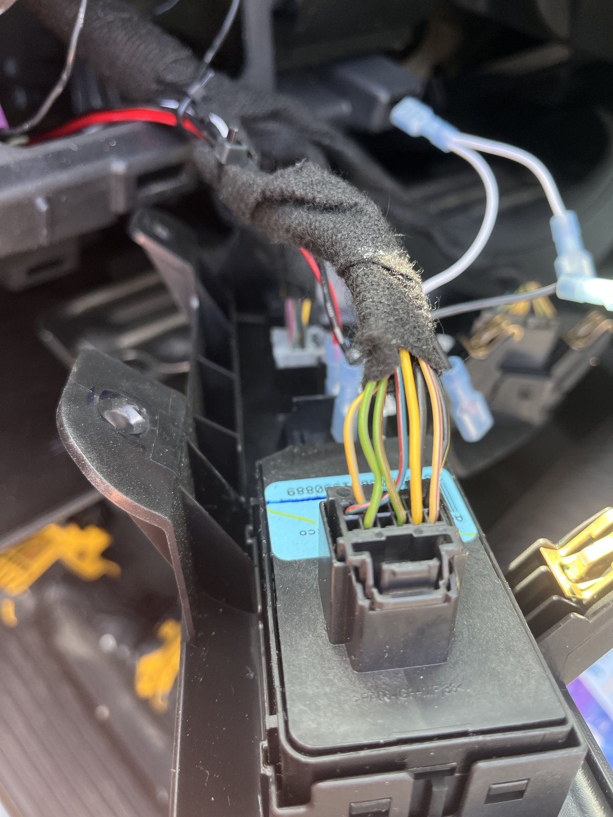

I’m working on the rear windows don’t work from the back switches fix now. I need BCM wire schematics and rear Switch wire schematics if anybody has access.
