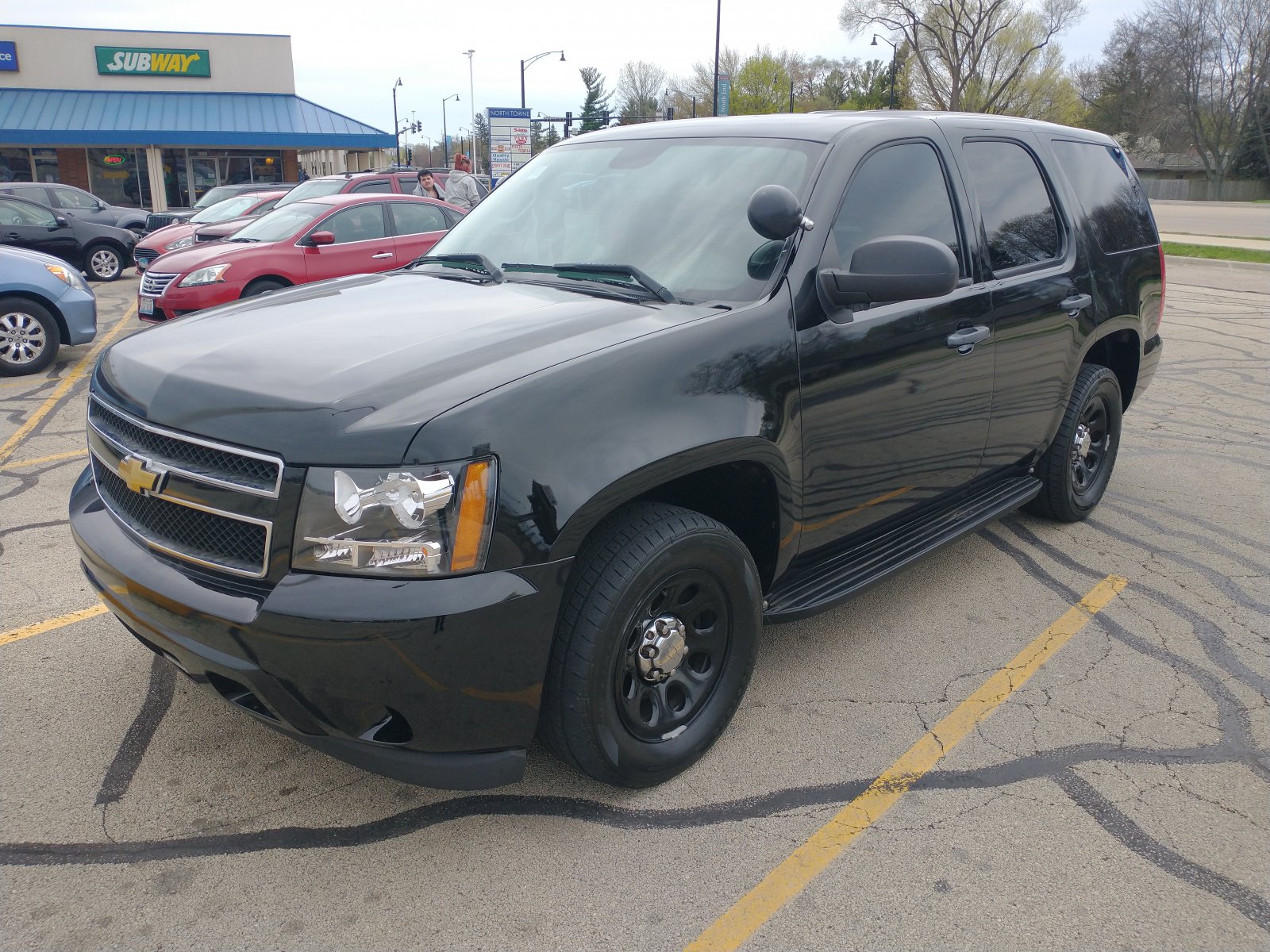

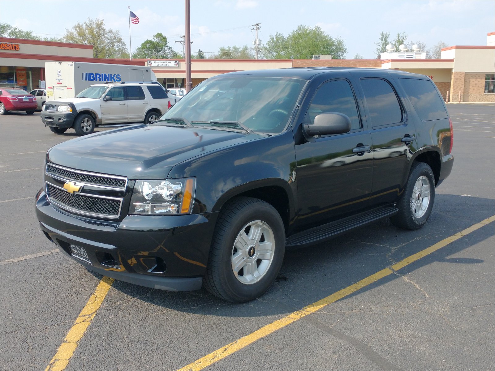

Let's sift through every square inch of a 2013 Tahoe PPV
Caddylack
May 12, 2022
236
215
Hello!
After several years of intense wanting, I finally have an LS-powered truck to play with.
I am really big on stuff that is heavy duty, bare-bones, function over form, etc. As such, police cars are right up my alley. I honestly wish all my cars had rubber floors.
I currently live in northern Illinois, and trucks in this region are generally only used for towing, hauling kids, or driving in the snow. I bought one that does none of these things. This 2013 Tahoe is RWD, has a fully caged rear, and has the stiffest suspension of any vehicle I've ever driven. For me, this is all fine. I have a 95 Fleetwood Brougham that tows 7000 lbs in stock form, and mine isn't stock. I also have a biturbo Audi that I would feel comfortable driving through about 4 feet of snow. Oh, and I hope I never have kids.
For anyone looking to buy a solid police car, I highly recommend Chicago Motors, with whom I have no professional affiliation. Over the years I have had several friends buy cars from them, namely Caprice PPVs, and all have spoken highly. A lot of the used police cars on the market are beat up and neglected, either because they were retired at the end of their lifespan, or because they have already had other private owners. Chicago Motors is known for only selling solid cars that are ready to drive home in.
Most of the Tahoe PPVs that they had in stock at the time were white, and many of them are from Illinois and the surrounding area. Eventually I came across a black one with 108k miles, and the Carfax showed that it had been owned by the same police department in ARIZONA from the time it was new until late 2021 when it was retired from service and sold at auction. I just knew I had to have it.
They were asking $13,750, and I bought it for $13,250 before TTL. My friends have had luck negotiating for over $1000 off of the asking price in the past, but obviously the market is very different now, and most cars aren't from Arizona. I feel like I got a great deal.
I was ecstatic when I found that basically every part on the entire car is new, not to mention there is zero rust anywhere. I still plan to call the department that owned it, to see if I can get any records. Every part on the car has colored-coded paint markings on it, which I would guess refer to "when" the part was replaced, either as far as time or mileage. I will find out.
Oh, side note: Buying a government vehicle from Arizona is typically a pretty safe bet that your A/C system will be in great shape.
For right now, this Tahoe will mostly just serve as a daily driver that I leave alone. I am doing some minor audio upgrades, and I'm planning on a Black Bear tune and some exhaust work. I already added a dry air filter from AEM. Eventually, I will be doing the AFM delete with an aftermarket cam and torque converter. I will also definitely be upgrading to 3.42 or 3.73 gears, as 3.08s just won't cut it for me.

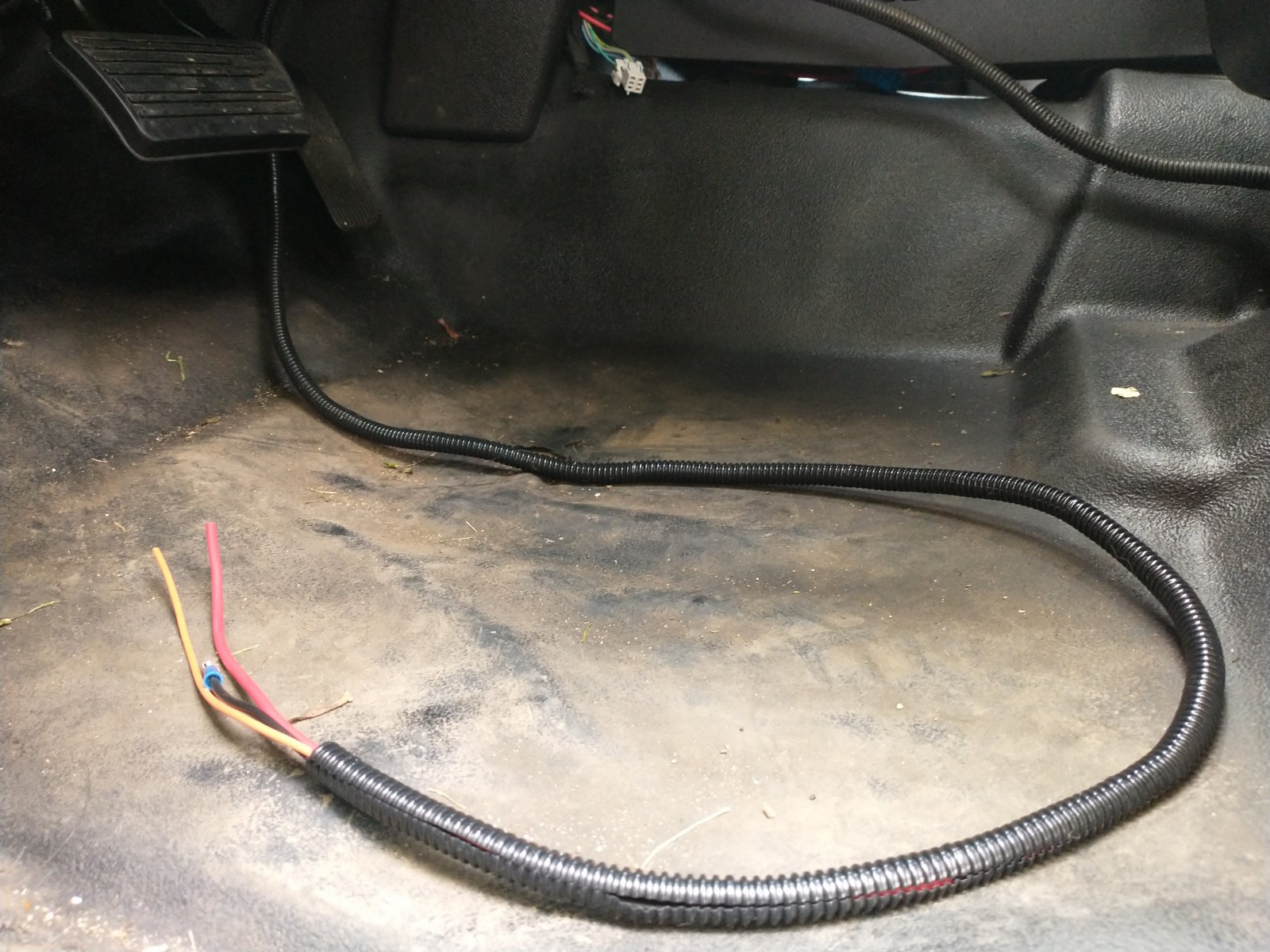

Okay, a bit about wiring and stuff:
I traced and removed as much as I could from the passenger compartment. There was a bunch of extra wire running front to back for various flashers.
One of the large positive/negative leads looks like it probably went to a light bar on the roof. I traced it up the passenger A-pillar to the headliner. I'm not going to remove the headliner right now, so I just coiled this up and hung it beneath the dash. I did the same with an insulated bundle of wires that appears to be a standardized bundle of flasher and data wires for various electronics.
There is also a smaller run of wires underneath the rubber flooring that runs up under the dash all the way to the front of the vehicle. This includes more flasher wiring, as well as speaker wires for a front speaker setup. If I understand correctly, this is factory.
The real meat and potatoes, for me, was the large coil of blunt-cut wires sitting on top of the trans hump, under the instrument panel. Most notably, this contains a 10 gauge red wire that is hot at all times. While this power wire in my Tahoe is indeed hot at all times, the yellow switched 12v lead is not hot at any time. I assume this wire just got cut somewhere and I haven't yet discovered it.
I used this red 10 gauge wire to power my amp, and I'm regretting that decision. The reason I did it was that it just seemed so neat and tidy with the wires already being run to the center console. The issue now is that I am experiencing a little bit of interference (I can rev my stereo when the music is off). I think the only way to troubleshoot this will be to start over from scratch and try to keep the wires separate.
I taped up the large coil of wires, minus the power lead, with high-quality heat-proof wiring harness tape:
I've added wires for power, ground, and RAP running to the upfitter box in regular flexible conduit:
BTW: If anybody wants any of the extra police crap, let me know. I've got a few flasher modules, a siren, and then all sorts of wiring. Oh, and the wheels/tires. I will probably keep the spotlight to re-purpose it, unless someone makes me a really good offer.
Soon I will post a wiring "chart" for this Pioneer amp. Considering the price of a quality new amp, I really like the idea of re-purposing quality factory amps. It's not something I would recommend for serious subs, but I think that the combination of a premium factory amp and aftermarket coaxial or component speakers will sound plenty good for everyone outside of hardcore audiophiles. For my Fleetwood, I pulled a 360w Infinity amp from a 300M that has 9 output channels. You do have to be careful about matching OHM ratings, but that isn't a big deal to me.
