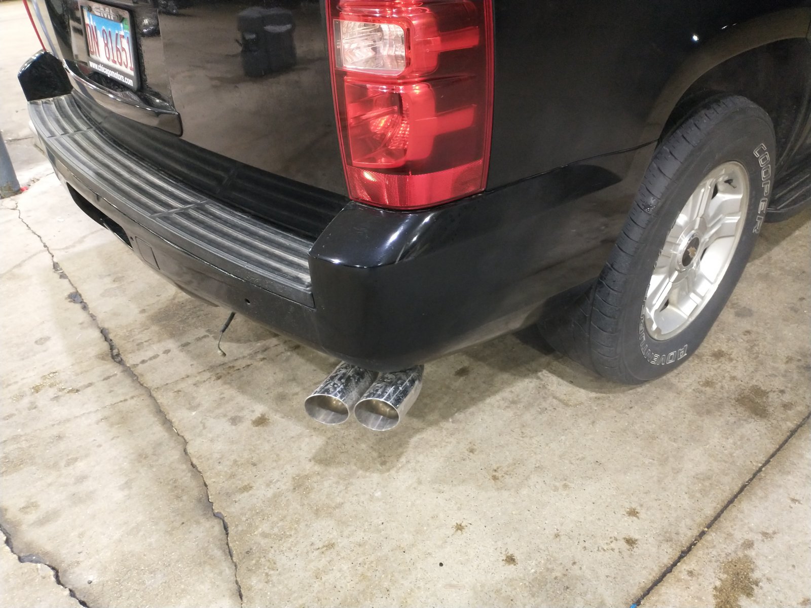

Well, I finally did my exhaust.
I went with a Cherry Bomb "Salute" muffler, and a 2.75" to dual 3.5" polished tip.
The muffler is not one that I'm familiar with, but it seemed fitting for my application. It's 2.75" in/out, straight through with the correct offset, and it's 409 stainless. For under $40, why not?
I'm very happy with the sound. It's much quieter than expected, but that's perfect for a daily. I left the factory resonator, because I was concerned about potential drone. At idle, it sounds basically stock. At WOT, it reminds me of an old muscle car. Zero drone.
Oh, about that resonator. It meant enough to me that I compromised on the location of the tip. The shop initially told me that the resonator would have to be removed, because the tip would stick out too far. I told them to just cut off as much tailpipe as they could and try to make it work. It looks a little bit awkward, but I am okay with it for now.

Had to look up that "Salute" line. Never heard of it. It's the same construction as the AP Xlerator that is a "Magnaflow Clone". AP's part numbers are very similar to Magnaflow and I see Cherry Bomb's part numbers are similar to AP's. I have the AP Xlerator XS1259: 18" body length, 4"x9" oval body dimensions, 3" center and offset connections, 409 stainless, wool and fiber packed around a perforated core, etc. The Cherry Bomb SA1259 is identical. I'm sure they're all from the same factory. Do you know the body length of the one you got?
Also, have no fears of losing the resonator. You won't notice anything. And that muffler will sound better over the next thousand miles or so. I had the same impression- stock-ish at idle, mild rumble during normal driving and wild growl at WOT/high RPM. Drop your right rear window and floor it next time you're next to a concrete retaining wall.

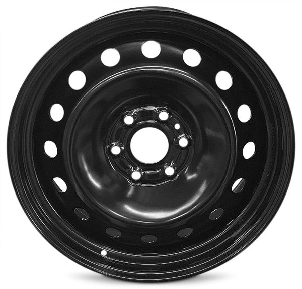

More on wheels:
The current generation PPV has 20" stock police wheels. I'm sure they aren't cheap or easy to find, though.
The Nissan Armada, which shares our bolt pattern, came with a 20" spare. I can get these from the junkyard for nothing, but it will require some patience.
I wouldn't mind running staggered 20s and 22s, if it happened to be convenient. Maybe 2 transport wheels and 2 Armada spares.

What do the Armada spares look like? Newer or older models?
Black steelies.
I don't think the year matters, but you just have to verify 18" vs 20", since those were the two sizes Nissan used for the spares.

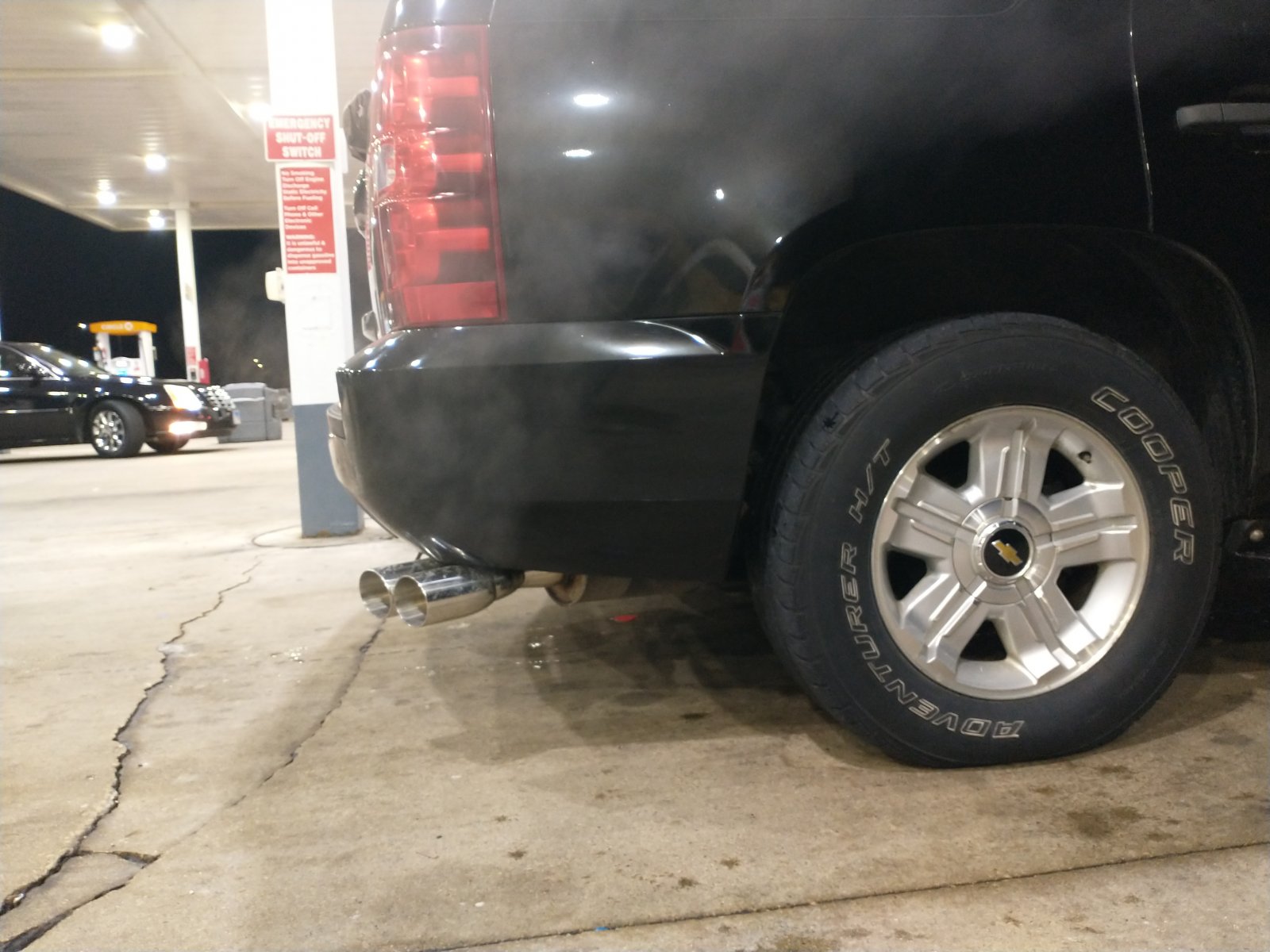

However, if you ever lose your cats, just know it'll be LOUD. I learned that the hard way.
Really? I have been planning to delete them, but I have assumed the difference in volume would be minor.
45,012
This is what I was hoping for, with the 15-20 being shorter.
Although, there still isn't a solution for lowering the rear besides lowering springs.
The newer strut is about 5/8" shorter. But, with your original spring on that newer strut, it'll compress a lot more than 5/8" once assembled, installed and with the vehicle weight on it. So, that 5/8" difference means nothing. The strut's overall length is shorter, but the vehicle rests on the top of the spring (via the top plate/hat) and the spring rests on the perch. So the perch height from the lower control arm is what will determine the difference, if any.
45,012
I learned that cats are very effective mufflers. I don't mind "loud" and thought that 18" muffler with an otherwise stock exhaust was perfect. Cruising on the highway, it was just a faint rumble that was easily lost to casual conversation or having the radio on. It was "loud" only when accelerating under load and high RPM- perfect, IMO. With no cats, it was obnoxiously loud. Have you seen what I've had to do to get my exhaust back to those tolerable noise levels? My ish starts here: https://www.tahoeyukonforum.com/threads/growing-up-doesnt-have-to-suck.93510/post-1462346
And here:
https://www.tahoeyukonforum.com/threads/growing-up-doesnt-have-to-suck.93510/post-1485205
The catless noise is one thing, the smell is a whole other tangent.
