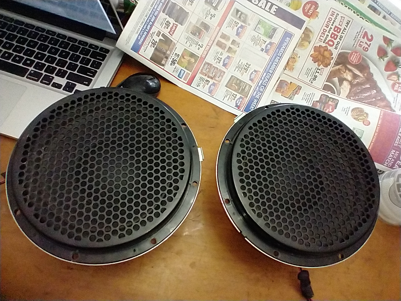

Coming up now are some pics of the amps and subs that I currently have sitting here...

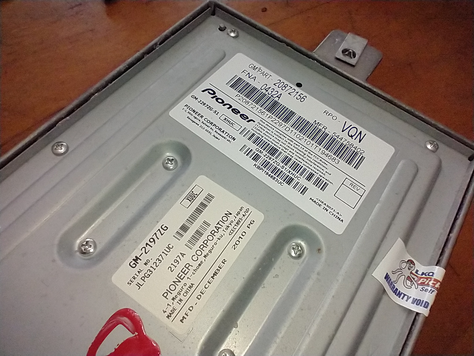

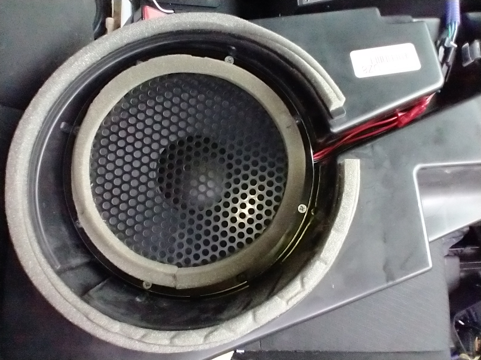

MAN... I may have screwed up even more than I thought in the amp category...
The sub enclosure that I pulled from a GMC Terrain says "UZ8" on it, which I believed to be the RPO for the premium Pioneer system. I checked the amp under the dash, and it clearly says "Pioneer". That was enough for me to decide that I was dealing with the "premium" Pioneer system. Apparently, I was wrong.
Pictured below is the Terrain amp, which is likely the base amp with a noise-cancelling sub. In addition, I think I must have mixed up two different amps when I made the comment about 380w. I think the premium amp in the Terrain is rated at 250w, with 150w dedicated to the sub. DOH. There must be another factory Pioneer amp that puts out more power. For some reason the model number 5300 is stuck in my head.

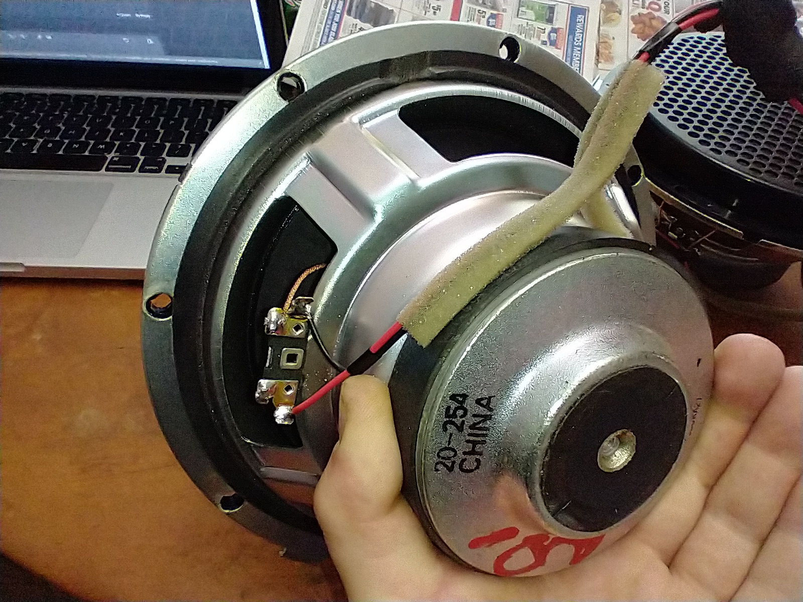

And, pictured below, are a pair of 8" Terrain subs. These are 2.5 ohm, DVC subs. I believe that the subwoofer itself is the same in both premium and base systems, and the only difference is the amp. People upgrade to the "premium" amp to "activate" the sub for music.
Here is a picture of the UZ8 enclosure from the Terrain, with the 8" sub from the Pontiac Torrent in it. Note that I made this switch because I'm using the amp from the Torrent, and the Torrent sub has very minor differences in comparison to the Terrain subs. There are differences in the cone, and the Torrent sub is also listed as 2 ohm.

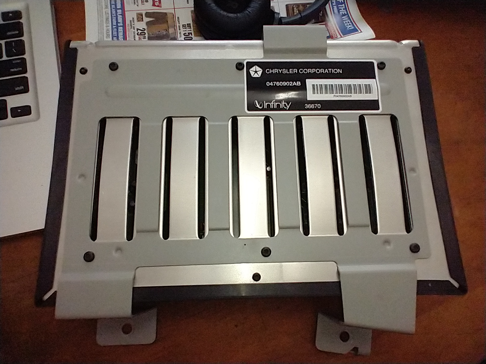

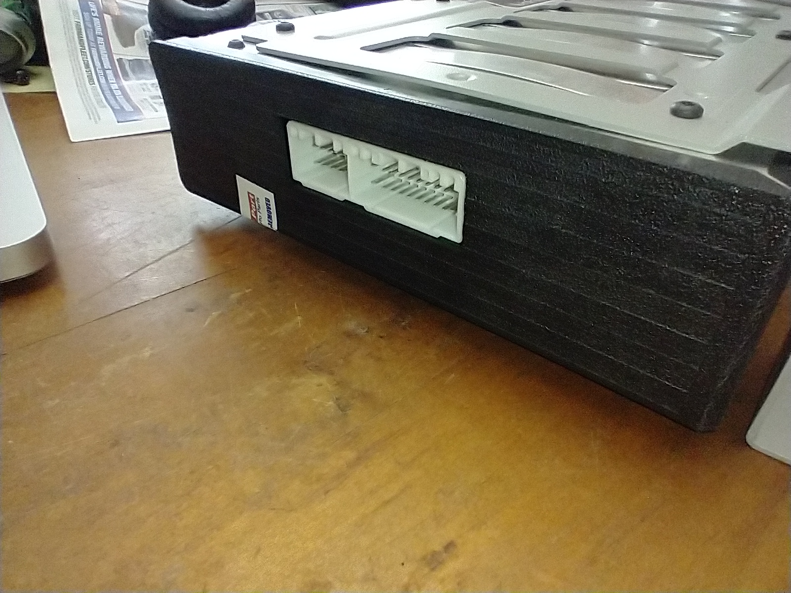

Now, this is the amp that I'm excited about. Mopar guys usually know all about it. It's an Infinity amp from a Chrysler 300M that puts out 360w through 9 output channels. It was notoriously marketed as "11 speakers in 9 locations".
While this is a really nice amp, there are a couple of downsides. For one, the speakers are an assortment of 2 ohm and 4 ohm. Also, the crossovers are built into the amp.
What this means is that you have to be very careful with speaker selection. Overall, I think it seems like a really good move if you want a fairly elaborate stereo setup with many speakers. This amp does not do subs at all, so you will need an additional amp if you wish to run subs.
This amp was intended for my Fleetwood project, but now I'm wondering if it makes more sense to use it in the Tahoe.
Basically, there are 4 low frequency channels for mid-bass rated at 2 ohm, and 5 mid-range channels rated at 4 ohm. The two front mid-range channels have tweeters wired in parallel. The 5th mid-range channel is a "center" speaker. Whenever I do set up this amp, I am planning something like this:
4x 6.5" aftermarket coaxials, 4 ohm
2x Bose tweeters, 4 ohm
2x Bose 6x9", 2 ohm (midbass)
2x 8" DVC Pioneer subs, 2.5 ohm (midbass)
1x random 6.5" center speaker, 4 ohm

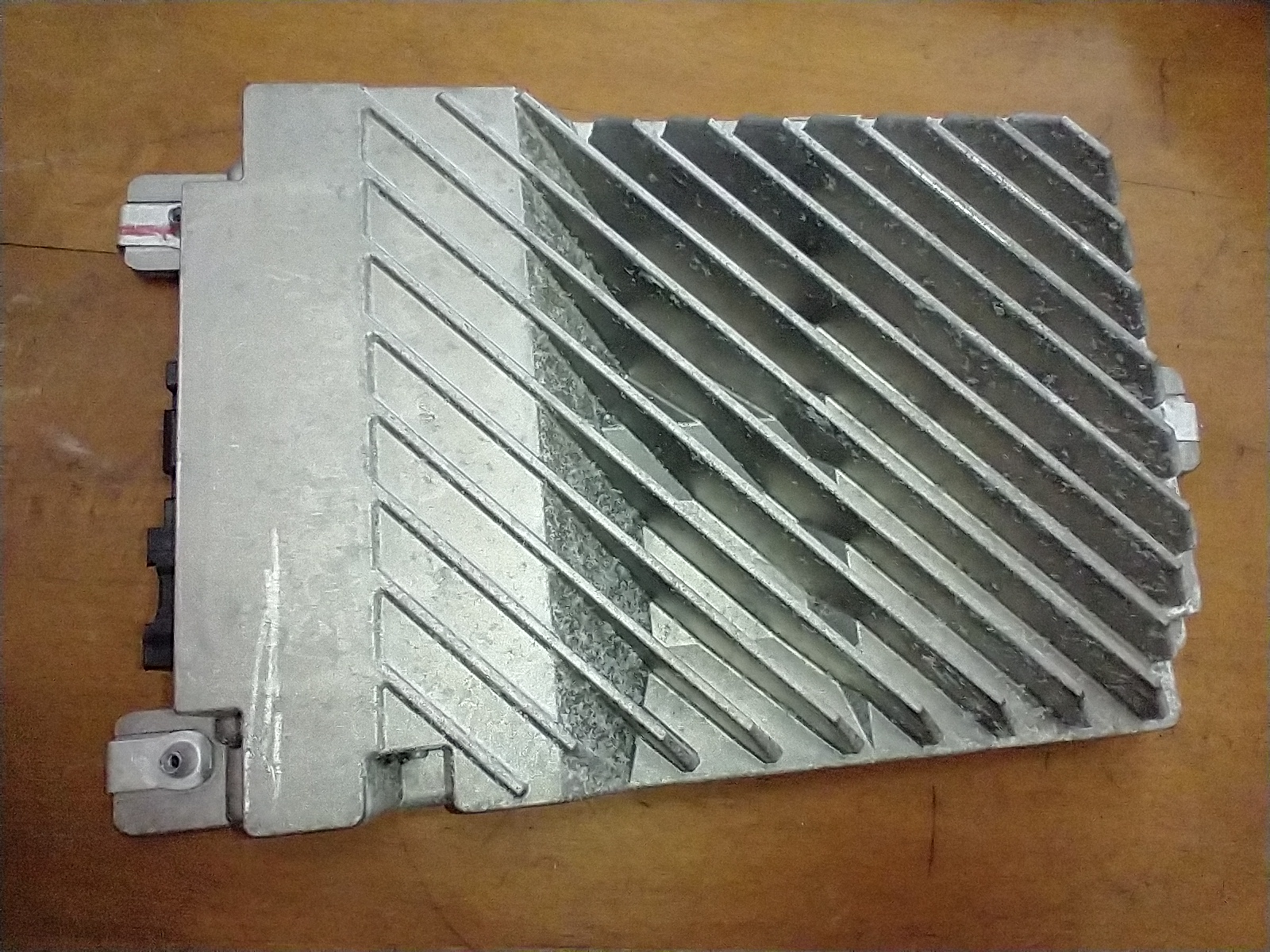

More thoughts on these "non-Pioneer" amps that are clearly made by Pioneer:
One of the biggest issues with repurposing premium factory amps is that the ohm ratings are often atypical. Bose uses a lot of 2 ohm speakers, and I know that there are 3 ohm Pioneer speakers in the Terrain. Most car speakers, of course, are 4 ohm.
From what I've gathered, the base stereo speakers in both the Pontiac Torrent and GMC Terrain are 4 ohm.
So, what do I have here? Without the ANC sub channels, it seems I have a pair of 4-channel amps that are each incredibly ideal for driving two pairs of aftermarket coaxial speakers. I believe these are full-range amps with no crossovers, so you could really do whatever you want with them.

Now I'm wondering if I should try to use this other Pioneer amp to power the 8" sub from the Torrent. I kinda wanna do it just to see how it works.
Dual 2.5 ohm coils means I can wire it for 5 ohm, yes? 5 is a pretty close number to 4.
Since I'm new here, I should probably make sure that people know this is an attempt at rhetorical humor.
Fair warning: My sense of humor is dry and unfiltered.
But, seriously... I have an 8" sub in an enclosure sitting on the passenger seat, and I would love to power it with household goods.
This just dawned on me:
If you are pulling a sub, it's probably preferable to take one from a non-premium system. These subs would not have had the same potential for abuse.
OOPS... For a second I got my subs mixed up. The Terrain subs are 2.5 ohm, but the Torrent sub is 2 ohm. That should actually work perfectly.
With an amp that likes 4 ohm, a sub with dual 2 ohm voice coils can easily be used by wiring in series.
4 stereo channels bridged to 2, with each channel feeding a voice coil.
