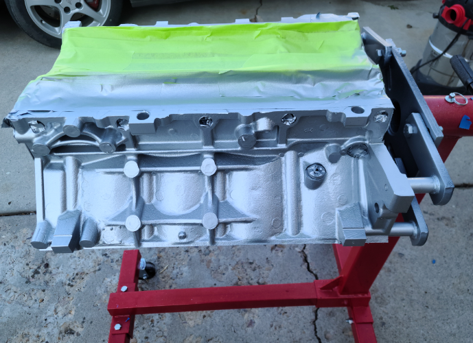

So i decided i wanted to put a coat of engine primer on my new 6.0
then i saw the instructions said "within 10min next coats"
then "within 10min apply color coat"
then "Within 10min apply clear coat"
then "all coats within 1 hr"
Me: ffffffffff
Painted, and mostly cured now..
I think it will look much better once assembled.
