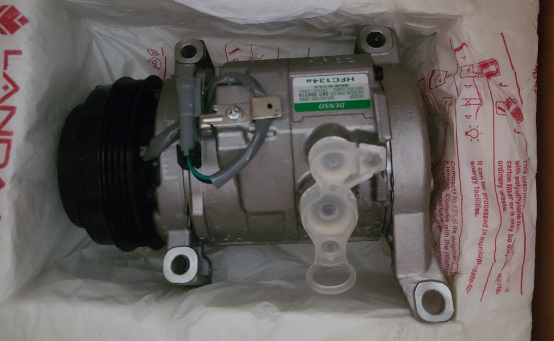

got the new ac compressor.
I saw amazon had a price drop, brought it back down to about $138
so i clicked the button.
Received it over the weekend, looks good.
Came in a nice blue GM sealed box.
Matches the images for the newer model unit per gm partsdirect.
