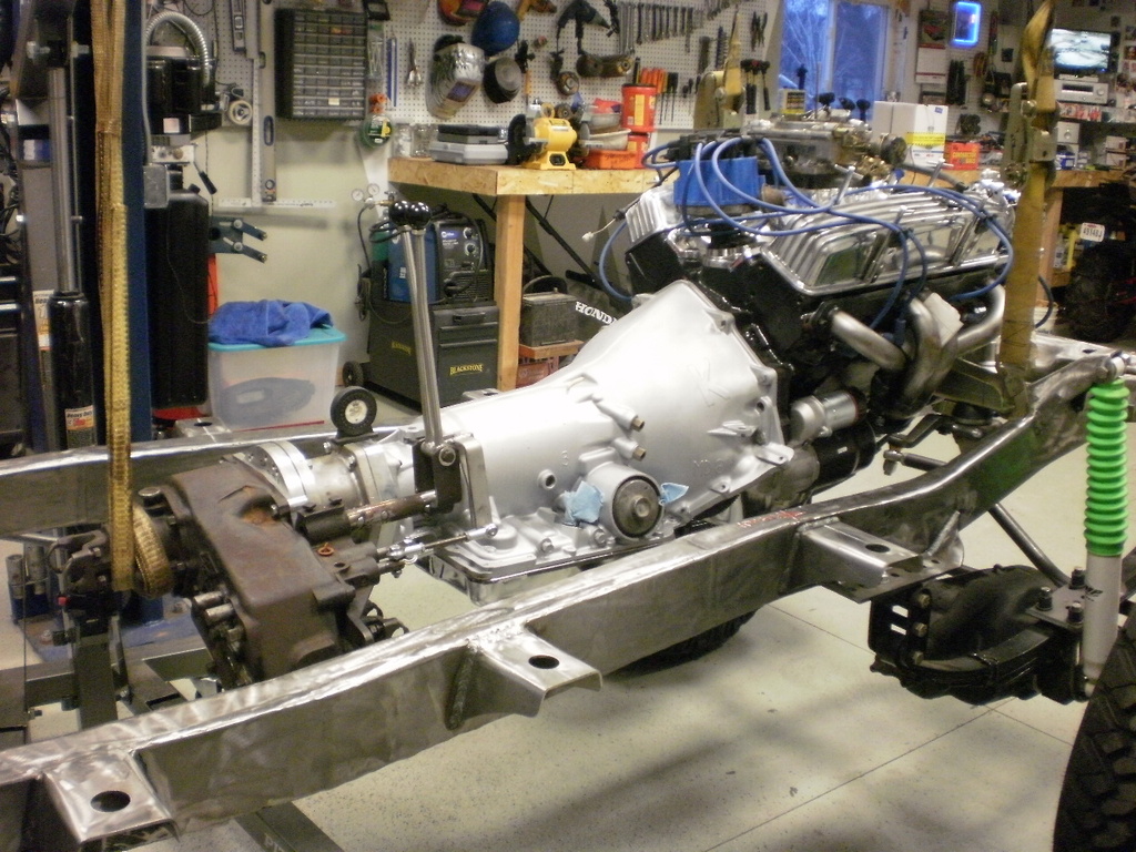

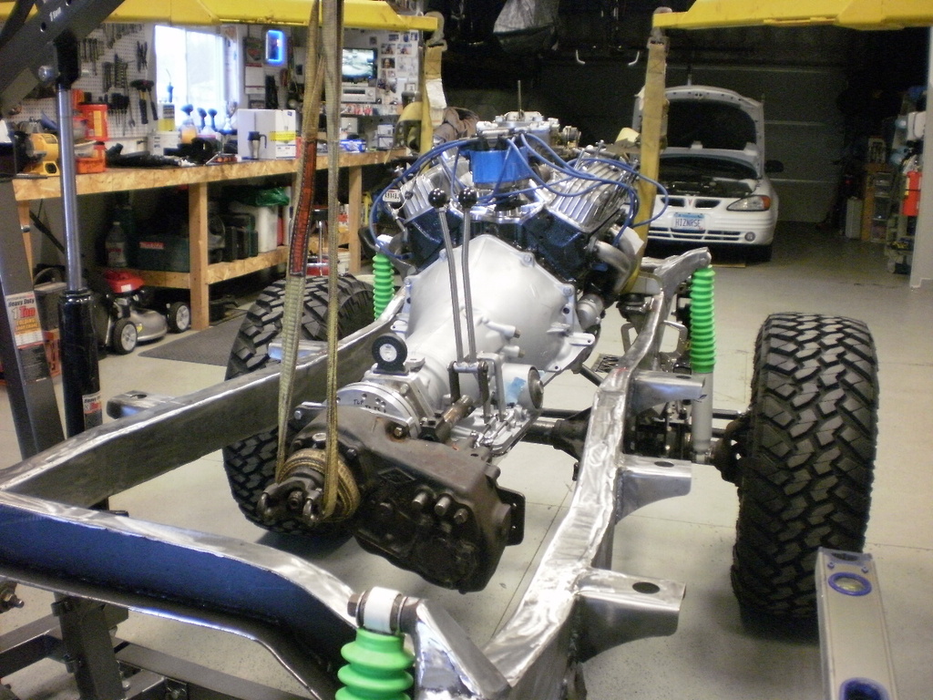

WELDING IN THE MOTOR......
Figured I would get this done today,because Monday,Tuesday and Wednesday are booked up.
Since most of this Install I will be doing myself. I like to use Mr. Hoist. He doesnt complain,***** or whine about doing too much work. He is always there to help...:Big Laugh:

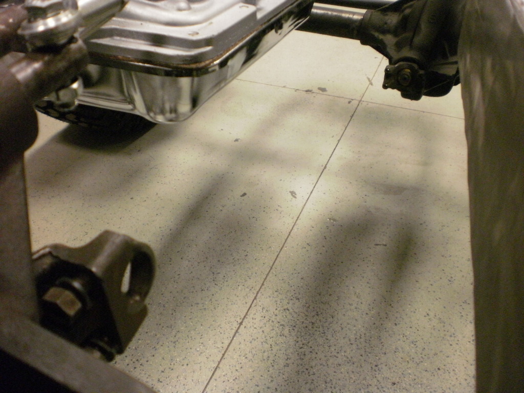

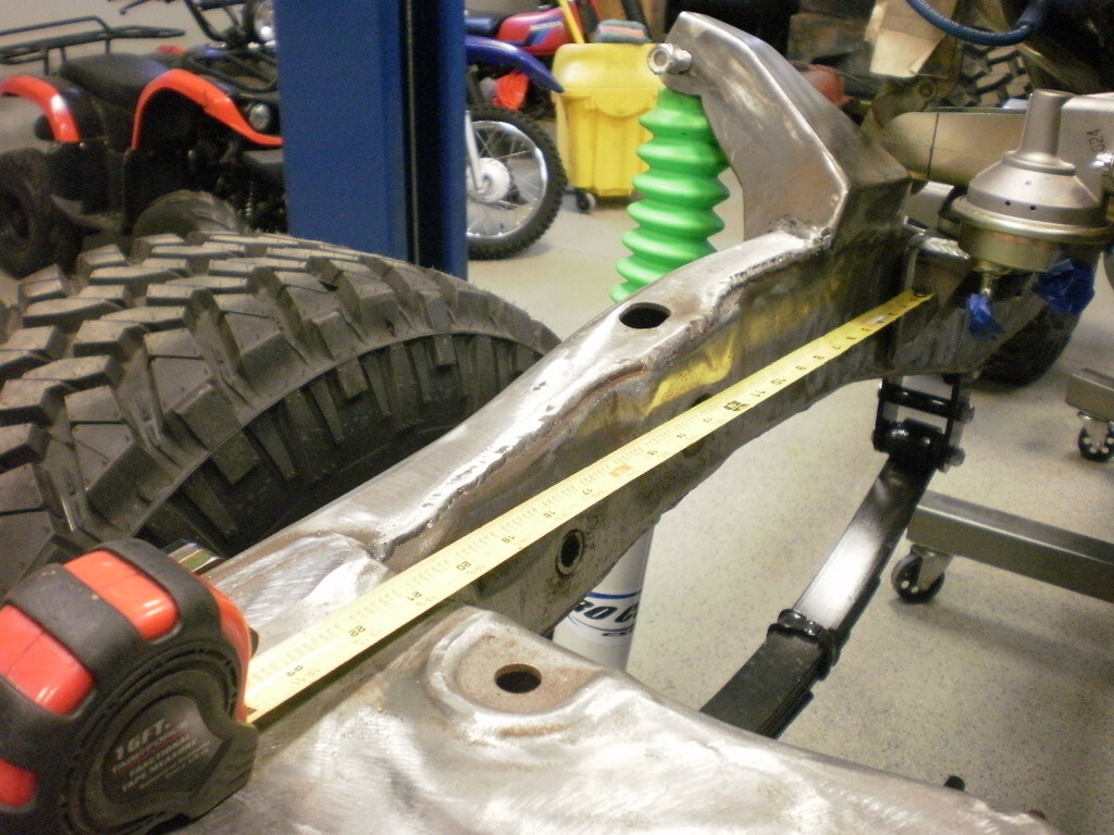

Now the rear driveshaft will be custom built as will be the front. The rear will only be about 19" long with a double cardan joint on each end because of the angle and pitch.
The front will be about 3' long with a double cardan joint and a big slip yoke. Tolerances are critical.
A lot of measuring. You have to figure in radiator,firewall distance for dizzy and bellhousing and so forth.

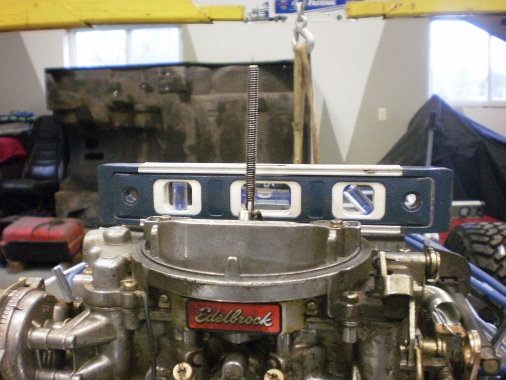

I used this level as a reference, NOT a final determination.
Tranny has to level, motor has to be pitched to the rear at a degree for the TC tailhousing to line up and such an angle so there wont be any significant binding or vibration. I got my sight level out with the red laser and THAT gave me a good reference.
Trans mount and TC skid plate will be built together. I'll take the jeep out to my buddy Jordy's shop. he is a master tube bender and Buggy Builder. The skid plate and mount will be all tubular with some kickass shape.

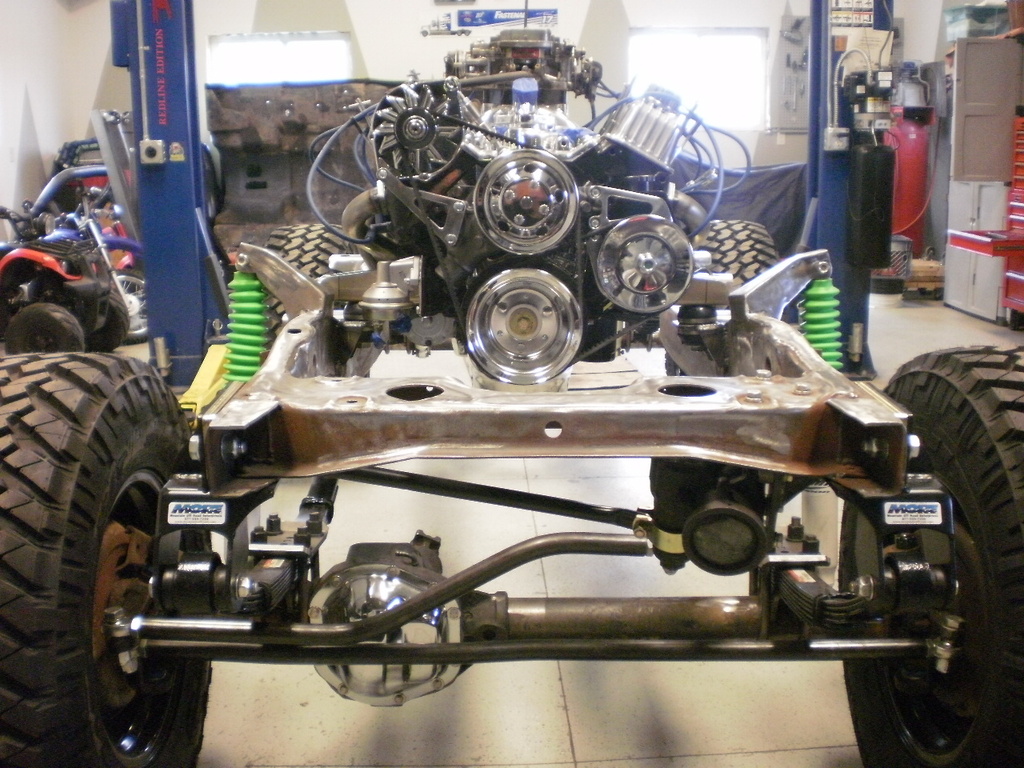

Rear view.
Motor all welded in..
I left out a lot of the technical talk. Everyone does it different.
The Transmission and the T-case are supported by a rod and ratchet strap. Just secure enough for transit. Hope to have all that done next week!
