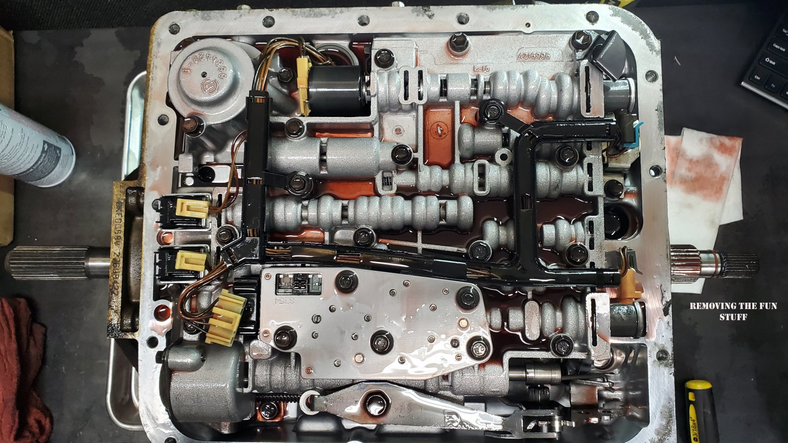

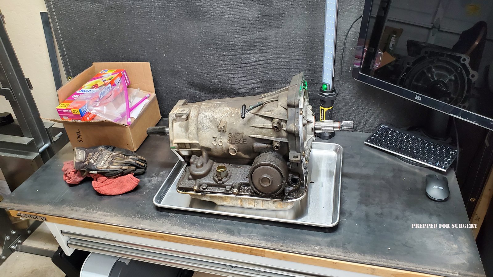

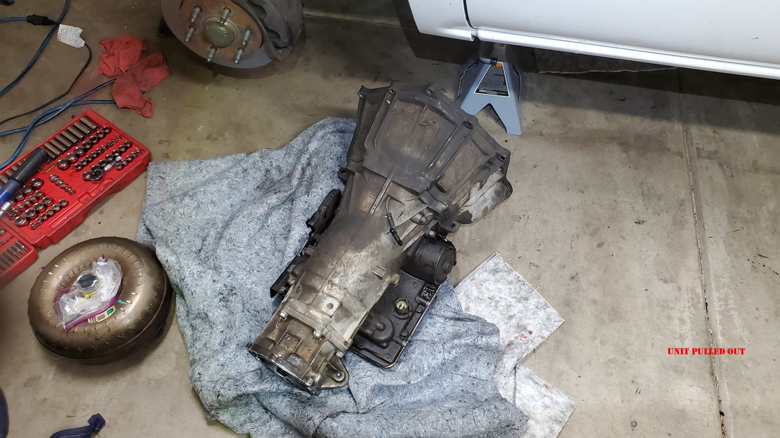

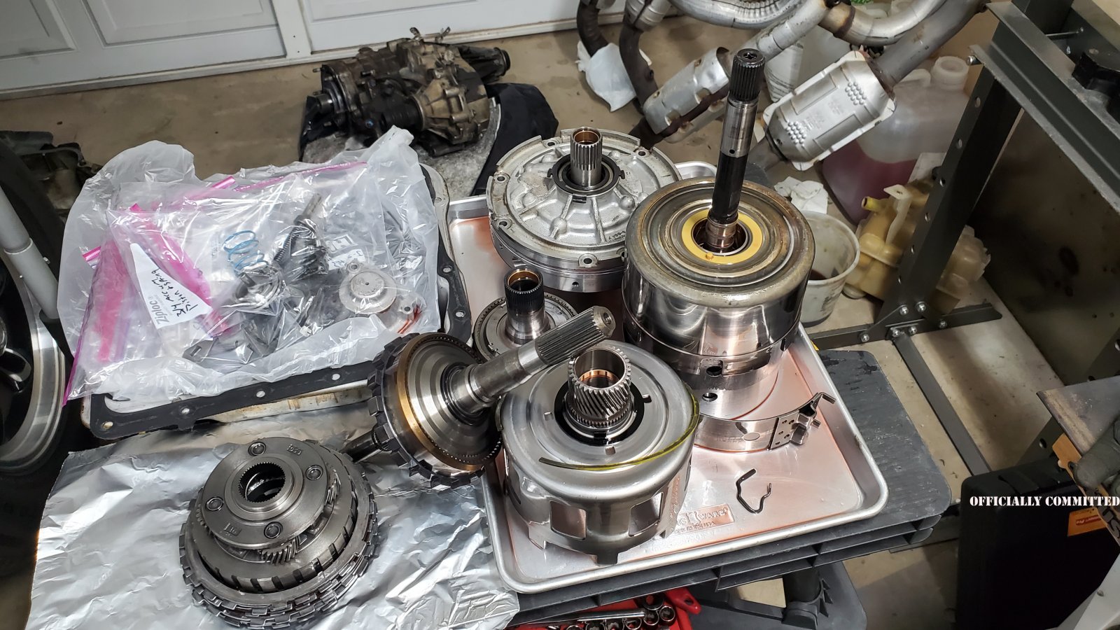

Hey all. A few days ago, I just got done with doing my first transmission rebuild on my 4l60e for my `00 Tahoe 4x4. I have barely 100 miles on her so far and with no issues (knock wood).
I am just giving you a brief description of what I’ve done and hopefully answer some question for any other novice like myself who wish to give this a try. Photos included is not a complete teardown. Just snippets of after the removal it’s guts and the mostly reassembled unit.

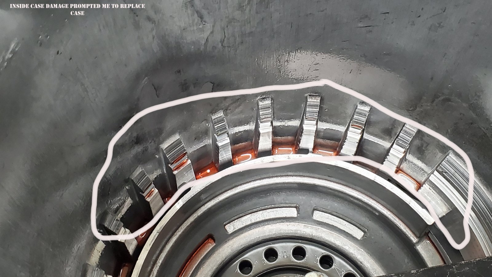

ACDelco transmission case (Rock Auto $348.00) Had no choice on this one. Once I got my tranny apart it was scored pretty bad inside so I opted to replace it.

View attachment 367760View attachment 367761View attachment 367762View attachment 367763View attachment 367764

OP, don't through out your case. From the picture I believe you were worried about the indentations that the lo/reverse steels made. Most likely you can clean that up so that the steels won't catch on an edge and use it or sell it.

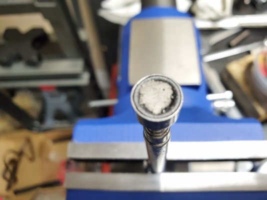

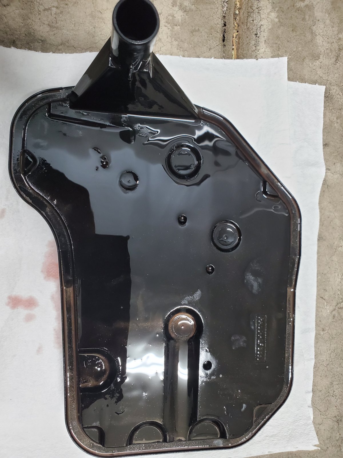

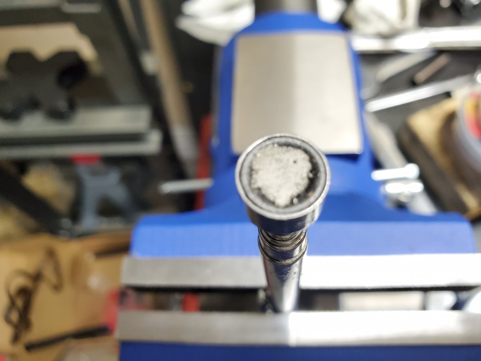

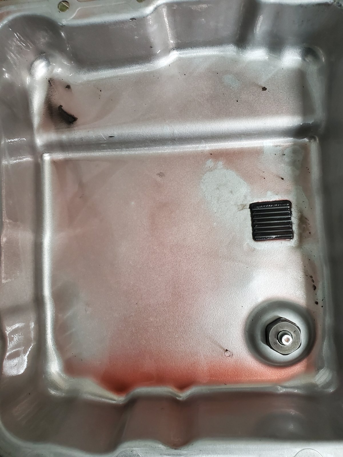

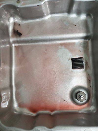

Evening all! once again I apologize for the late reply. Just giving an update. I have clocked 1,111 miles on the new transmission. This evening I drained the pan to see what is going on and how things were looking. I am uploading 3 photos.
1. The transmission pan with just the fluid dumped but the pan not wiped. As you can see the pan is very clean minus the dark marks which is the grease from the magnet. The fluid came out very bright pink with no visible particles. After skimming the pan with a pen magnet (next photo) there is some peach fuzz going on which I expected. The third photo sort of got me on the edge of concerned but again I hope it's due to it being a new build and will clear up by the next fluid change. If you look at the filter's "edge" you will see a noticeable amount of tiny "glitter" particles that have rested on the edge and center. once gain since this is my first build I am not freaking out and hope this is expected until break-in? Also the filter element was not clogged.
Once again fluid is bright pink, no burning smell, still shifting like a champ with no odd behavior. I have to wait for reassembly as my ACDELCO filter had to be ordered. I should have it tomorrow.
