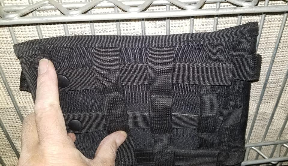

Molle gear can be attach to these shelves too.
You can also put some carpet in there and strap in other items too.. Plus if you use the right carpet Velcro will stick to it also.

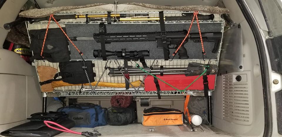

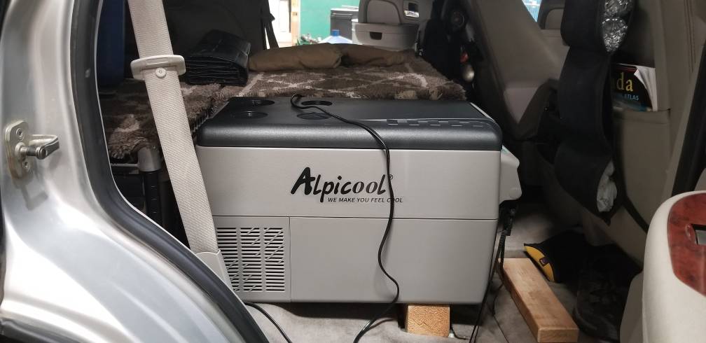

This is with a shorter she;f section in the front allowing room for a refrigerator and the bed still fit on top. With this set up the passenger in the front seat can get to the refrigerator.

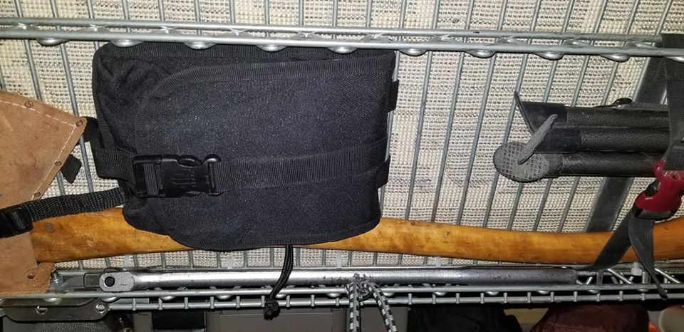

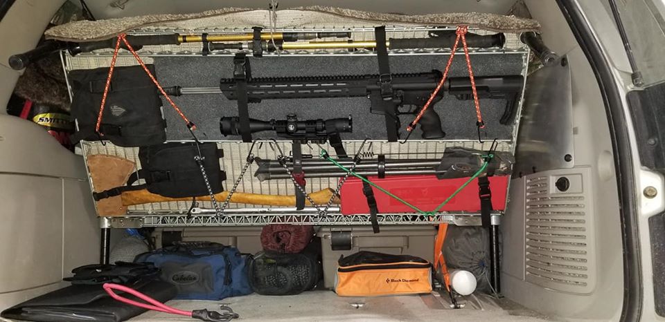

You can store all sorts of things under the shelf. This is the rear section lifted up with a 6.5 Grendel AR-15, Luepold scope, 3 leg chair, safety triangles, hiking poles, magazines and a pistol in the black cases and a small axe and under the mid section are two large MTM ammo crates one with a weeks worth of food (for two people) a stove the other create has a pretty complete tool box in between them is a 30 foot recovery rope,tow down jackets, crampons and snow chains.
With these shelves you can attach any accessories with molle straps. You can see in the following photo they line right up with the shelf.

Only problem I see in this photo is that one of your most effective tools is kept unloaded making the ax the go to weapon if the zombies are danger close! LOL
Four 30 rd mags in those black pouches... Plus I keep a suppressed Sig 226 Legion up front and more accessible. You should see the back of my front seats... lol
