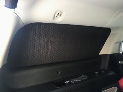

The next thing is cutting the Reflectic insulation or bubble insulation to fit into the window openings.
Place the material in place and cut it so it is about a 1/2 inch bigger all around so you can slide it under the molding to hold it into place.
I cut pieces to fit the rear windows, the rear passenger window and the back window. I actually leave them up most of the time to keep the Nevada temperatures down in the sun.
Note: I am not recommending this practice for everyone because it depends on your driving abilities and if you have a rear back up camera. It also may not be legal in your state so be sure to check that too.
It will lower the inside temps dramatically in the sun and help to regulate the temp when camping too. I also have curtains for the driver and passenger side windows to get privacy and use a front window shade to finish it all out.
BE SURE TO LEAVE YOUR DRIVER WINDOWS OPEN ENOUGH TO GET FRESH AIR WHEN SLEEPING.

I have thought about blacking out the reflective material with thin cloth or maybe just darker tint in the rear windows. Sometime the reflective material will not be flat and you could put something stiffer behind it to flatten things out. If you are only using it for camping I wouldn't worry about it... lol

I covered my reflectix with cheap Walmart quilted fabric. I leave the cargo window panels on all the time so I wanted it to look a bit more finished and invisible from outside.

Thanks I will have check that stuff out, the heat has started to cause mine to wrinkle a little.
