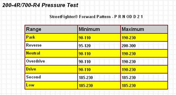

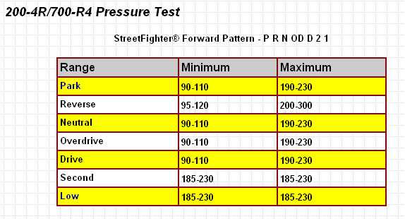

Well a rebuild on the pump and it still rattles so what would you do? Then another pump gets installed and he still hears some noise. So, he's thinking TC. So it comes out again and he's replacing the the TC. I asked him if he put a pressure gauge on it and he said "Uh, no. But we held our finger over the line and felt it pulse." I don't even think he has a pressure gauge.

Umm put his finger over it....
That is a little risky. If the pressure is failed to the high side, that's a great way to get atf pushed through your skin into soft tissue.....

LOL! Fluid at that pressure through a 3/8" diameter line blasting through his finger. Maybe he just held his hand on the line and used his mental powers to "feel" it pulse. I'm wondering what this guy is really doing at this point.
