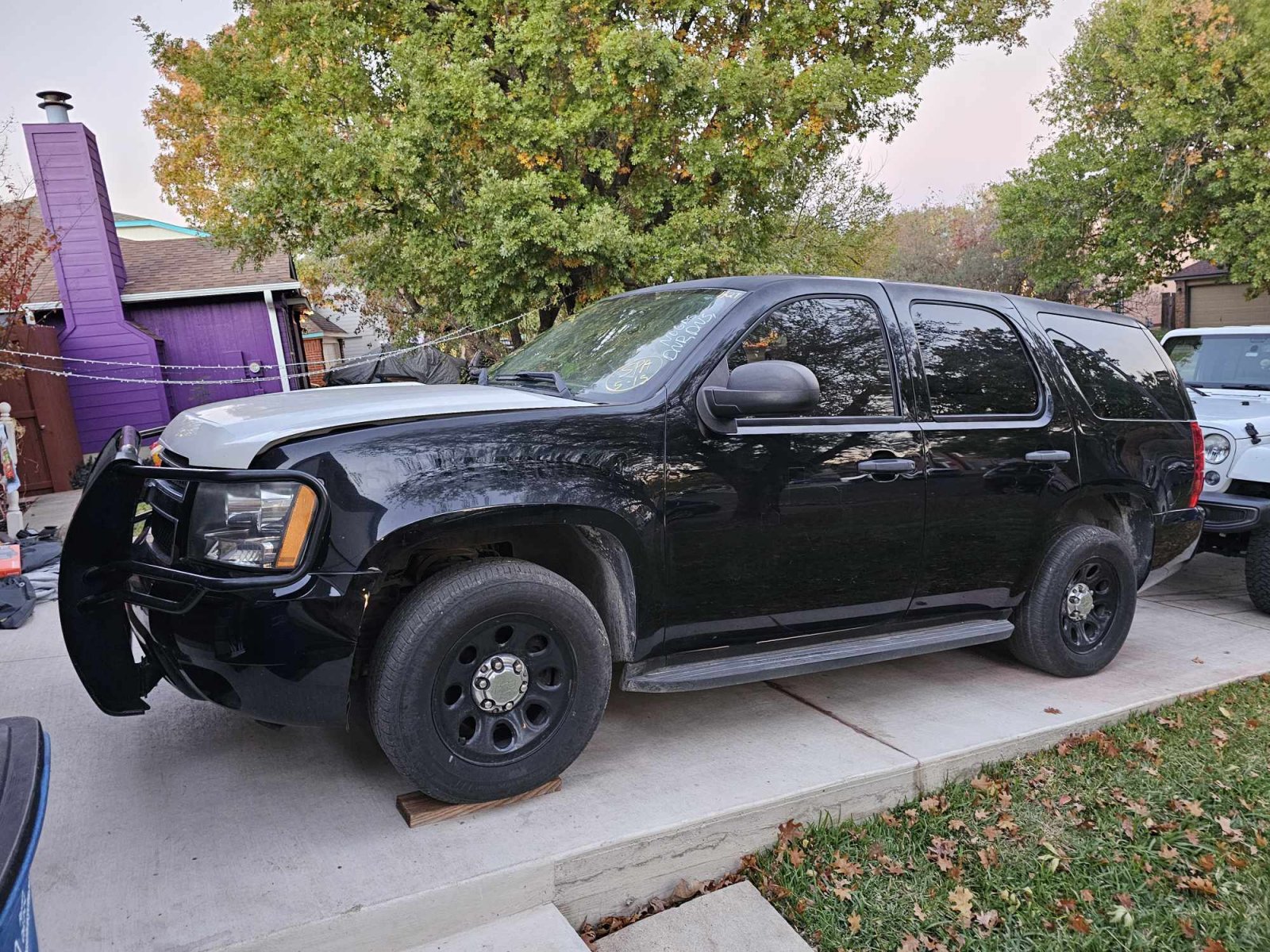

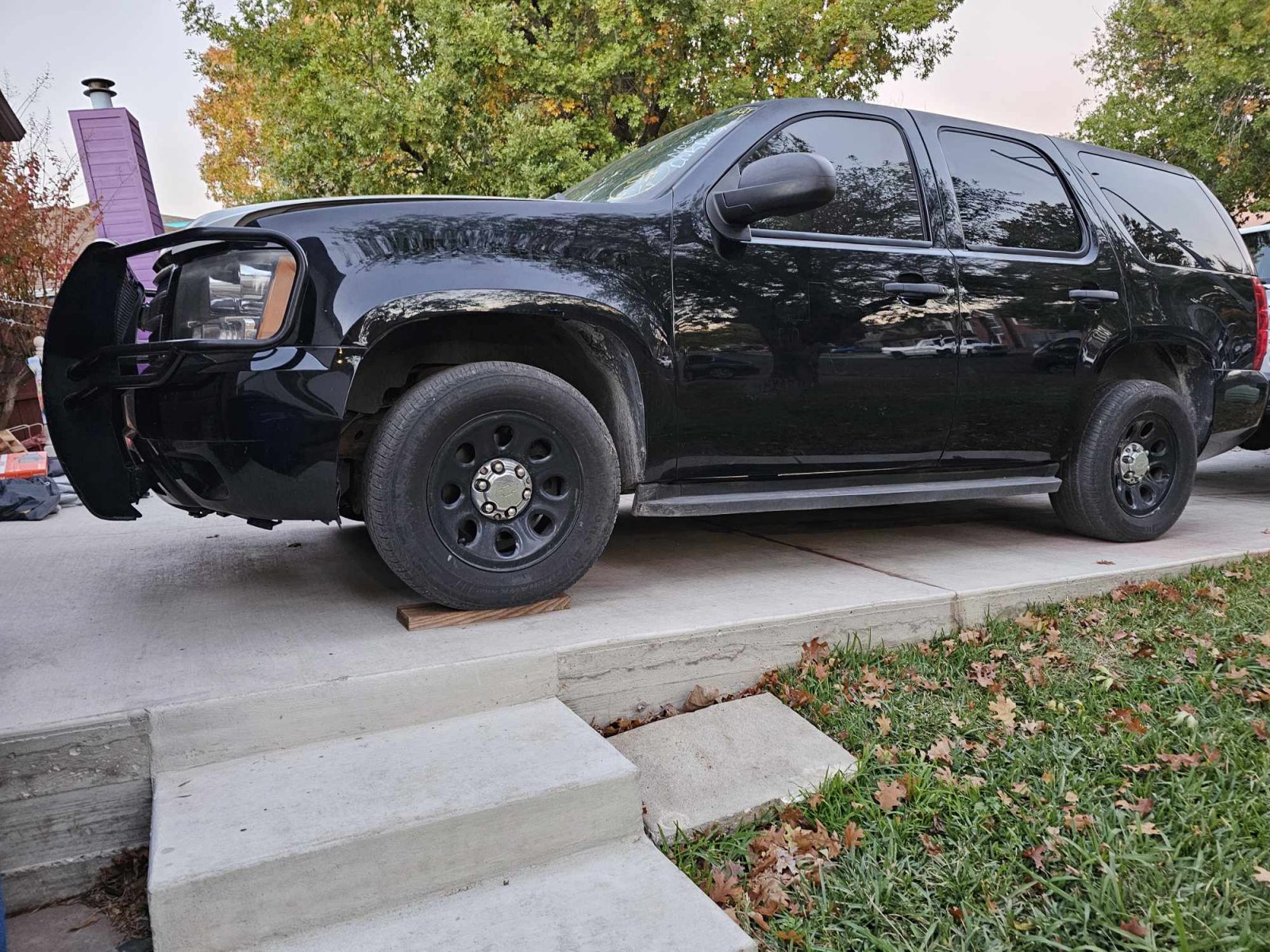

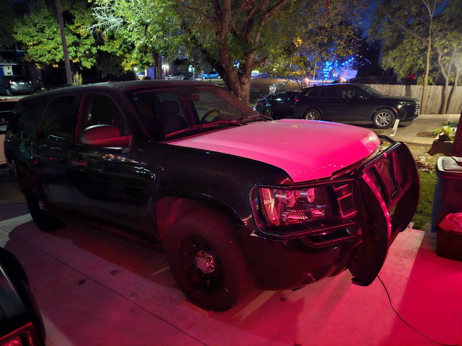

I did it! I got her home. My first Tahoe, a PPV. She's a 2014 with 150K on it. Ice cold AC BUUUT it has a Cyl #4 misfire. I swapped coils, new spark plug and wire on that cyl and no change.
When it was idling today, I can smell raw fuel and it had a little white smoke, but smelled no coolant or oil. I looked and noticed the air filter was FILTHY and the MAF wire inside was black. I pulled it and cleaned it, put a new air filter in. Still smells a little like raw fuel but not really smoking now. I'm wondering if the MAF sensor is bad. I'm guessing the #4 lifter is bad and thats why the code is there. I'm debating just putting in an LH9 6.2L non AFM and having it tuned instead of doing the AFM delete etc.
This thing was stationed in West Texas its whole life so it was disgusting dirty. I got the rear cop box removed, started cleaning everything real well.

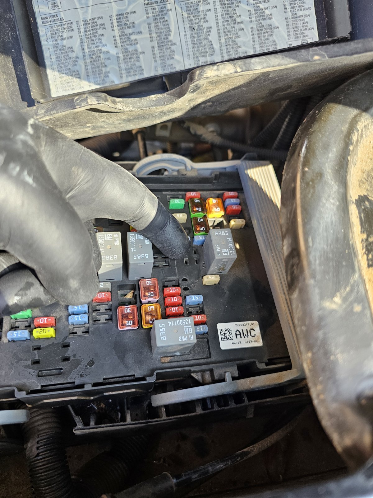

Leave the valve cover on when doing the compression test. Remove the fuel pump relay at the relay box. You do not want it to start while doing the test. Just remove the plug wire and remove plug. You said cylinder #4 is the problem hole. Remove #2 and #6 plugs too. If you do not know the cranking process for the testing, look at, at least 3-4 you tube videos for help. The first one you see may be wrong. Note the reading and then do the cylinders on each side for comparison sake. If the reading is low er than the other two cylinders, then you can dig deeper and remove valve cover and watch while doing the test again. If you can take a video or pics and post here, so much the better. IIRC a good compression reading is about 170 psi. If you get close to that, great, but you want the other two to read close to the good reading, too. If you have never done a compression test, make sure you also know what line to thread in the hole for the test.

I've already hit my first head scratcher. How am I missing the fuel pump relay but the vehicle fires up fine?
