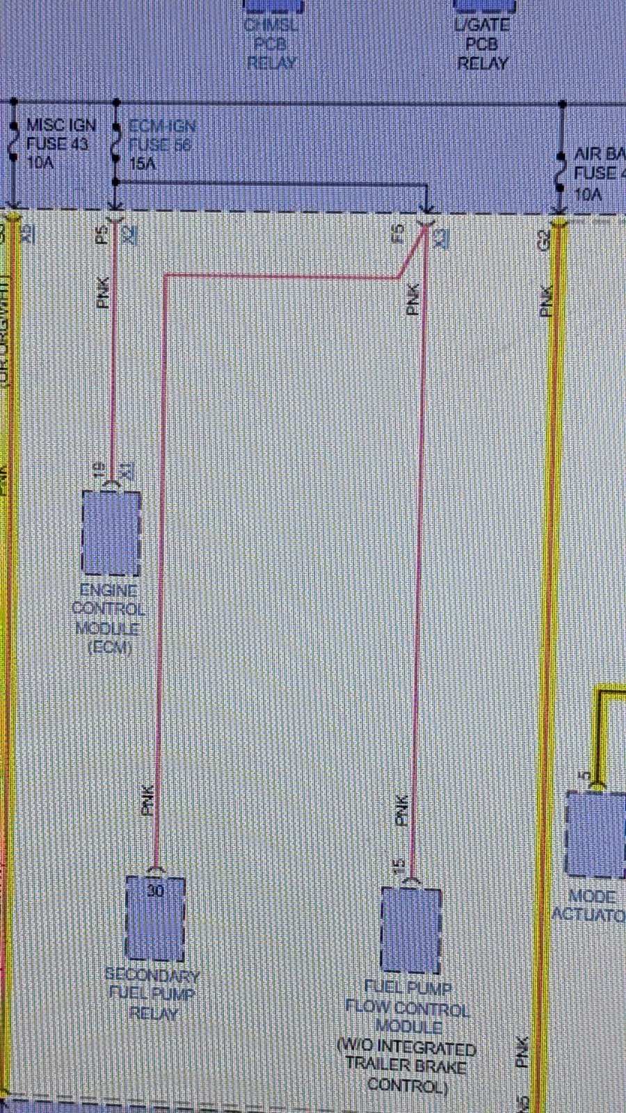

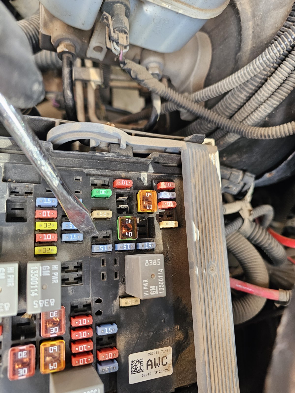

I've already hit my first head scratcher. How am I missing the fuel pump relay but the vehicle fires up fine?
it's a common head scratcher. the newer ones have a fuel pump module under the truck that runs the pump. the older ones had a relay.
pull the fuse.

Ok so there is no fuse there haha. What the heck

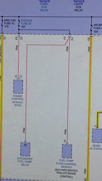

j91z28d1
Feb 28, 2022
4,675
5,933
my software shows fuse 56 ecm-ign fuse sends power to the ecm and the fuel pump module.
you can also unplug the injectors if it's easier.

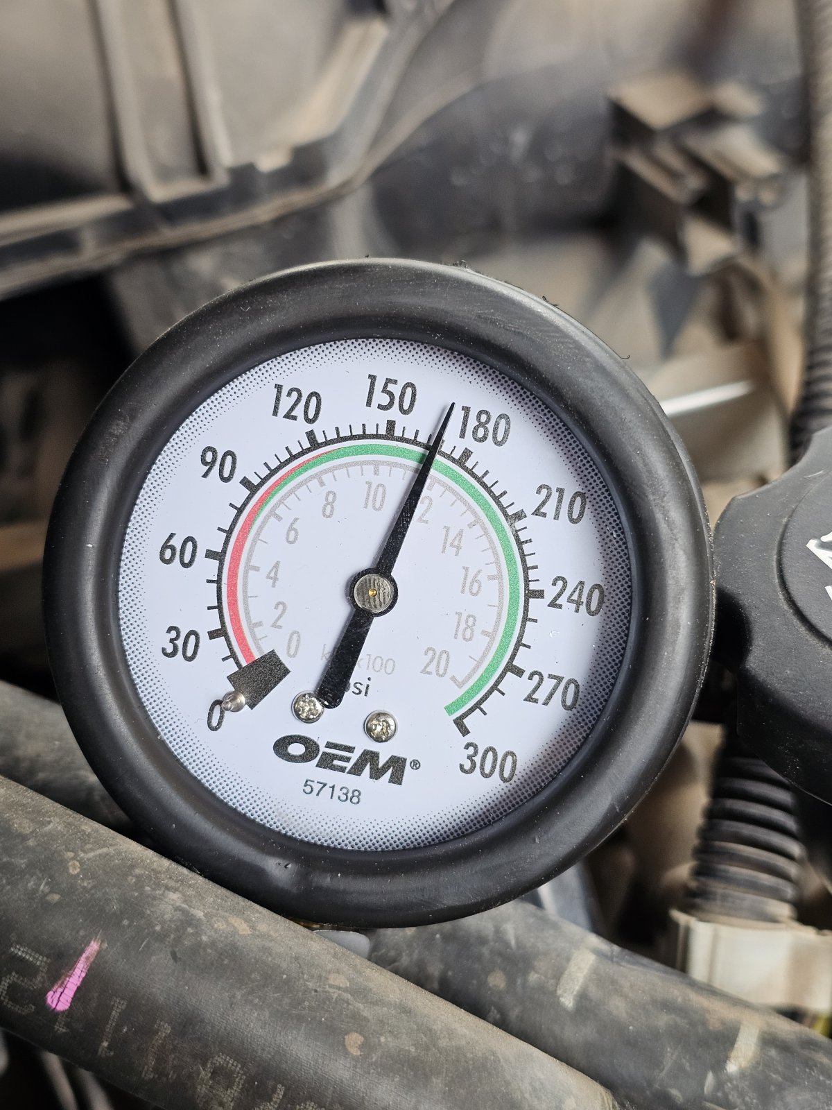

So I check compression on number two as well and it was right at about 168 also. I pulled the valve cover and had my dad spin it over and all of the rocker arms are moving like they should. Even number four that has a cylinder misfire the intake and exhaust Rockers are both moving up and down as it Cycles through the start. I don't see any evidence of a broken valve spring or at least I don't see any cracks

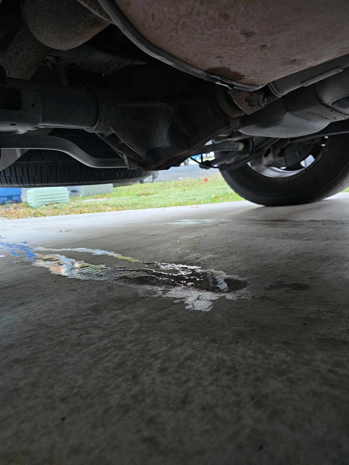

If I rev it up in park, the idle hangs BAD, like if I take it to 3K RPM and let off throttle, it will take a good 3-4 seconds to come back down and when it does, it stumbles a little and starts smoking out of the tailpipe. Its not an oil or coolant smoke though, it smells like a lot of water in exhaust pipe and there is a ton of water/vapor/moisture coming out of the tailpipe.

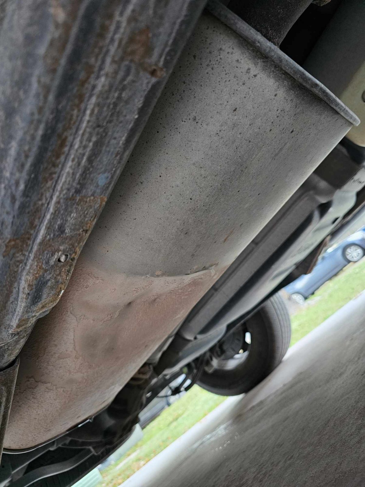

Not sure why half the muffler has mud on it and the other half is clean. Hmmm

Well, ate some dinner then swapped out the throttle body for a new one I had on my fathers C10 LS swap. No real change. While idling, I disconnected each coil plug electrical connector and the idle changed on all except #4 so there is something going on there. I decided to drive it around the neighborhood and she's smoking pretty good now and might be burning oil.
