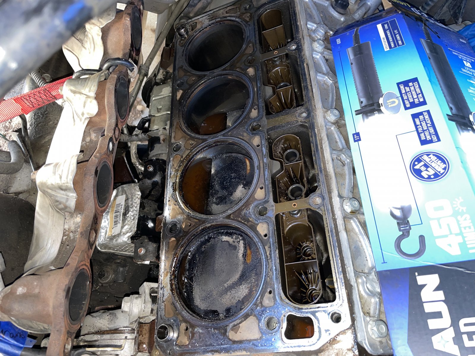

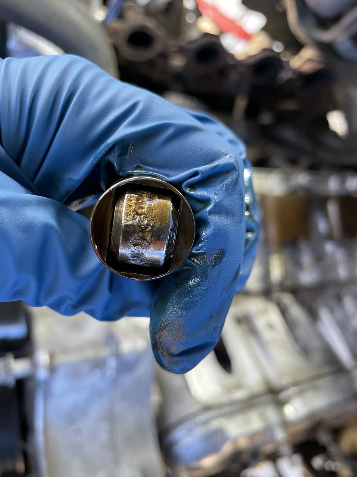

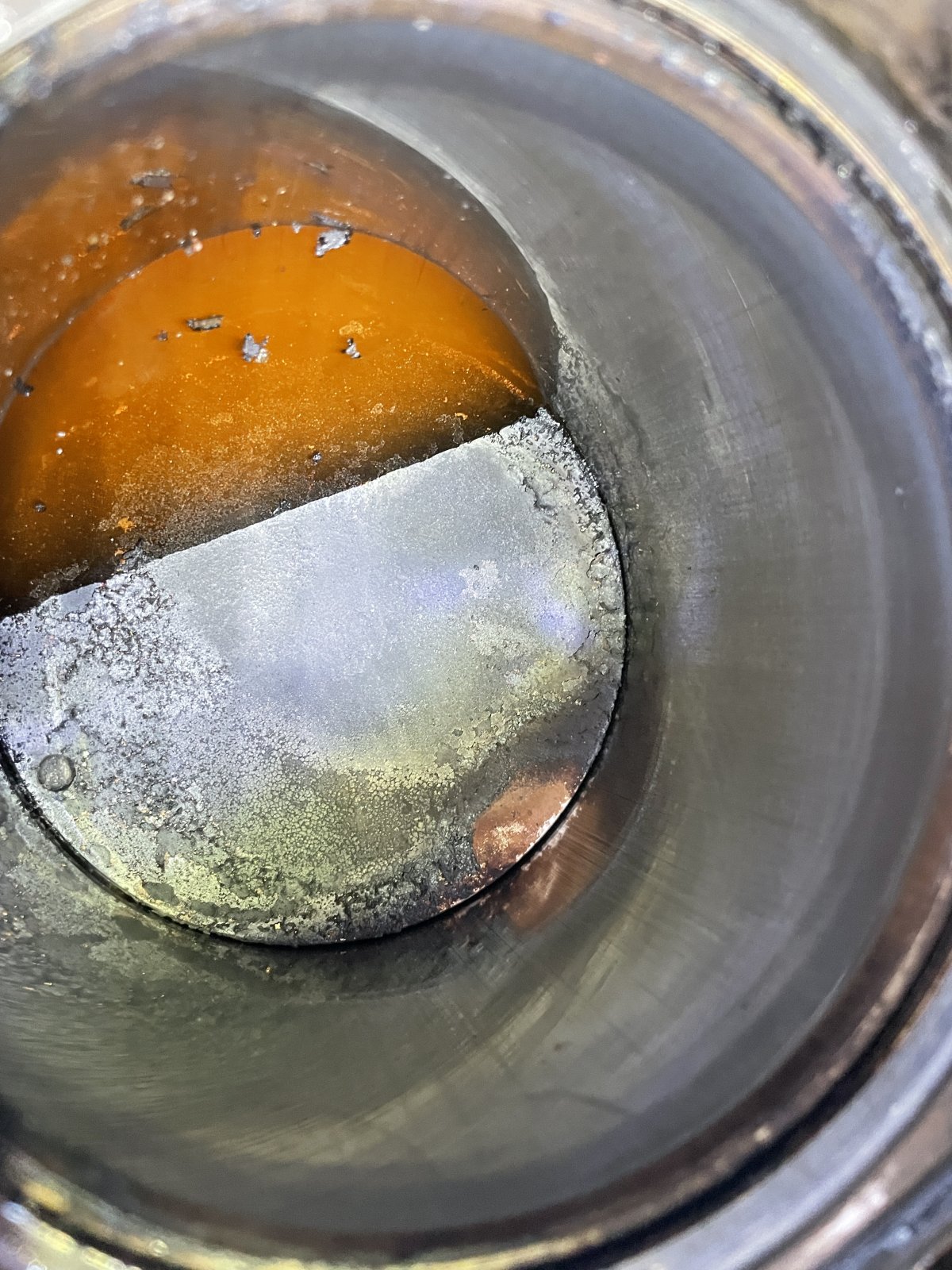

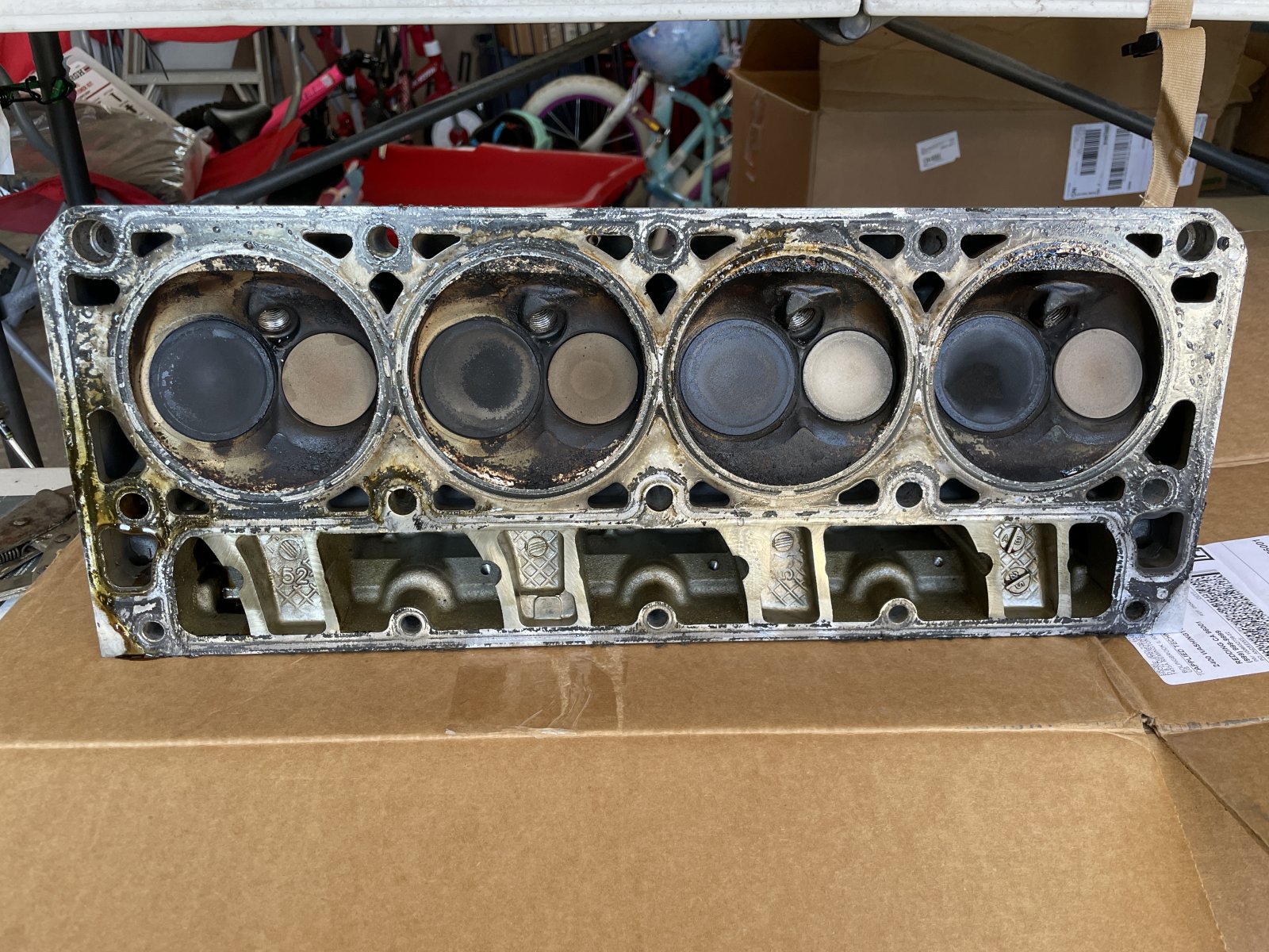

Well I got the head off today and here is what I found:

At least you found your culprit. I suspect thats just carbon bits down in the cylinder.
Should be a cam and lifters and run it repair.
Lots of junk for sure, all the metal seemed in condition

Yeap.. Wiped cam, bad lifter tray, bad lifter, pushrods should still be good thou.
Good time to do a AFM/DOD delete if you want.
