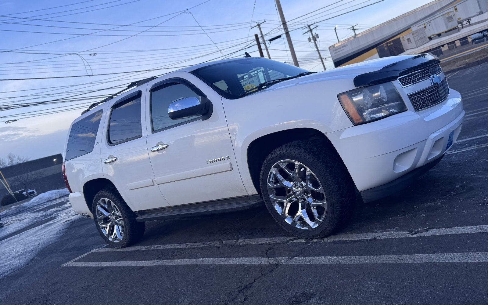

This is Frosty, 2008 LTZ Tahoe, have had it for about a year. Rebuilt trans right after I got it, pretty rust free and interior is in good shape. I really like the style of these trucks so I’d like to get some good years out of it !

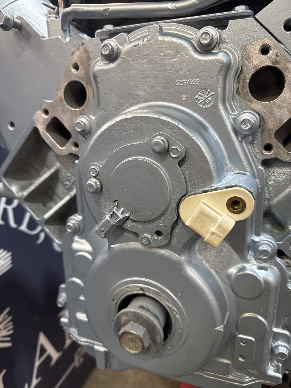

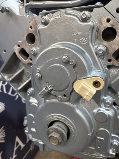

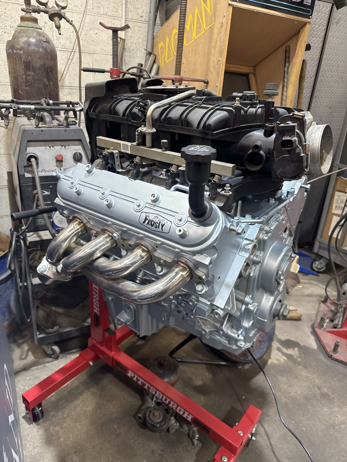

Update* have the L 92 on the stand almost ready to go in just waiting on a few more little detailed parts. Just wanna have everything ready at the time of swap, this motor has the VVT option, but the Tahoe (Frosty) does not, assuming the ECM doesn’t support it since it didn’t come with that vehicle stock can I just leave this in here? I actually ordered a new VVT sensor so I’ll put that one in just so it looks clean, but will it affect anything if I just leave it without deleting it?
