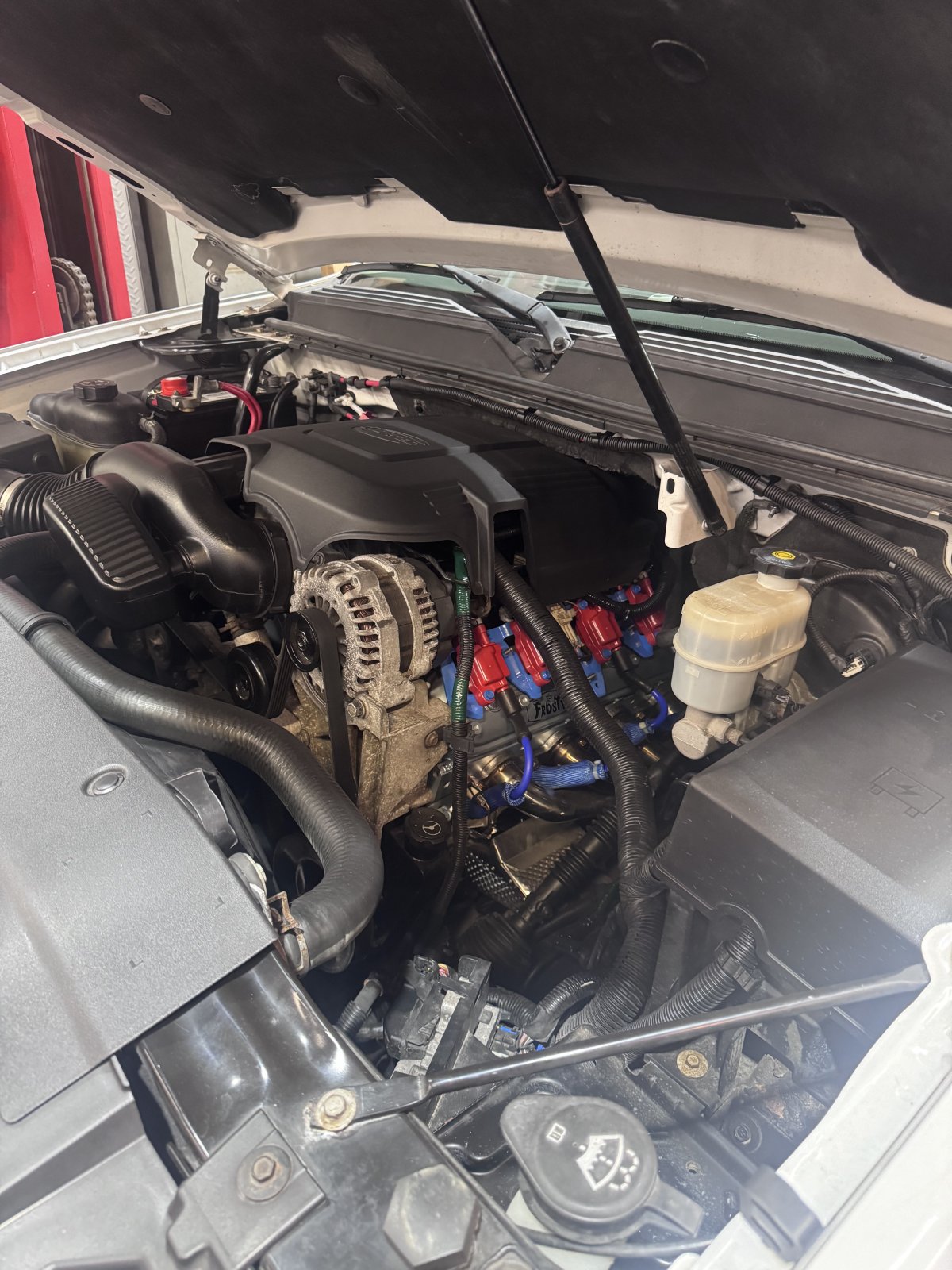

All right everybody all set. The swap is complete, moving forward now. Does anybody know somebody in the CT area that can tune this? It does start up and run, but it’s just throwing the codes for the AMF/DOD stuff that was deleted and running rough because of liter difference. Just need them to tune that out and work their magic. The swap went pretty well only took me a a few days with waiting for some parts I wanted to replace. Once I get it running good I’ll take some finish pictures of everything pretty happy with how it turned out.

Did you end up deleting the VVT or did you leave it in there? If you left it, what did you do make sure it would run stable?
After doing some research and figuring out the cams are the same for vvt and non vvt engines and not having afm/dod I just left it in there being my stock truck didn’t have vvt in the tune, I just sealed it up pretty good.
