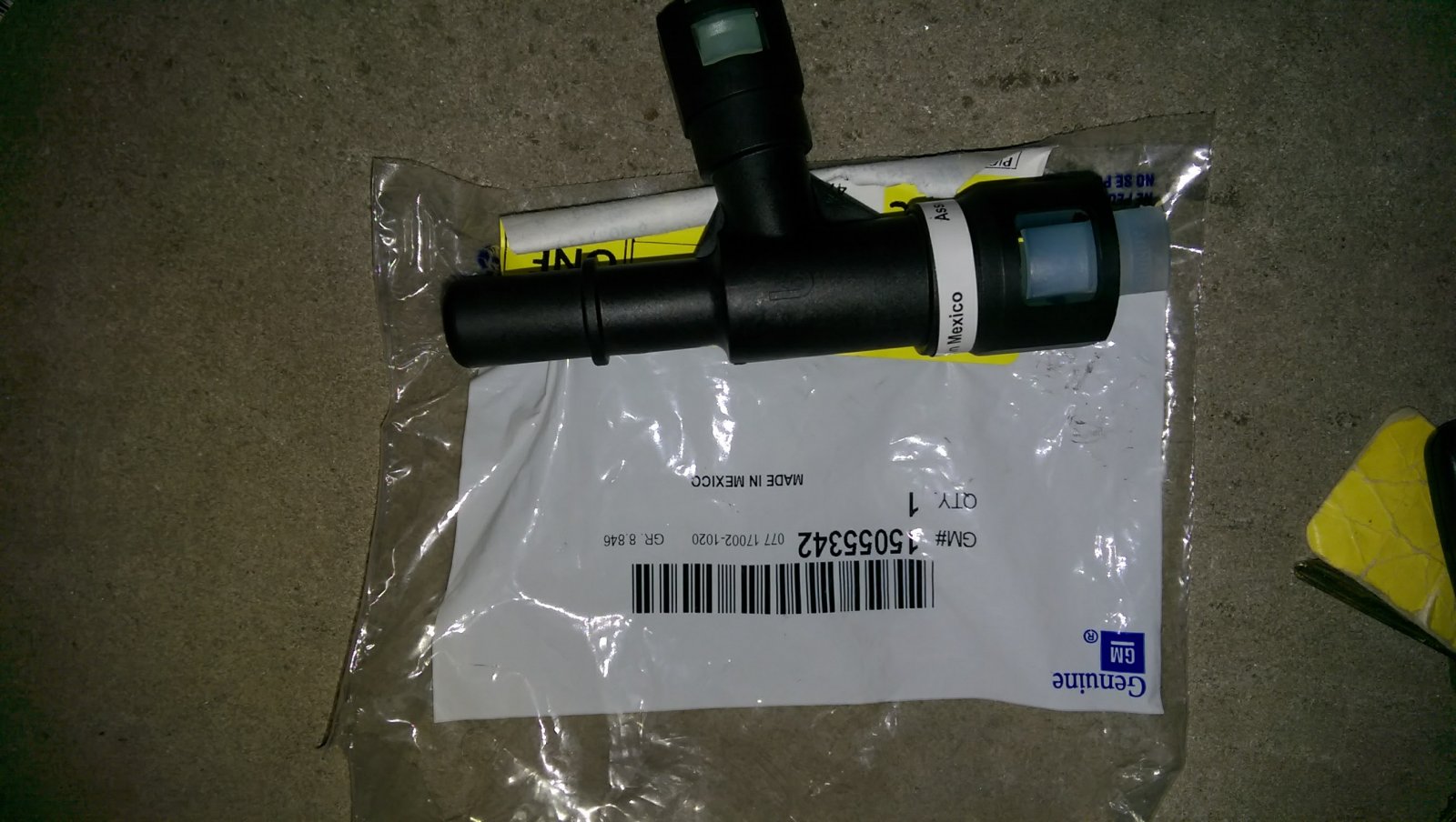

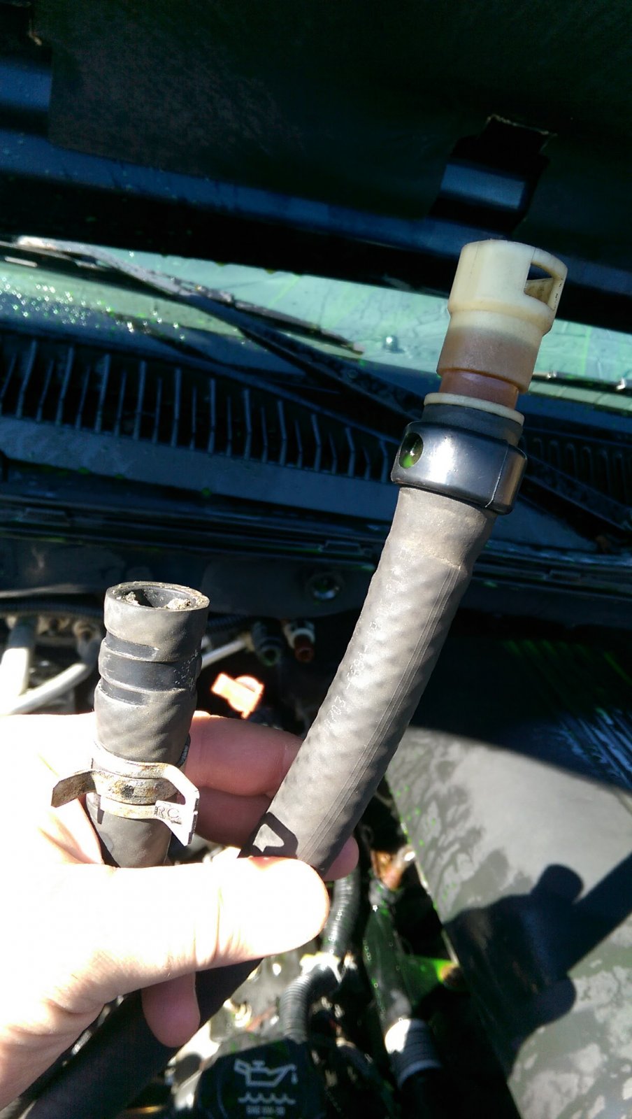

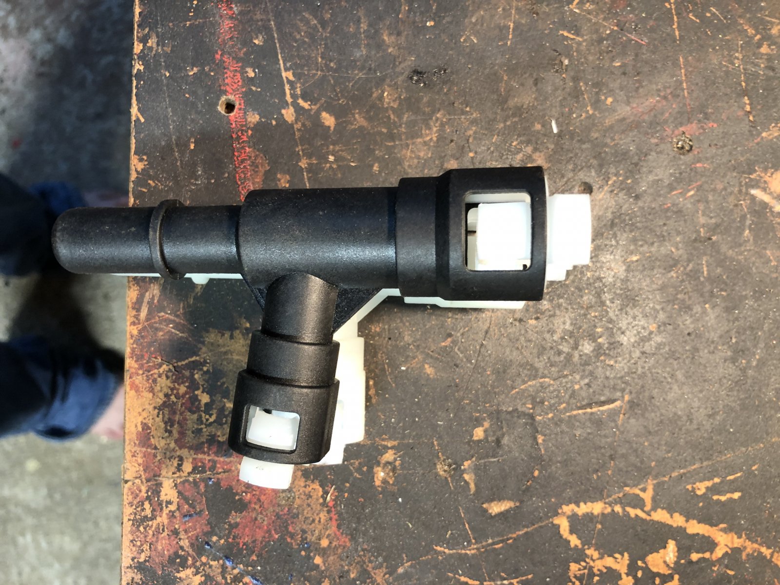

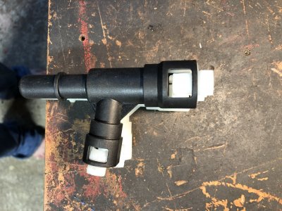

I replaced mine 1 1/2 ago, due to my error. I leaned on it trying to fix something else, so then I had 2 issues--stuck on the side of the road. Bought a new GM replacement.View attachment 222395 View attachment 222396 View attachment 222397 View attachment 222399 View attachment 222398

From what I remember--yes. I leaned on it accidentally and broke it. Here's the part #.
From what I remember it was pretty reasonable.

Black one 15055342
White one 15055343
52,949

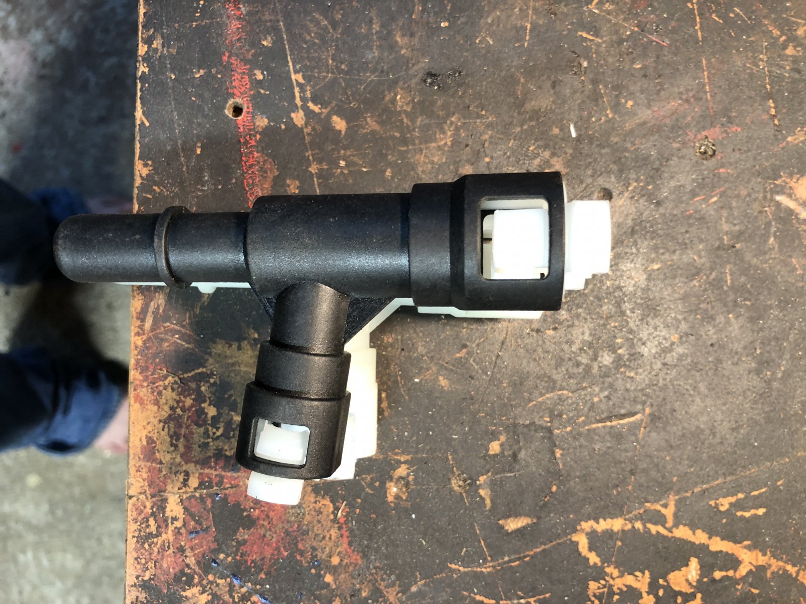

Actually, aside from the color, they are dimensionally identical and interchangeable.
Actually, the white one tees off at a 90 degree angle while the black one angles forward in the engine compartment, I believe because that hard line that connects to it sits higher up on the firewall, where the angle of the firewall changes. It’s probably angled so that hard line maintains its distance from the firewall. Otherwise, believe me, GM would not have wasted money designing, manufacturing and stocking separate parts where one would have worked just as well.
I'm not 100% certain about angles but the inlet and outlet dimensions are the same.
My understanding, from the research I have done, indicated that the difference in color was more for easy identification as to which hose went where while the vehicle was traveling down the assembly line.... but who knows... all I know is the inlet and outlet sizes are the same.
52,949
No need to take my word for it, here you go. The color difference is most likely because the 2 are so similar. Different for a reason though.

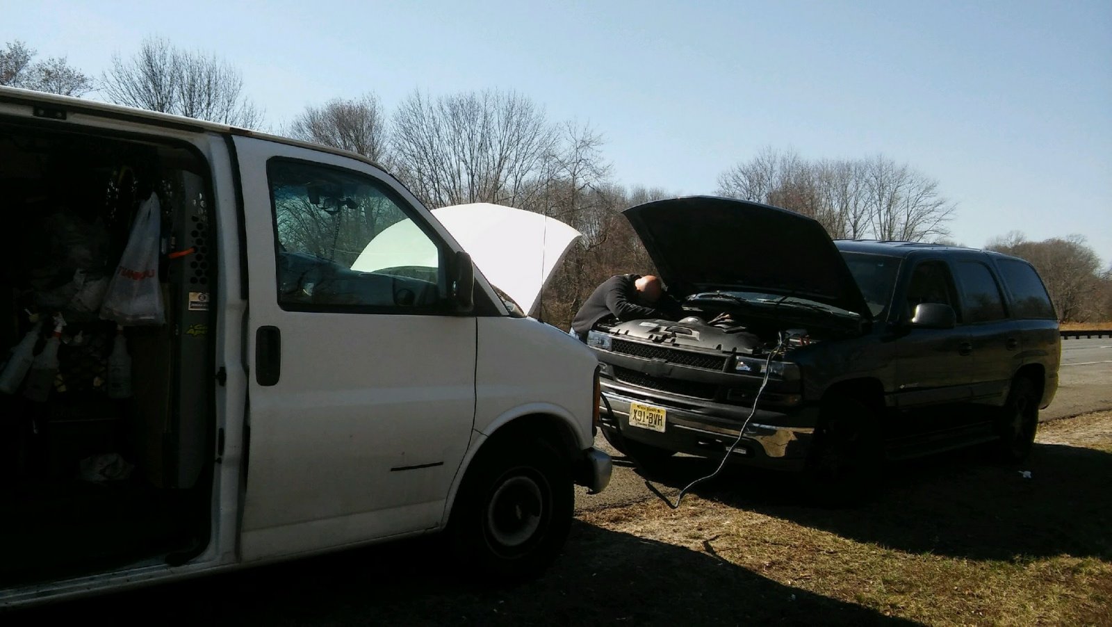

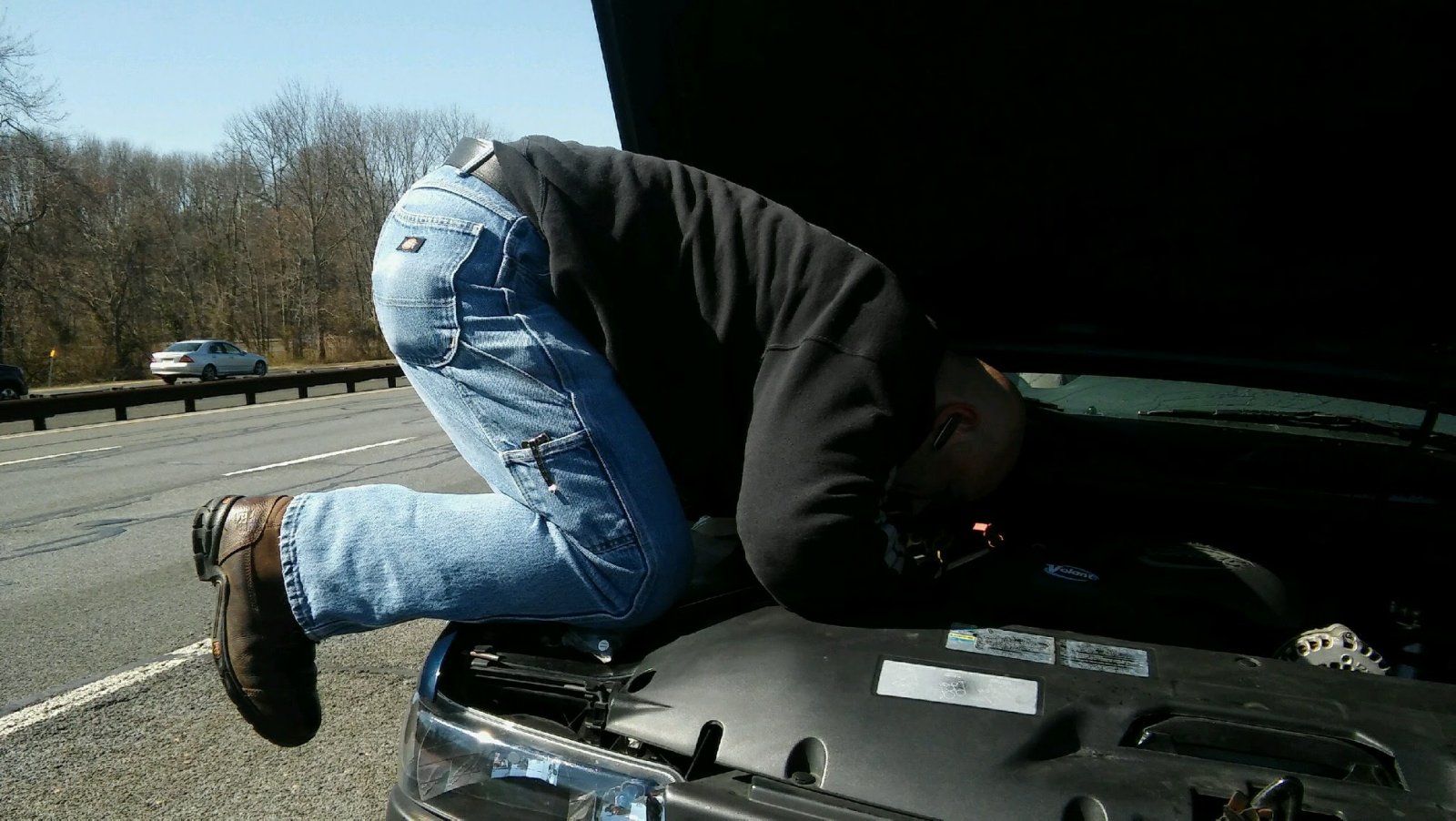

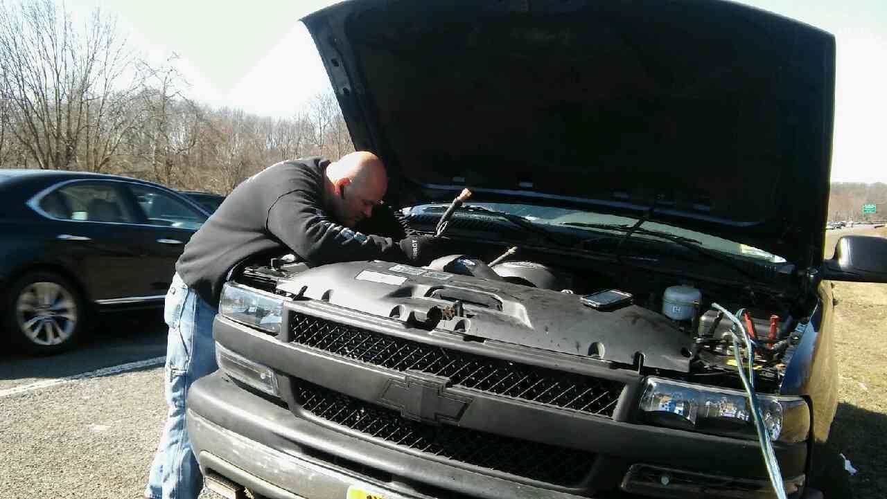

Yikes! That is the scenario im talking about, the fact that you were able to get that done on the side of the road is crazy. add to it the coolant mess and heat! To all those reading these post's i strongly advise doing this PITA "simple" job in your driveway!

Also to those viewing these great pic's, In an emergency side of the road situation you can cut the hose just aft of the white T connector. Completely remove the hose from the water pump that connects to the black T connector and install the cut end of the white fitting hose to the waterpump and create a loop circuit and down the road you go!

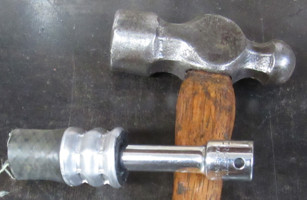

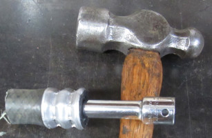

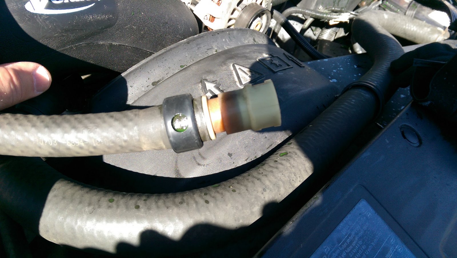

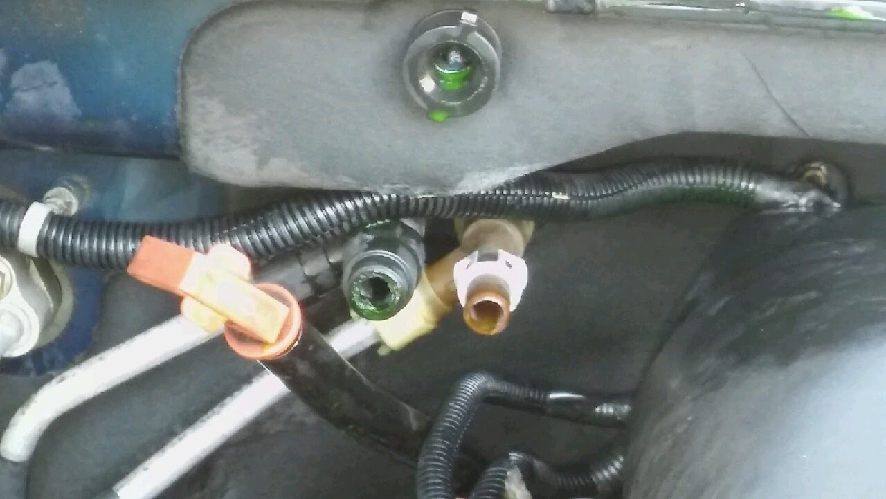

My hose parted at the quick connect fitting, while on the road Friday evening.
Looked at what I had on hand in tool bag, turns out extensions for 3/8 drive ratchet are a tight fit in and of hose so i drove one into each of the open ends, and drove home.
Cut broken hose, stuffed large bolt in end & applied hose clamp.
No way to plug "T" fitting, so I cut other hose and plugged with bolt.
Drove all weekend with no heater.
Monday morning will order new hoses and "T" fittings and replace every thing.
