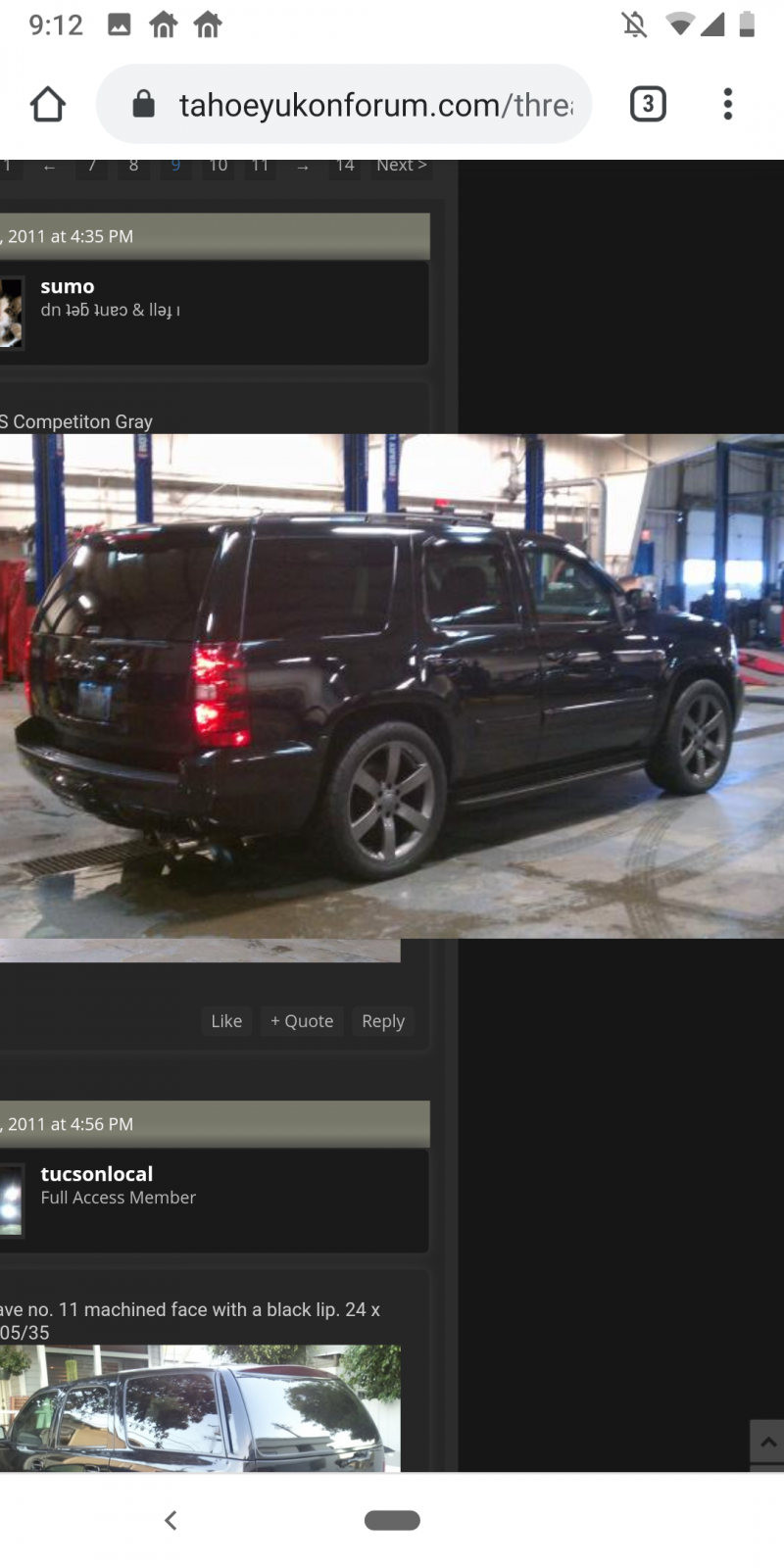

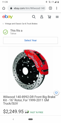

I'm exploring wheels since I want big brakes
