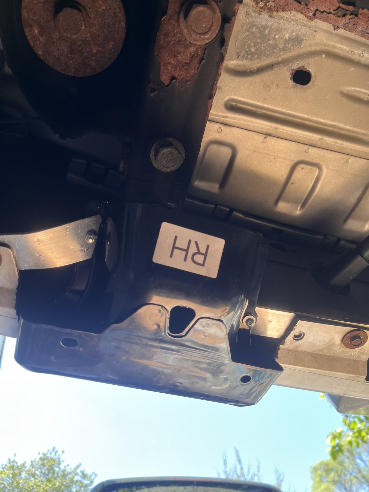

I custom made a front splitter to compliment my PPV front lip. Using ply wood I cut out the desired shape, coated it with fiberglass resin and the many multiple coats of bed liner to further seal it. It’s mounted to the bumper frame in the front and the rear underpan by the wheel wells. Very solid, which was a challenge to achieve with the PPV lip which has no under flanges. First pictures is raw plywood so you can see the actual shape, the black disappears in pictures.

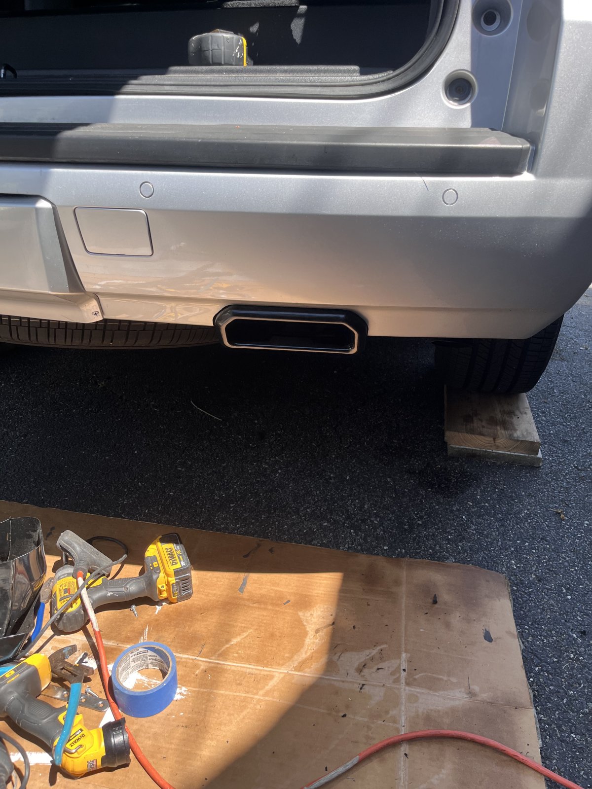

After that I cut in some dual Silverado exhaust bezels, I wanted an OEM plus look. They are currently not active, dual exhaust is on the list of future mods, but I needed the output location set before I could have that fabricated.

The exhaust cutouts in the bumper with the tips is such a nice touch, wow

Can you show us how you did those exhaust tips? Where you got them from?
I got them fro eBay. It wasn’t hard. I made a template for them. Right and left are slightly diffent. Then I layed them out between the bumper mounting tabs figures out the heights and cut them in with a dremal. Started small and cut more till I was happy.
Mounting was the hardest part. I used some aluminum stock, cut and drilled it where it needed to go

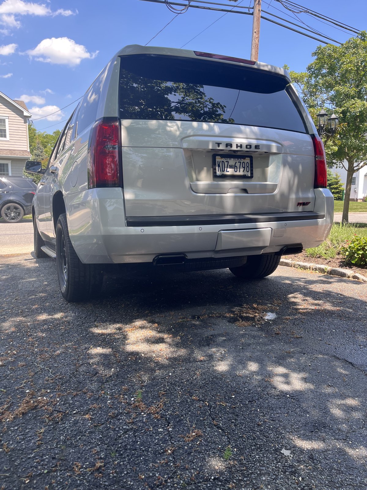

Lowered the rear today with a maxtrax 2” spring kit.

And here’s how it sits today.

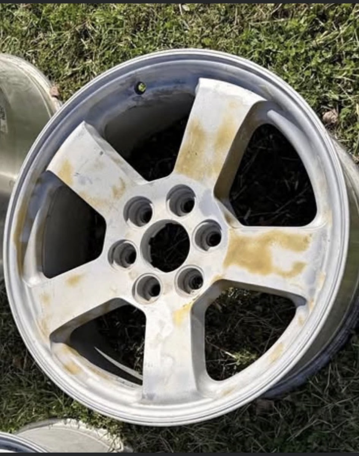

If anybody in the NY/Long Island area has a set of either of these wheels they want sell cheap let me know. Declads are my next/last exterior mod!!
I recognize those from marketplace. Did you message that guy? I was going to pick them up but ended up buying another car lol.
