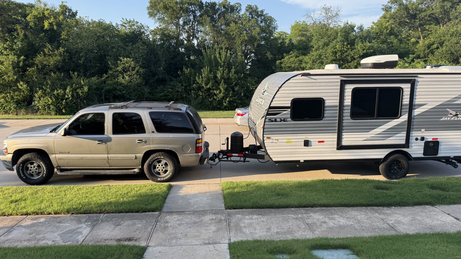

A little intro. I am a veteran and business owner who operates in Dallas. I originally towed our new Travel Trailer with my Colorado, but man was it tight loading three large Dobermans into. This 2000 Tahoe was acquired to provide them max comfort and us with a 4 wheel drive vehicle for camping up north(on the edge of winter). Since this picture was snapped I have installed an Airlift system in the rear and refreshed the transmission. I have also installed a larger trans cooler to help with the workload. We are testing in TX hill country for additional issues to resolve before committing her to full on duty service next year. All front end suspension has been replaced as well as the rear differential. At highway speeds the Tahoe, by itself with no trailer, wobbles when transitioning from pavement to bridge and back again. Shocks and tires have also been replaced. Any suggestions? I’m gonna get alignment today and inspect panhard bar and all bushings again.

On the photo it looks like the rear end is squatting quite a bit. Maybe that's why you are getting sway? That would obviously only occur when towing. If you have the same symptoms when unloaded, then there's something else going on. Can you add more force on your WDH to get more load to the front axle? I'm guessing the airlift system helped with the squat?
