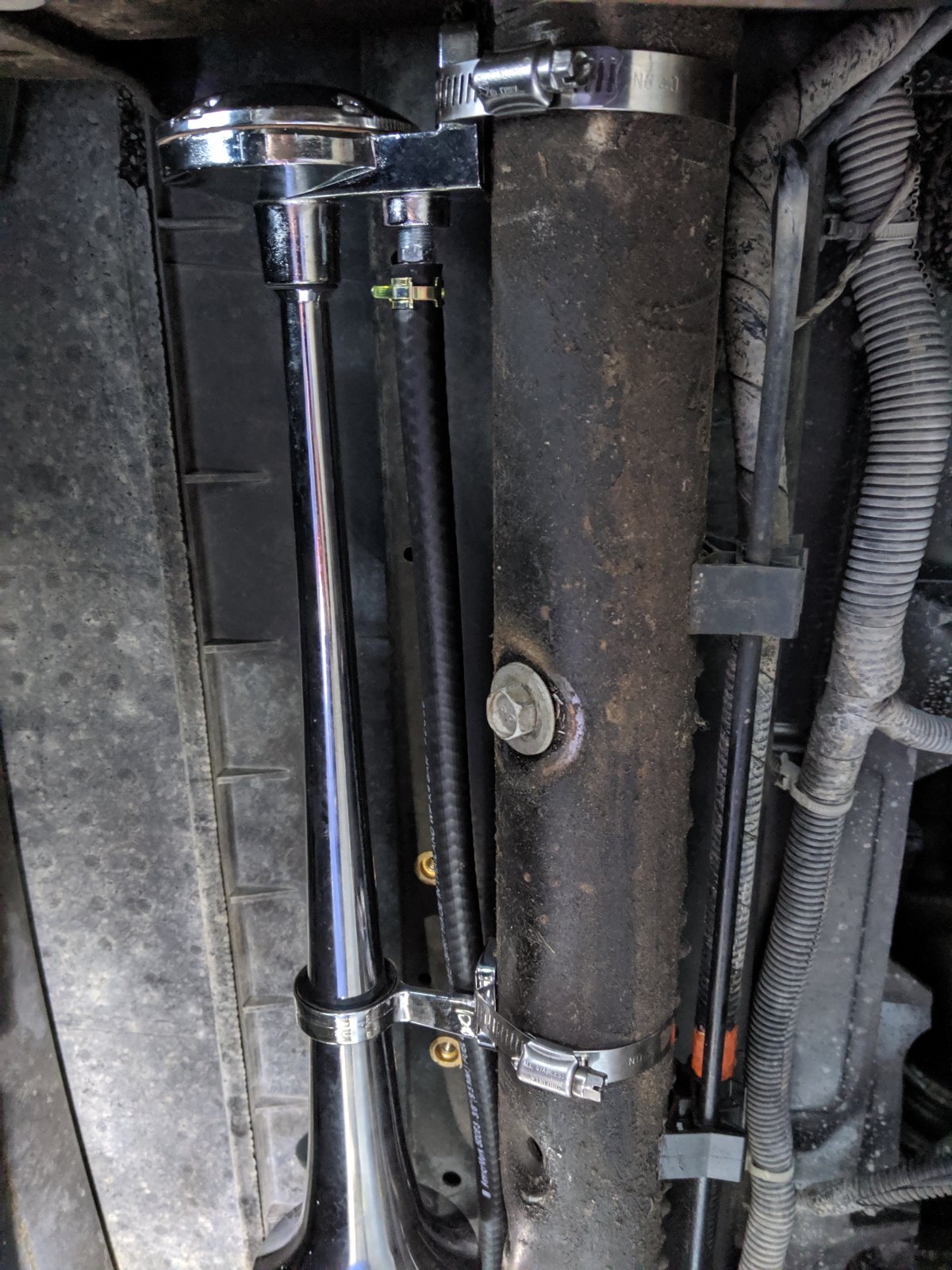

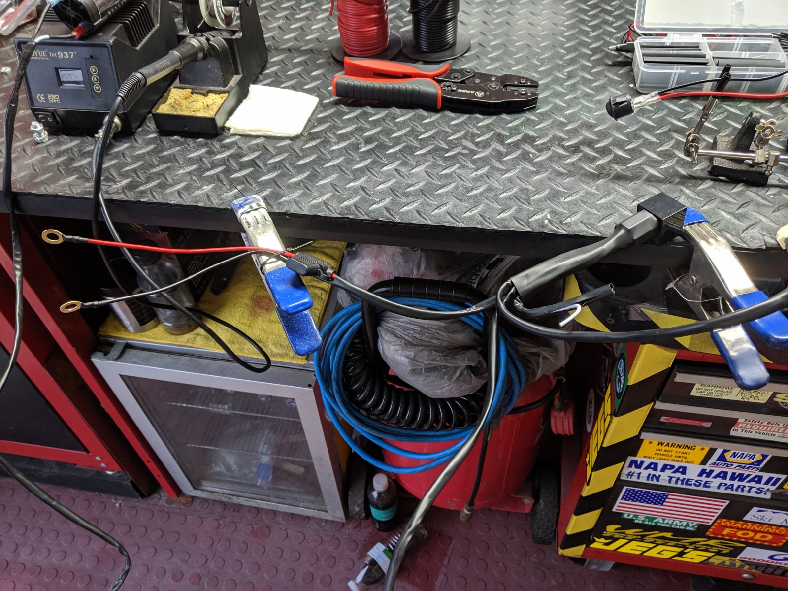

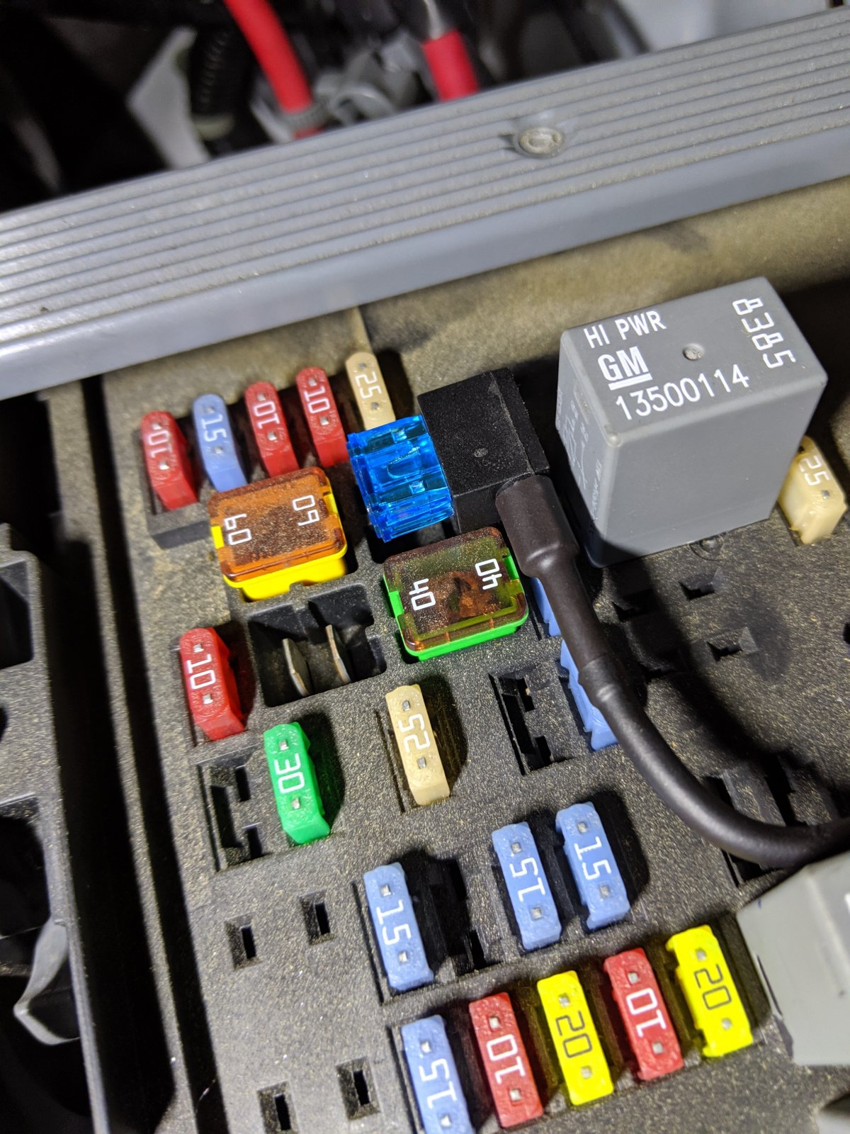

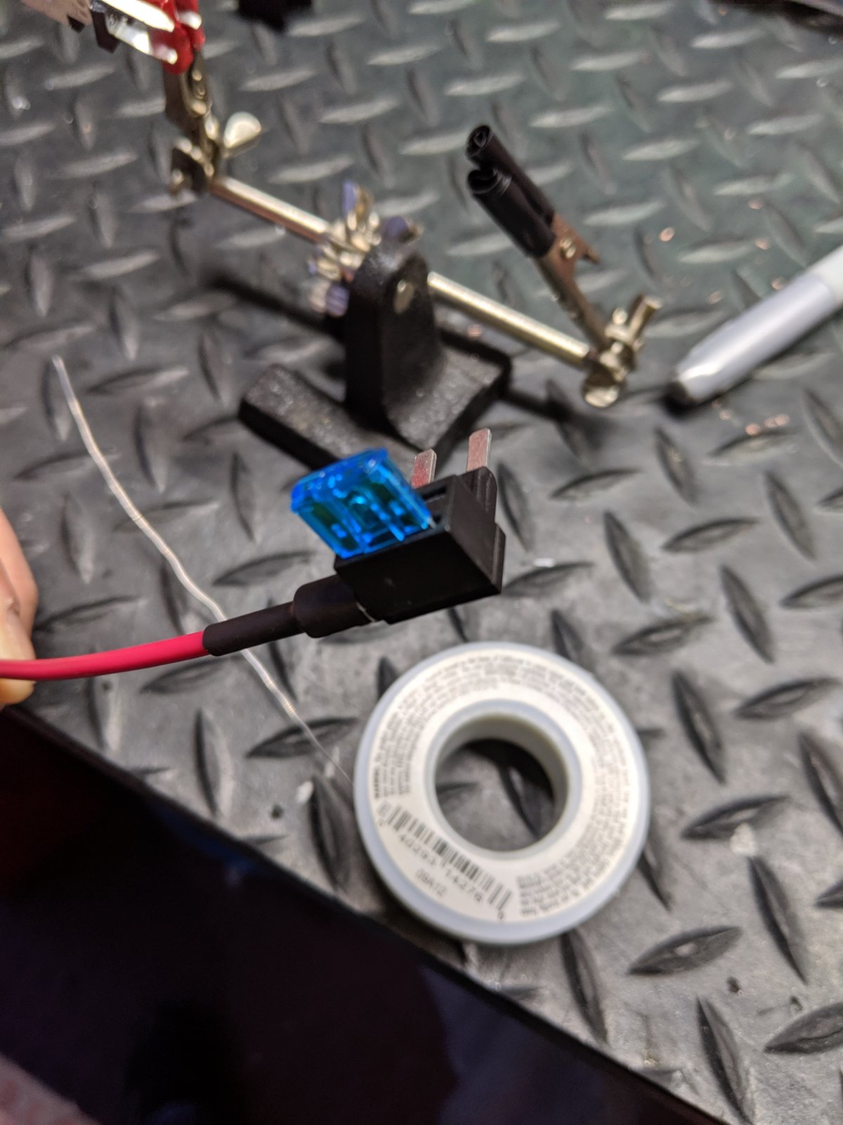

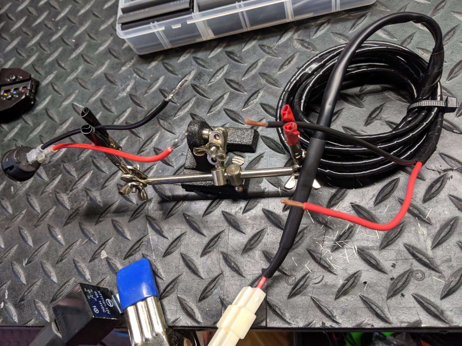

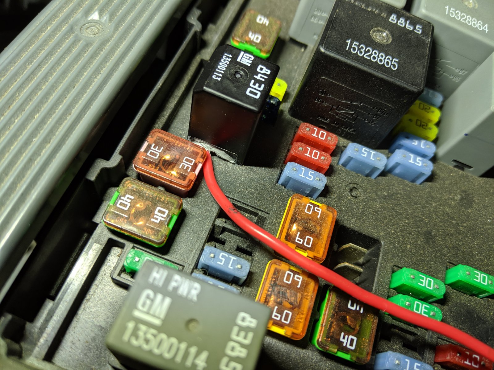

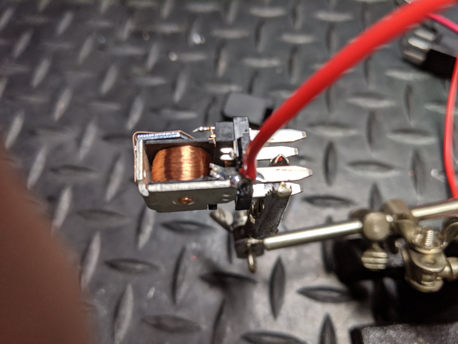

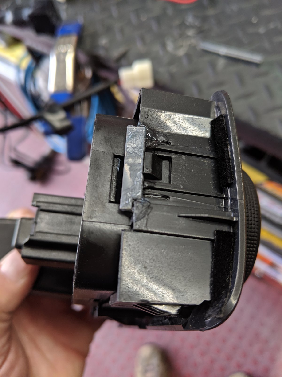

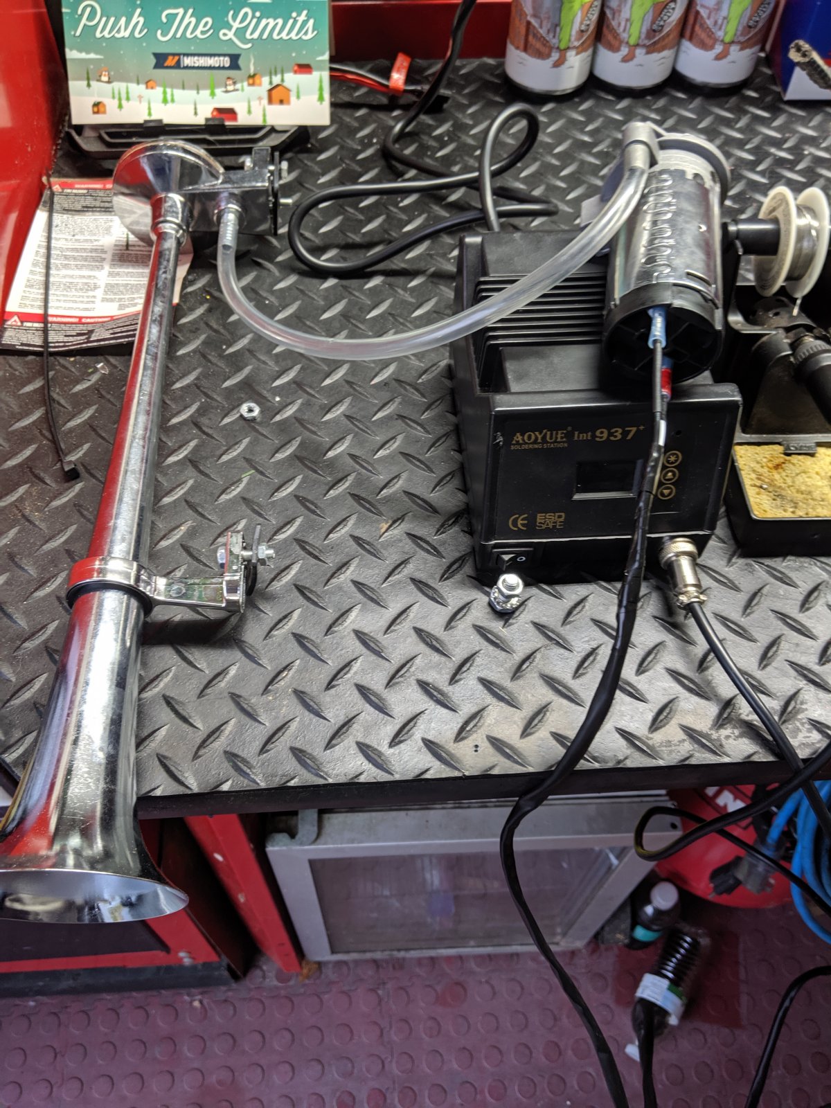

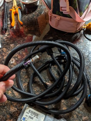

Well been a productive few hours of bummin around in the garage.
- Wiring harness and switch for airhorn installed.
- New headlight switch for OEM foglights in

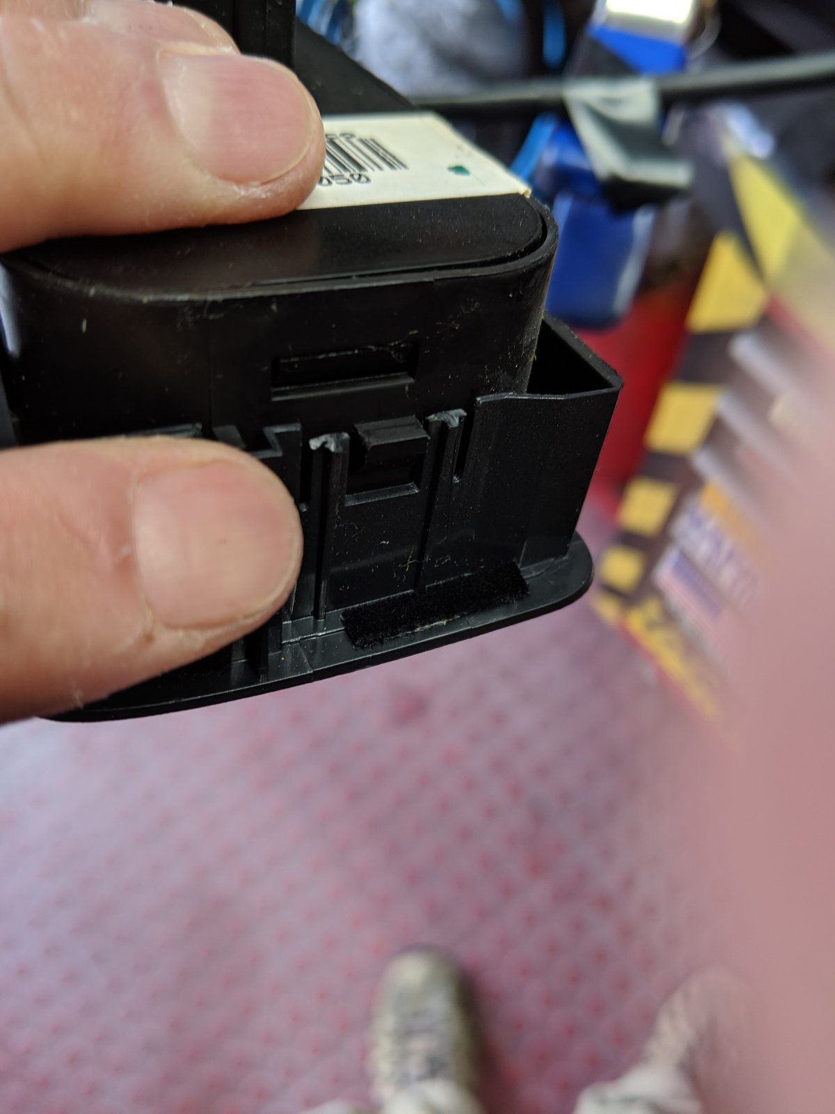

- When I took the old head light switch out it was loose......so I had to repair a broken tab with some spare plastic I had on hand for RC trucks.
I'll see what else I can get done before the sun drops

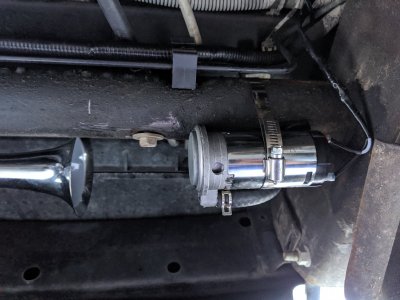

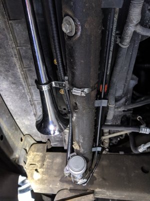

I chose to use the worm clamps to install the horn and compressor so I can remove it quick......and not holes needed to be drilled

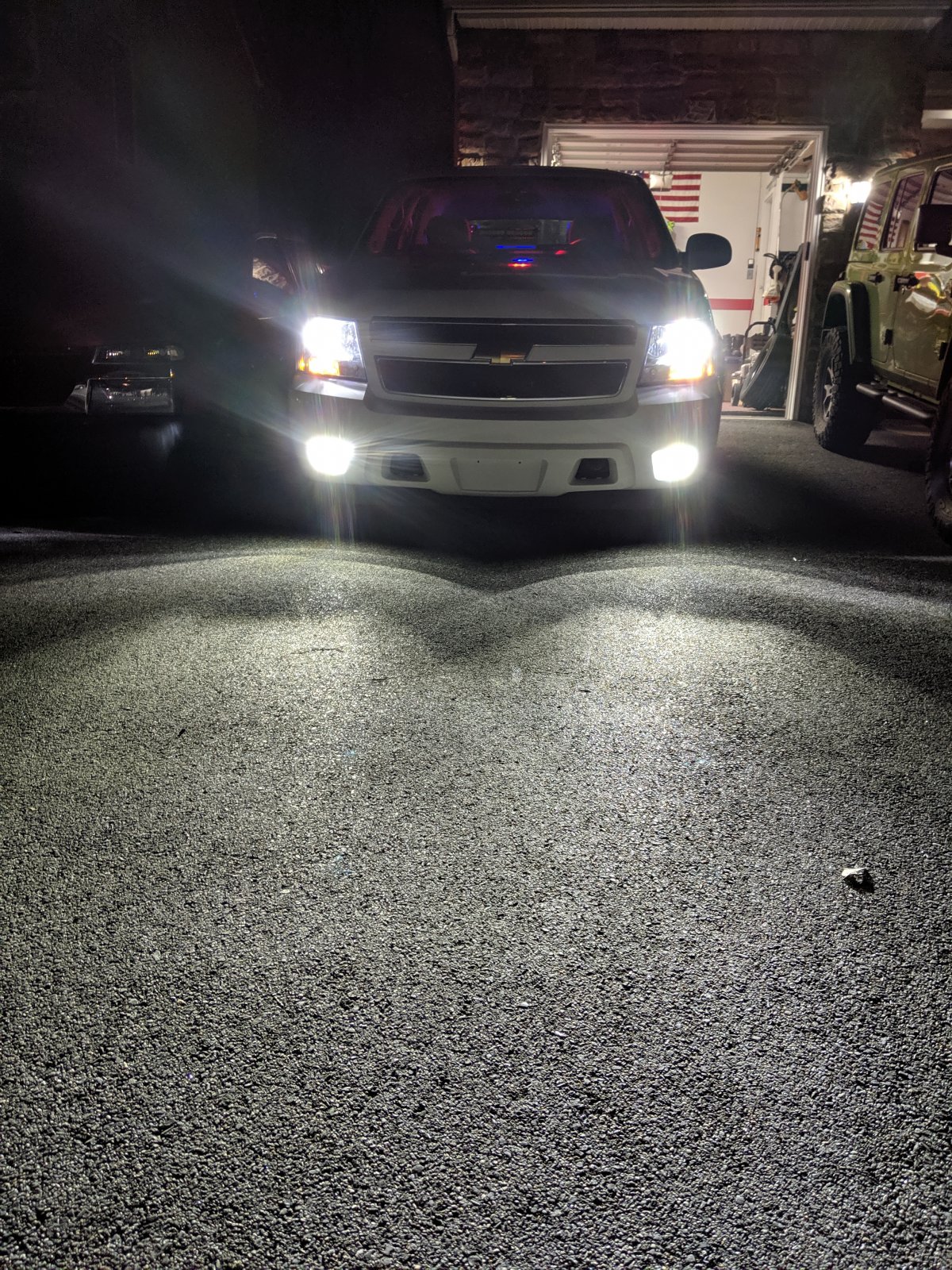

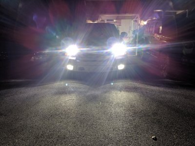

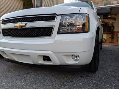

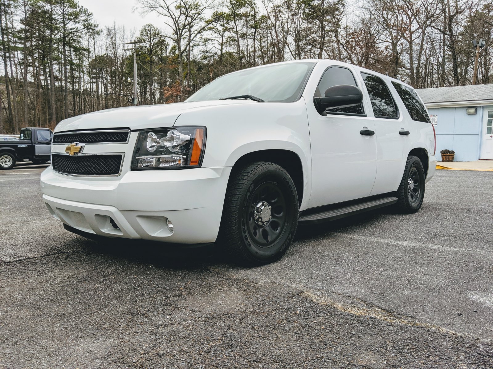

Headlights look great. Are they replacements?
Sent from my SM-G973U using Tapatalk
Yes, one of the first things I did. I hate hazy headlights. I'm ordering Lamin-x film to cover them and the foglights

I had to adapt........my way ended up working perfect. Sadly, the OEM headlight switch for the foglights was not needed.
