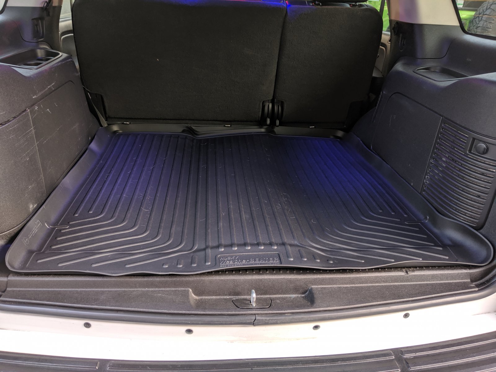

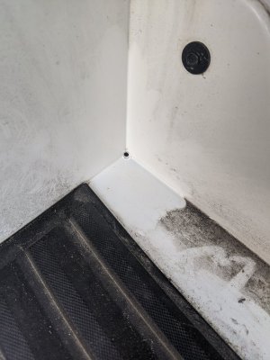

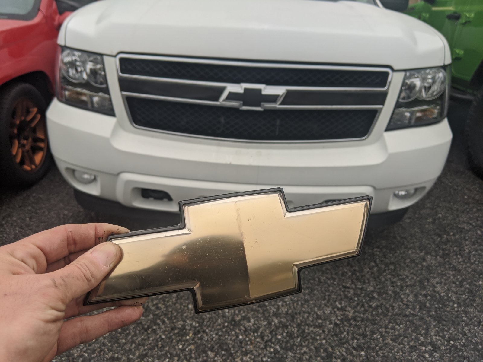

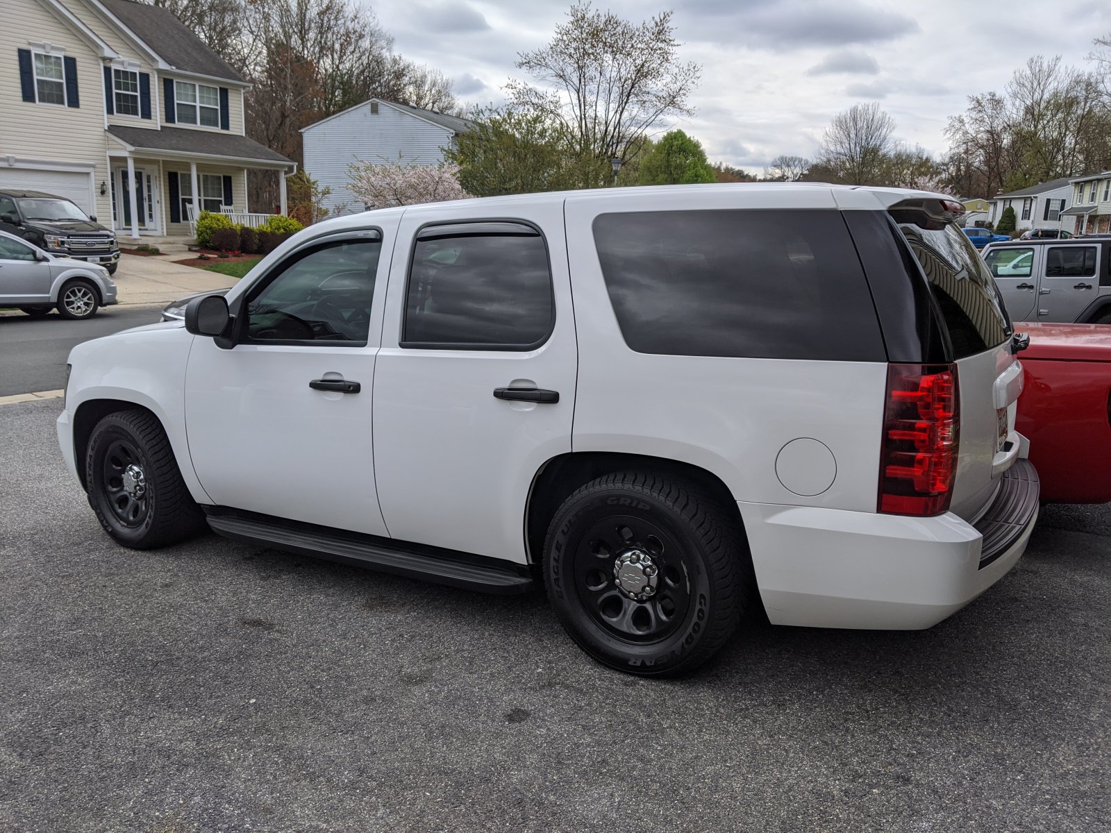

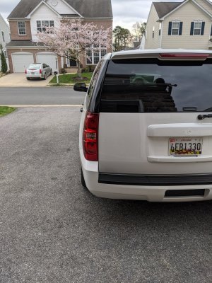

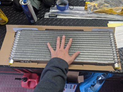

Some small updates and parts in cue for install. New black bowtie up front and my new trans cooler. Just waiting on the brackets and hardware I ordered to install it.
With all of the rain and when washing the PPV I got tried of the water collecting......so 2 drainage holes it is

Tru-Cool 40K? I have one on the way. I just saw there is a factory cooler kit (GM Part #19171483) with lines that would work for the Tru-Cool with very little modding. Basically it's just trimming the radiator shroud where the lines would normally run so they can be spread apart to fit the wider cooler.

Tru-Cool 40K? I have one on the way. I just saw there is a factory cooler kit with lines that would work for the Tru-Cool with very little modding. Basically it's just trimming the radiator shroud where the lines would normally run so they can be spread apart to fit the wider cooler.
Yeah a I ordered the brackets and hardware from a member over on performancetrucks.net

I just wish I had known about those factory lines before I placed another order. It would've put me over the "free shipping" amount.

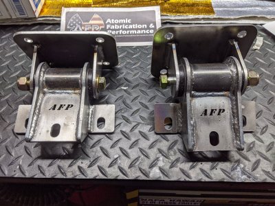

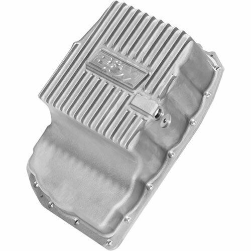

Well I bit the bullet and ordered the Atomic poly motor mounts and the B&M 70392 deep trans pan since I will doing the trans service and TruCool Max trans cooler next week.

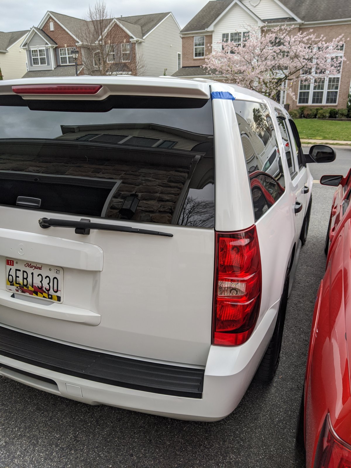

What better thing to do when bored and have some black 3M vinyl in the garage. Wrap some shit fools.

I finished the vinyl work and now on to some paint.
Atomic motor mounts and B&M deep trans pan came in today.......and I got stickahs FTW; 10 more rwhp

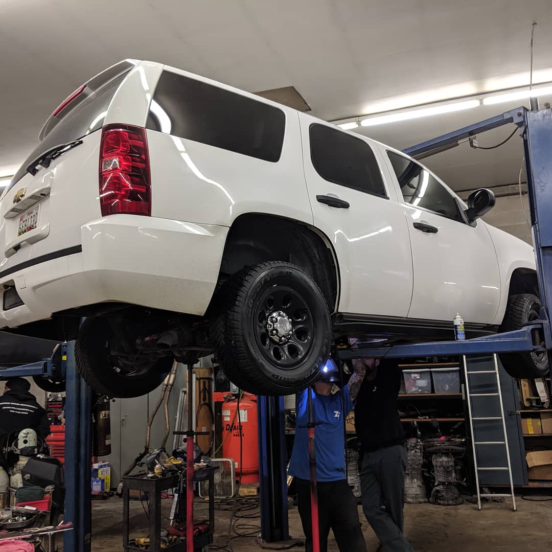

Parts ordered for a ring/pinion swap and Yukon Gear and axle Dura Grip positraction.
Going to 3.73 since 3.55 ratio was not available from Yukon Gear
Scheduled the install for next week.
1BADI5
1BADI5
Feb 2, 2014
1,833
2,991
DMV
are you replacing the whole axle or just the internals
New ring/pinion and locker; plus a complete rebuild (new bearings, races and gaskets)
So same axle housing and axles......but all of the guts are being replaced
