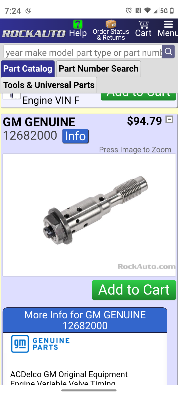

So this is what the Melling kit comes with. It’s their solenoid, but they label it as solenoid/actuator.
And then what you are saying as the solenoid is what companies are labeling as the camshaft adjuster magnet.
So just to be sure, you’re saying the Melling actuator in the pic is OK to use but for the camshaft adjuster magnet / solenoid, use GM only? Or should I use GM for the actuator and the solenoid? If I buy the kit from Melling with everything I don’t know if I should void the actuator in the pic.

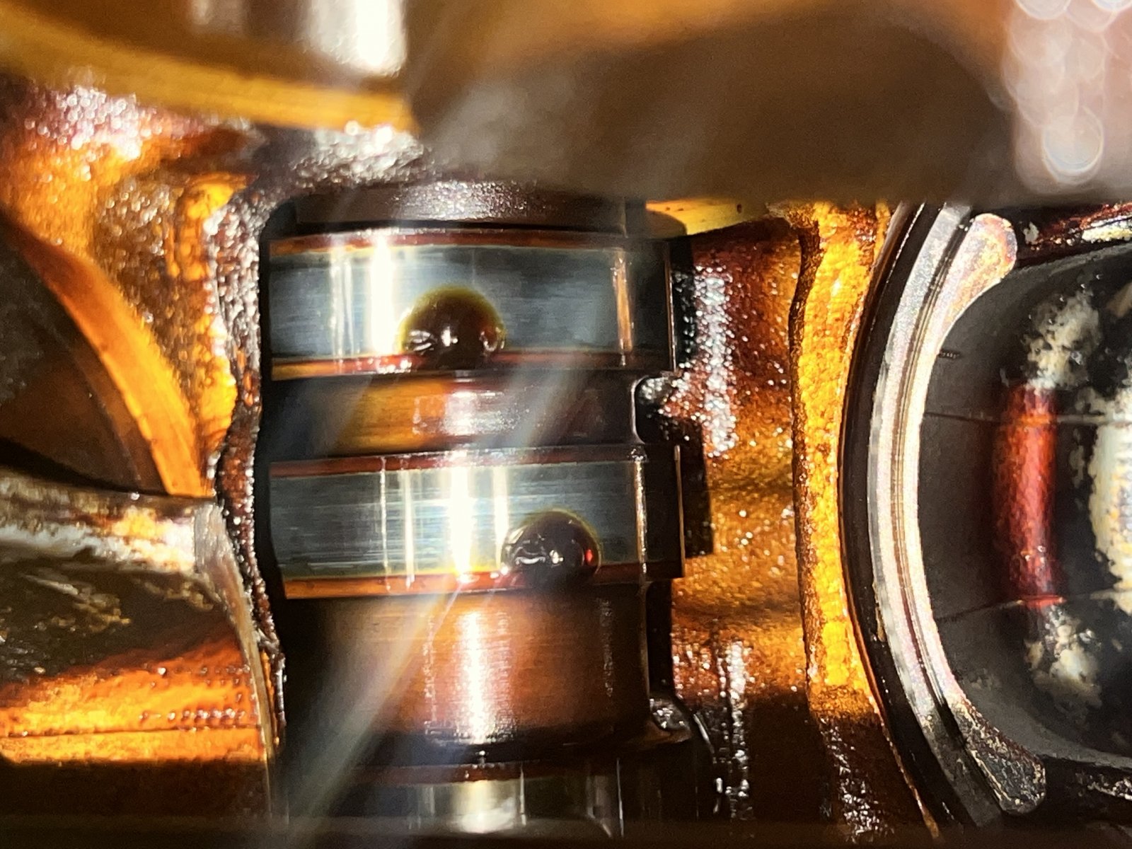

I appreciate the comment. And it sounds like you dealt with something similar and kept the engine running for awhile.
The current consensus is that much of the flakes that were seen were some form of carbon that was inside the engine and the combination of oil color and oil additives were making it appear as a gold flake. When I touched a lot of the larger flakes, they would disintegrate. Quite odd really. And when I fully drained the oil, there was not a crazy amount of fleck in the oil to warrant a panic. But I’m also not a mechanic by any means. I also cut open the filter and looked at the pleats and didn’t see really anything.
After the o-ring install, I got another 5psi on a cold start and my cruising 70mph psi went from 22 to between 28-35psi. And my idle psi went up about 3-5psi.
So at the end of the day, I’m going to ride it out because it sounds like a rebuild is more expensive than a donor engine. Probably will do an oil analysis in the future to check on wear metals.
And who knows if the dealer knew about the issues or not. Hard to tell. But apart from an intermittent random slight valve train tick (which got a little better with the new o-ring), she’s still purring and has lots of power with no strange noises. God bless to you as well!

I would stay with genuine GM or AC Delco on both parts. Don't have any experience with the Melling brand on those. But as a general rule, I would say make sure they're both the same brand. I've heard of issues when you mix and match between the two.
I wouldn't worry so much about Melling.... I've never had a problem with their timing sets or push rods. Just avoid the real cheap ones available online sourced from China.
Gotcha. I appreciate it.
Not sure if Melling sells a solenoid so I’ll have to do some research on them

The actuator that threads into the end of the camshaft has no electric solenoid to it, but yeah I know.... Many places listed as a solenoid actuator. Whereas the actual electric solenoid, and electromagnet is what attaches a three bolts to the timing cover. It's possible that when Melling says their kid includes a solenoid/actuator, perhaps it includes both parts? Might be worth a phone call

And that solenoid that attaches to the timing cover, actually presses the little button on the actuator to control the variable valve timing based on what the ECM wants it to do.

As they work in unison, I would definitely want to keep them both the same brand.
The downside to using the aftermarket is if something funky occurs, the first question you'll be asked here is, "did you use genuine GM or AC Delco?"
That really applies 100% to sensors.... And as something as intricate and important as the VVT mechanism, I would lean that way. Hoses, belts, your battery, I don't worry so much about being OEM.

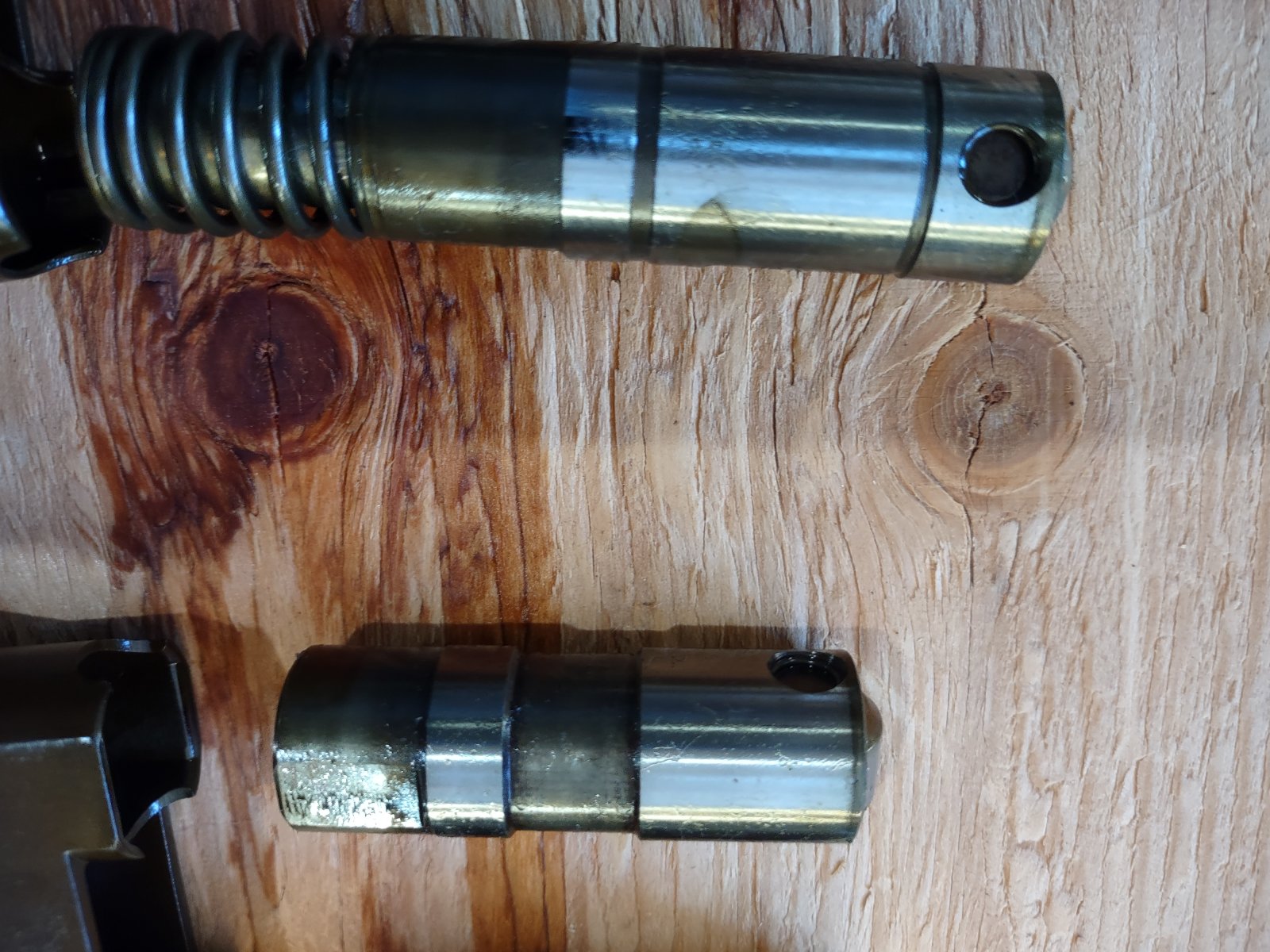

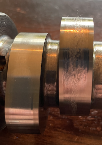

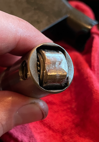

Welp. Lifter collapsed and quit. Might be doing an AFM delete now but not sure where to go from here
donjetman
Oct 22, 2018
1,987
3,641
Yes, may be the valve stem stuck in the valve guide, dropped valve seat, or broken valve spring. Hard to tell from that camera angle.

Here is a bandaid:
I’ve thought about this. Realistically how long could said bandaid help? I know it’s hard to tell but right now is definitely not the best time for me to have to do a tear down or AFM delete
Edit: the video probably answers this lol im going to watch it
thefrey
thefrey
Feb 3, 2025
415
466
while I think this is a worth while try for most and I'd totally try it on mine before taking it apart. if you look close at his first video. I think his valve spring is stuck down more than lifter stuck.
I might as well give this a try.
If I rotate the engine, would a stuck valve mean that the valve spring won’t move? As opposed to a collapsed lifter the valve spring will still move? I just wanna make sure I know what im looking for
