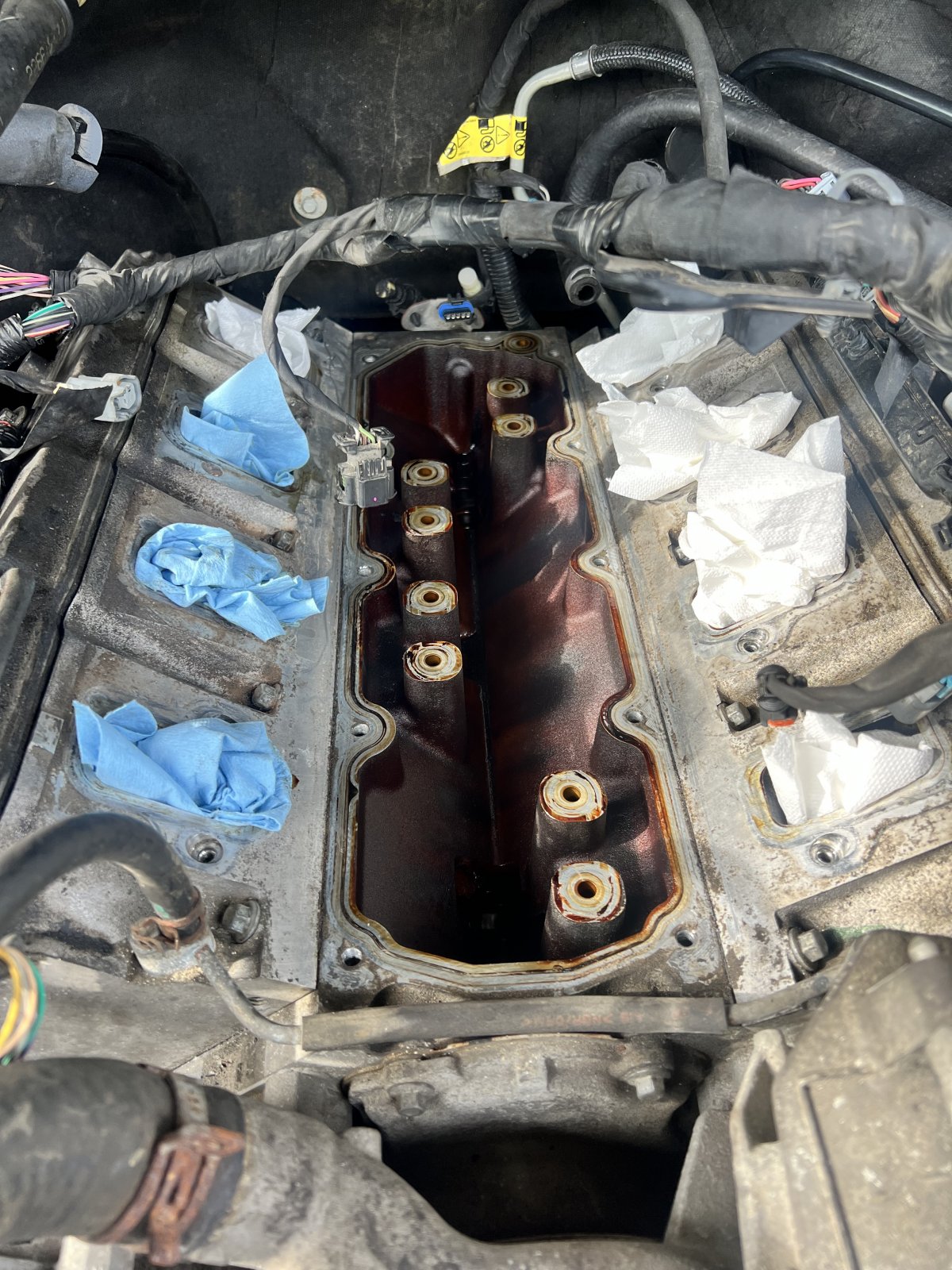

Did the rest of the teardown today. Planning on trying to free the lifter and then tune out AFM
Here’s a video of the rockers with a better angle of the valve springs. I don’t think the valve is stuck, I think the lifter is just collapsed

Yep that makes total sense.
Did the rest of the teardown today. Planning on trying to free the lifter and then tune out AFM View attachment 456835
from that angle, it looks a lot better.
hope you get it to release

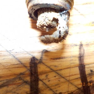

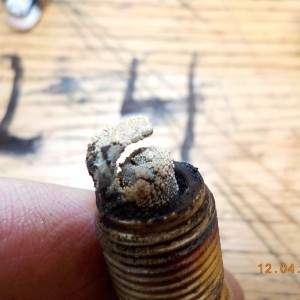

Not having done https://static.nhtsa.gov/odi/tsbs/2014/MC-10114272-9999.pdf causes carbon buildup. Ask me how I know.
That broken line is for the clean (filtered air) side of the PCV system. The break/leak allows unfiltered air (dirt) into the engine crankcase which mucks up the oil thus shortening the engine life.
