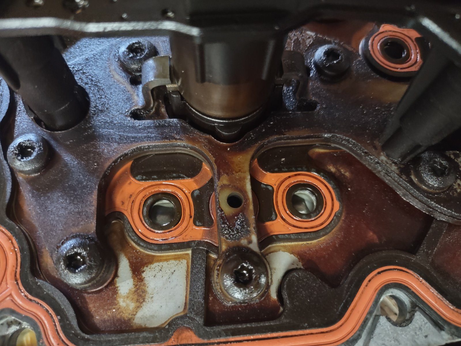

By the way, you'll see the eight towers with an oil port coming up through them when you lift off the VLOM. In an AFM delete, I plug those ports with steel plugs pounded in.
This is the underside of a VLOM that was bleeding off oil pressure. It ran for two oil changes on Valvoline restore and protect as an experiment to see if it actually cleaned anything. The clean spots are clearly where it was bleeding off oil pressure, and did a good job cleaning. The seal is that orange circle that goes over the oil port. Now when you find loose bolts you'll have a good idea.....

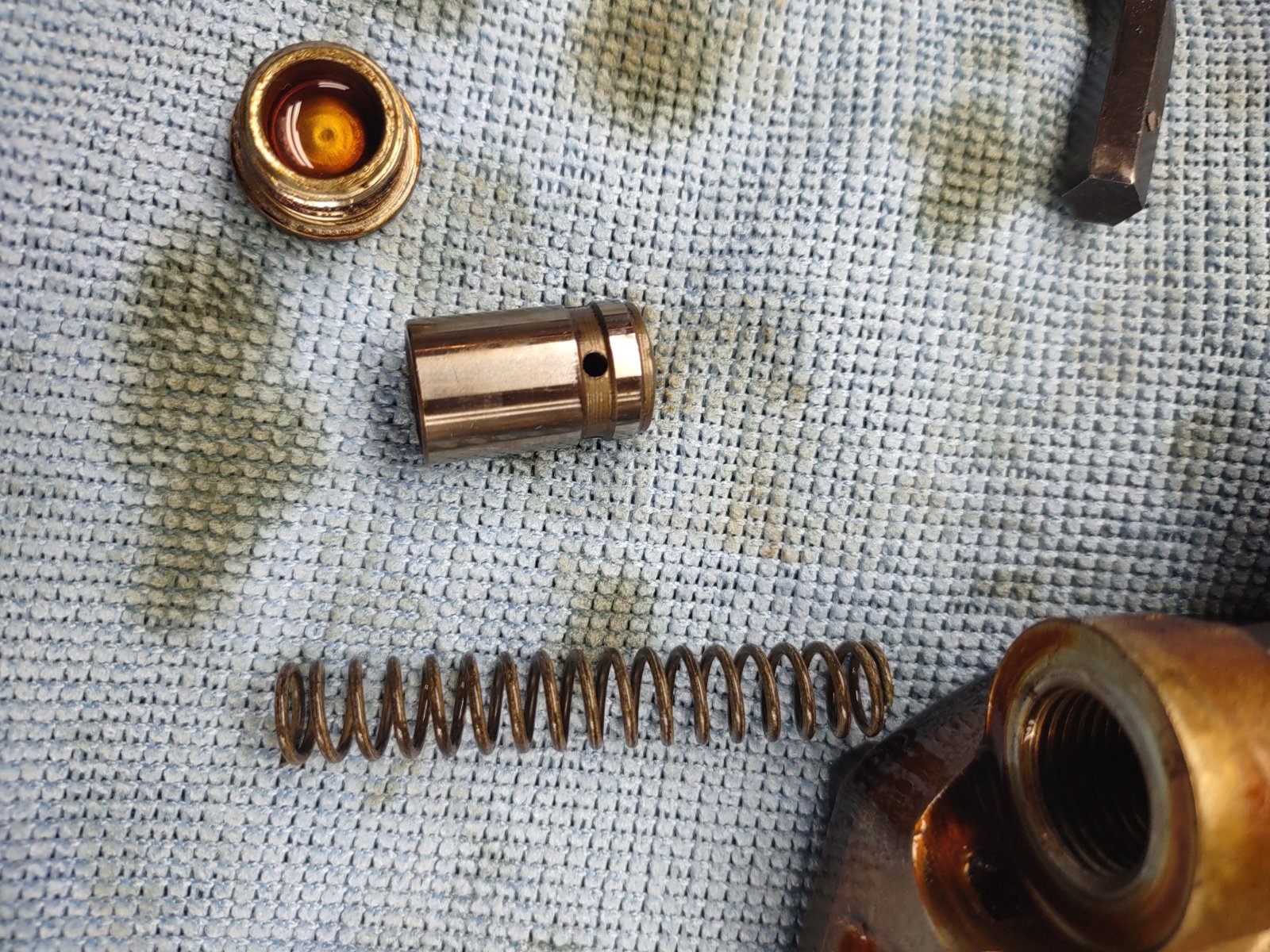

And when you remove your oil pump, take out the oil pressure relief valve and see if there's crud inside. Here's what the parts look like on an oem pump. Note the spring seems kind of corroded.
