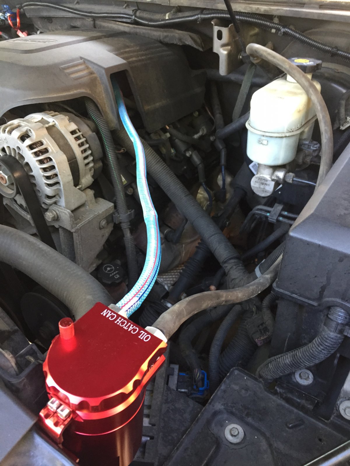

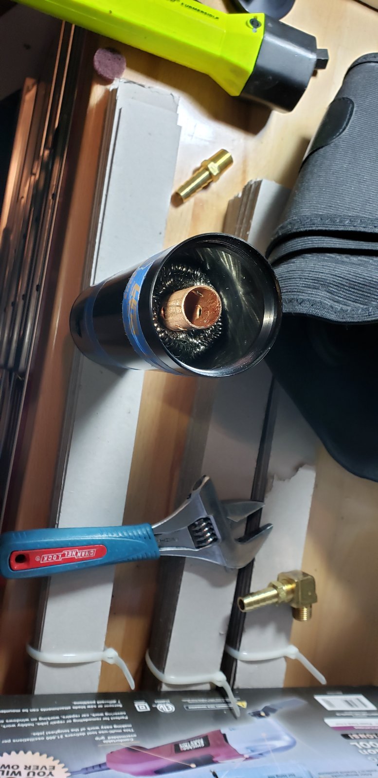

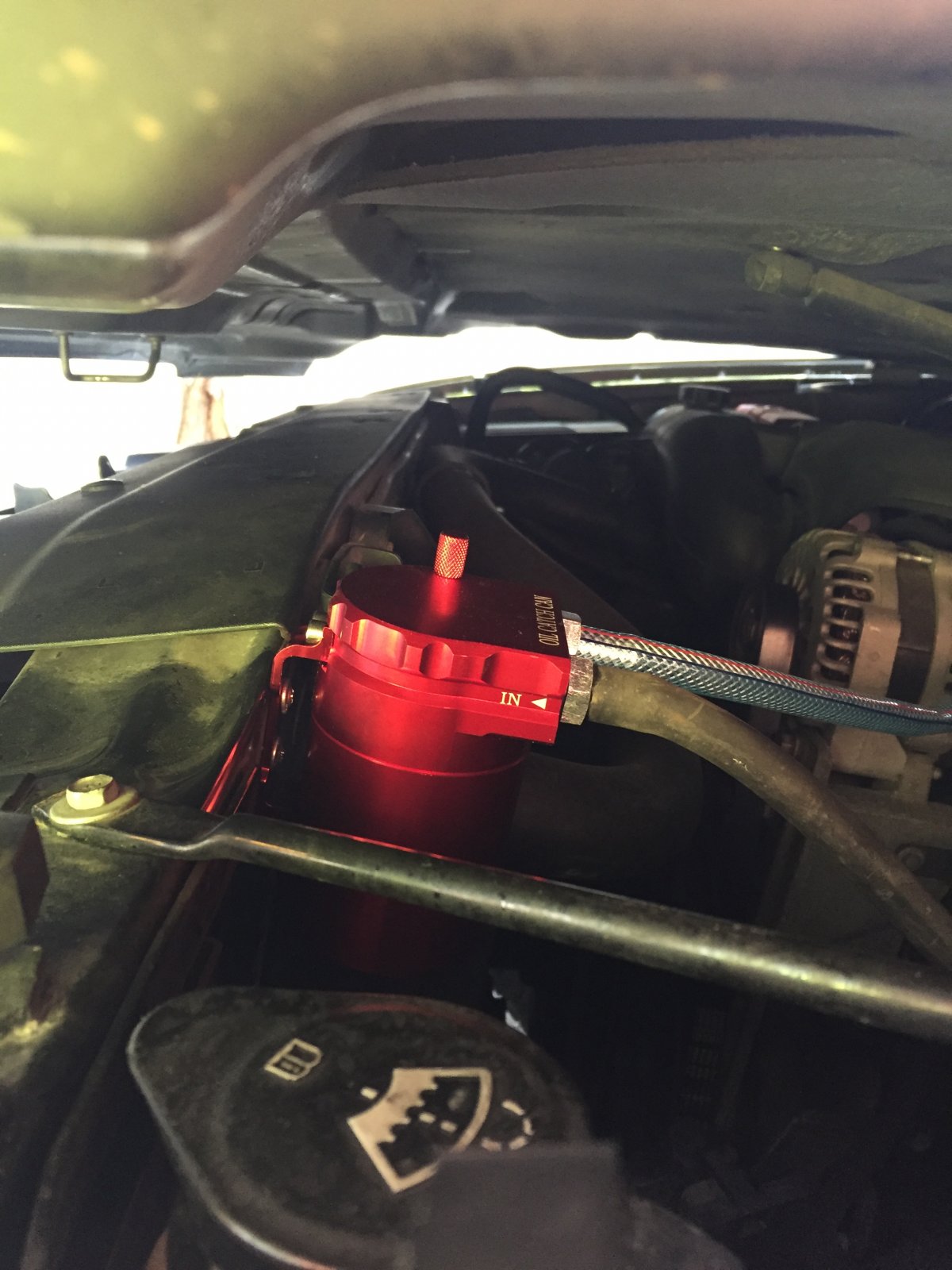

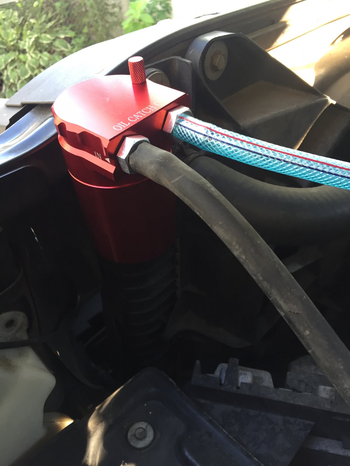

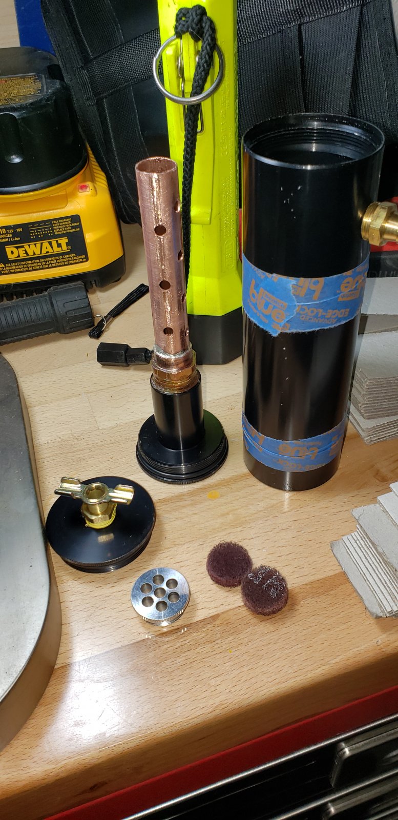

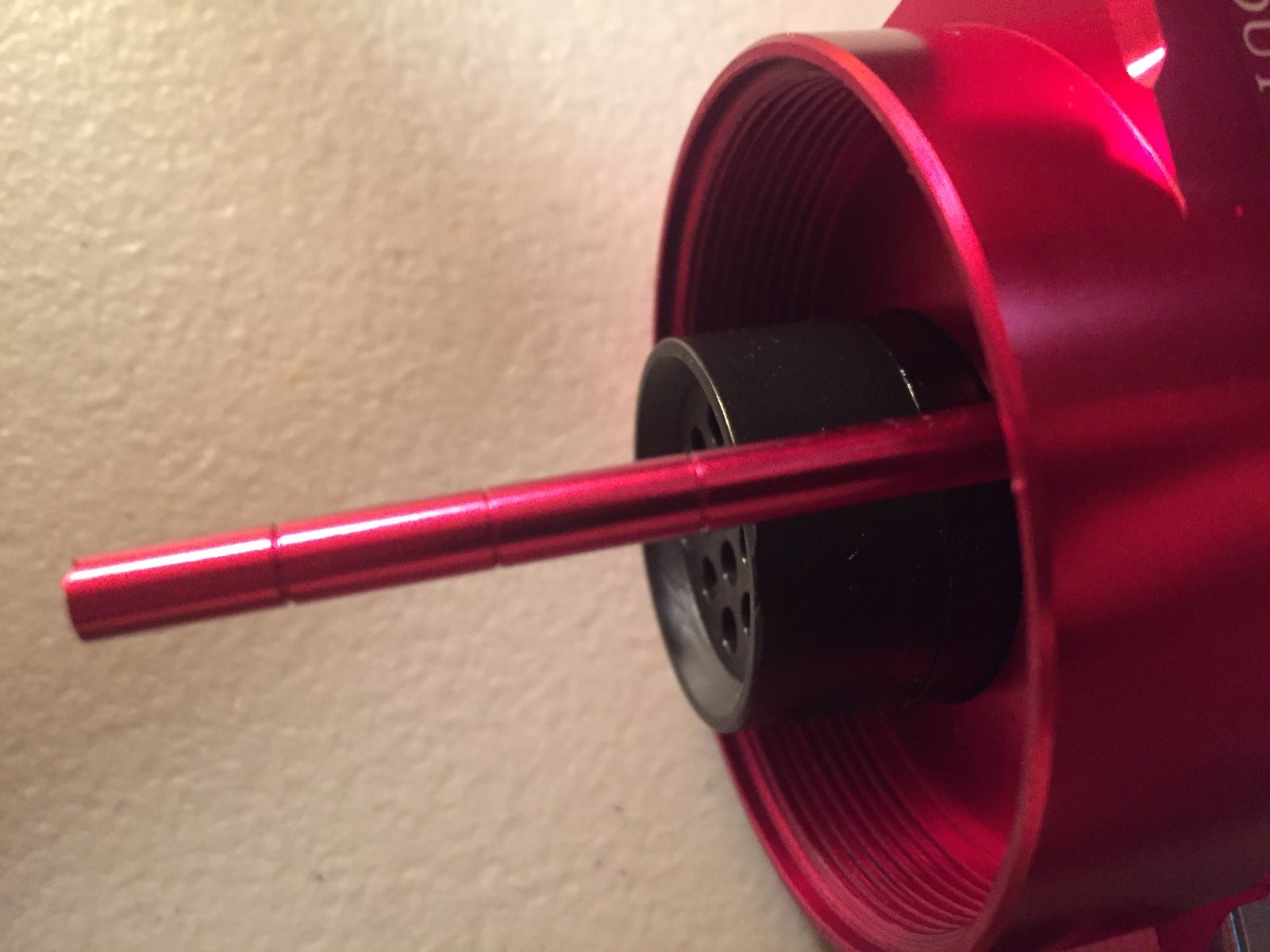

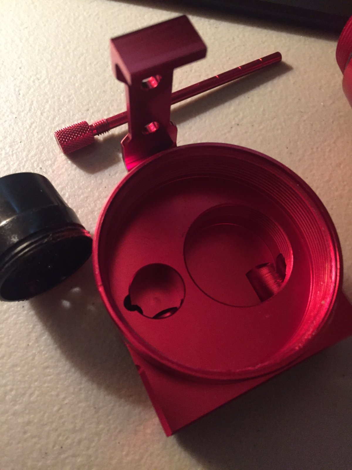

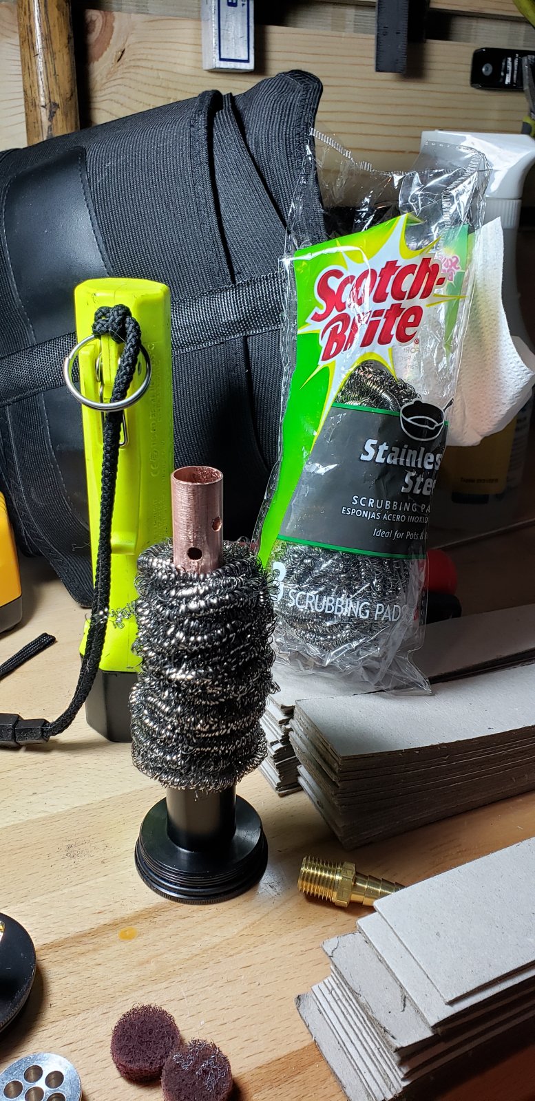

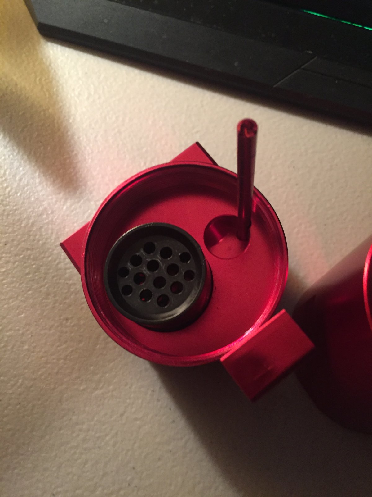

Just finished installing mine. The can from catchcan.com is not worth the money! I was highly disappointed when i opened it up and saw how close the dirty and clean ports were from each other. The filter media was also a joke...
Anyways, i modified it a bit with a 1/2 copper pipe and jb weld. BEWARE that copper and steel are incompatible! One or the other will start to rust. This is temporary until i can source some steel pipe. Probably from home depot.
I ended up with extra fuel line. Come smog time ill attach the piece of pcv pipe i cut off back

That's a nice mod. Good idea.

View attachment 227100 Just finished installing mine. The can from catchcan.com is not worth the money! I was highly disappointed when i opened it up and saw how close the dirty and clean ports were from each other. The filter media was also a joke...
View attachment 227095 View attachment 227096 View attachment 227097 View attachment 227098 View attachment 227099
I added one stainless scrub pad to mine as-is and never gave it a second thought. I like this idea. I consistently catch 3 ounces per 5K miles, so I'll leave space for that amount in the reservoir and fill the rest with more filter media (scrub pads).
*Searches stockpile for 1/2" aluminum tubing

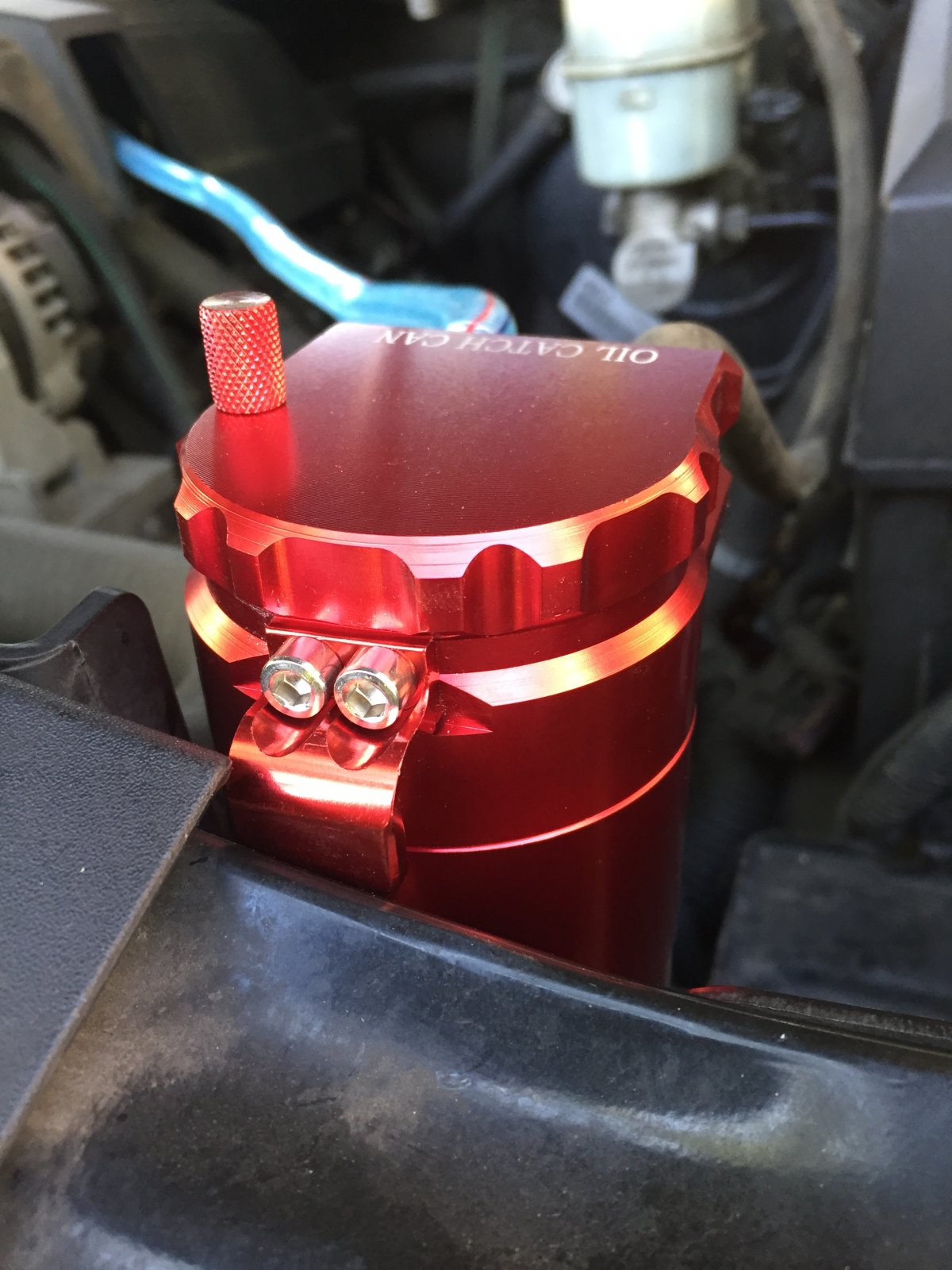

Anyone else find humor in the fact they thought it was necessary to put “OIL CATCH CAN” on the cap?

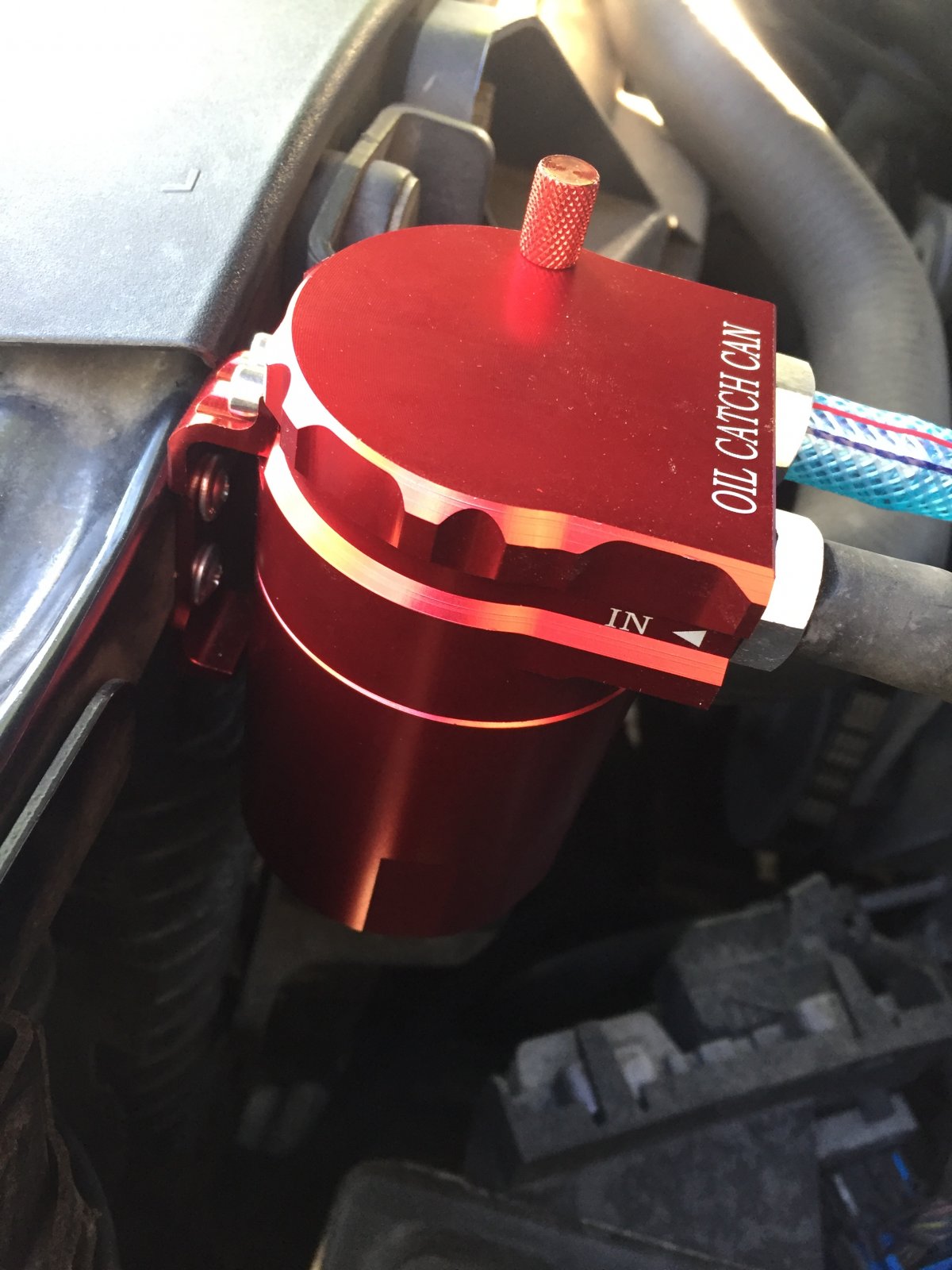

Is there any guidance folks can give for maximum length of hose between valve cover and catch can? Should a person worry about the hoses being long enough that the suspended vapors slow down and settle in the hose before reaching the catch can? If so, I would think you would want to avoid a saddle point where that settles out liquid can accumulate and cause a blockage over time, causing someone to 1) minimize the length of hose and 2) route the hose so everything either drains back to the valve cover or into the catch can. Am I overthinking this?
