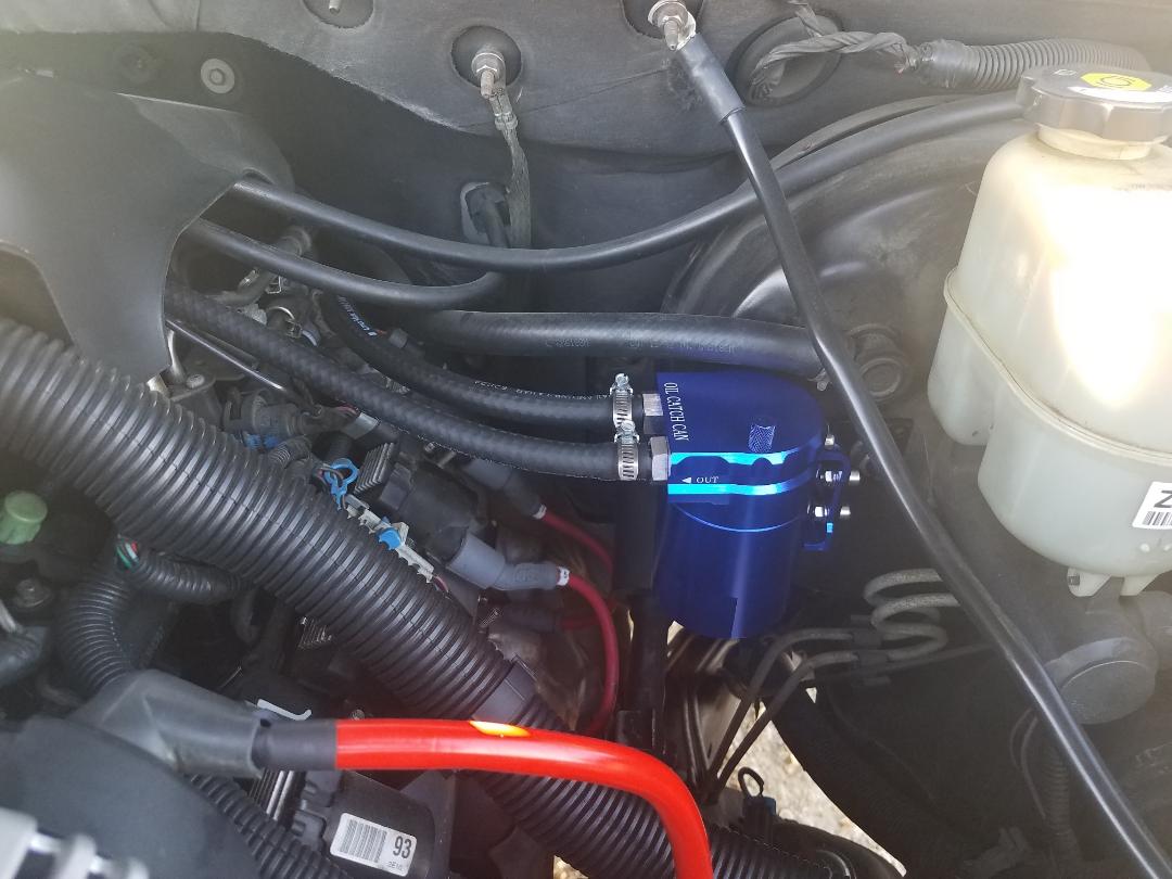

A few weeks ago I completed my camshaft and roller rockers upgrade and when I had the engine apart, I too found a good amount of oil in my intake manifold and a good amount of carbon build up on my cylinder heads. After researching this site and following several threads, I decided to install an oil catch can system. After determining my mount location this mod really did take only 20-30 minutes to complete. Completed the install yesterday. We'll see how this thing works. Thanks again to all who make this site the "go to" site that it is.
I am in the market for CC as well, going to need to mount it on the booster as well, no room to mount down by the alternator. which one did you go with if you don't mind me asking? Install looked great by the way.

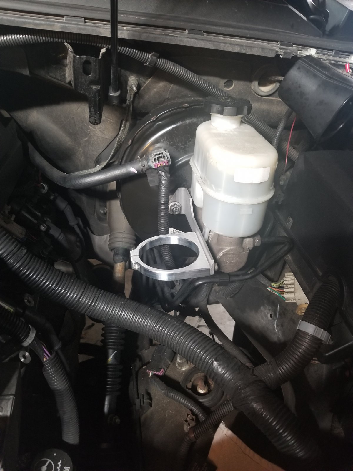

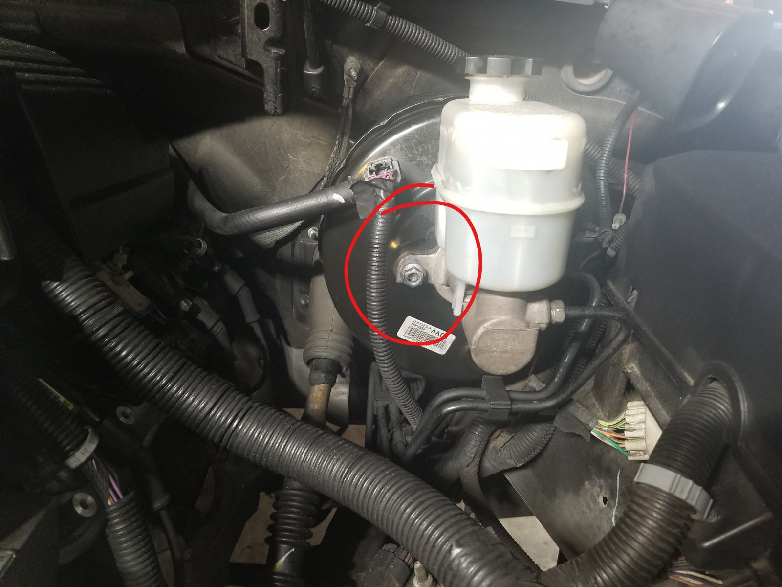

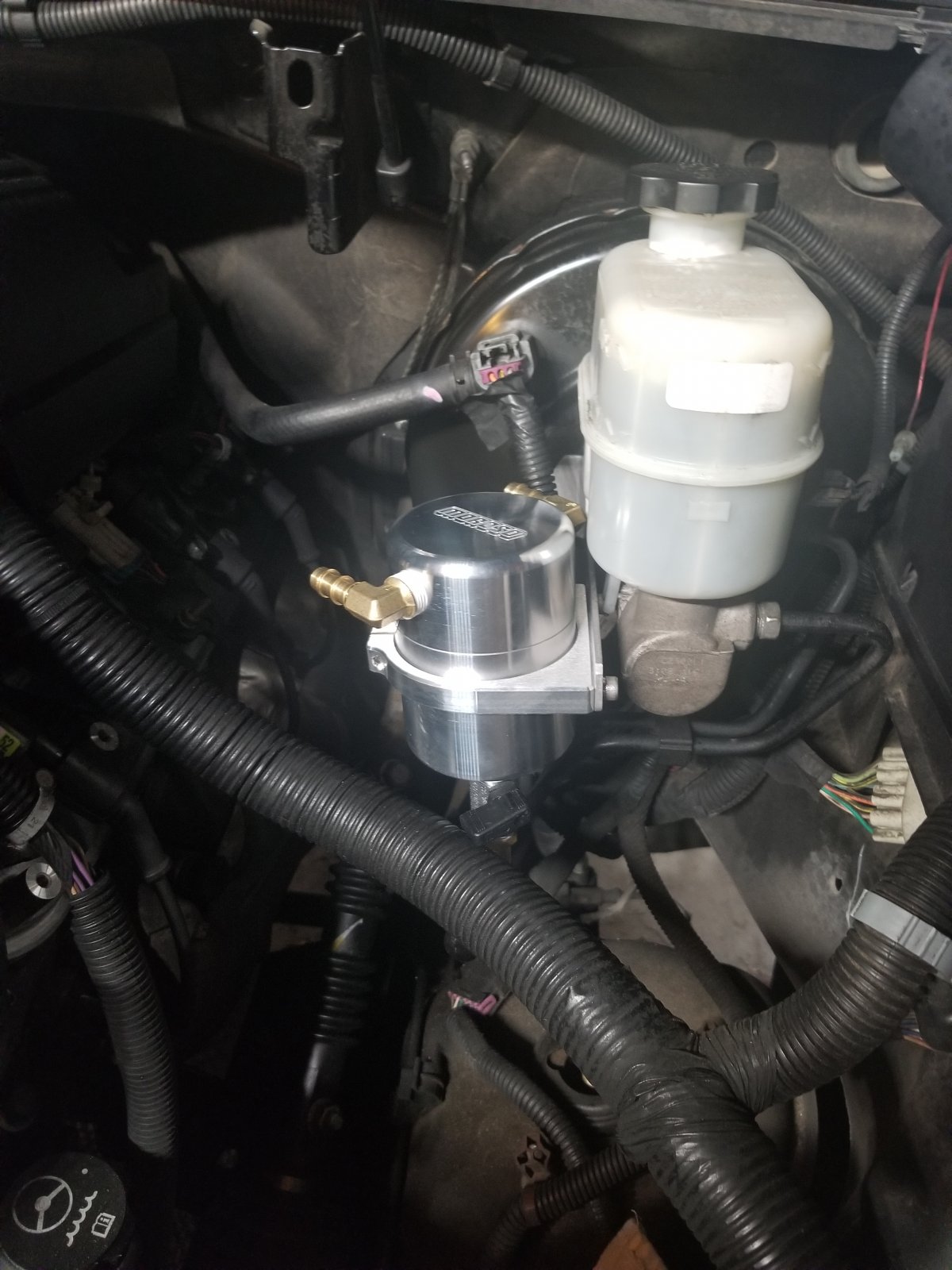

I am in the process of installing a Moroso CC on my 2013 ( good quality name brand, affordable ), I selected the brake booster location as well mainly because less vibration in that area. I will complete the install in a few days but I have included a couple of pictures to show you what it looks like so far.
I Finished the Moroso CC install and wanted to include the pictures of the install. I routed the lines around the back of the engine cowl so they woud be more out of the wayView attachment 268068 View attachment 268068 View attachment 268069 View attachment 268069
I went with the SPEEDWOW catch can. Very good quality with all the components with the exception of the attachment bracket. I used a stainless steel "L" shape bracket I bought at Lowes. Here is the link: https://www.amazon.com/gp/product/B07S4H2TFC/ref=ppx_yo_dt_b_asin_title_o08_s00?ie=UTF8&psc=1
