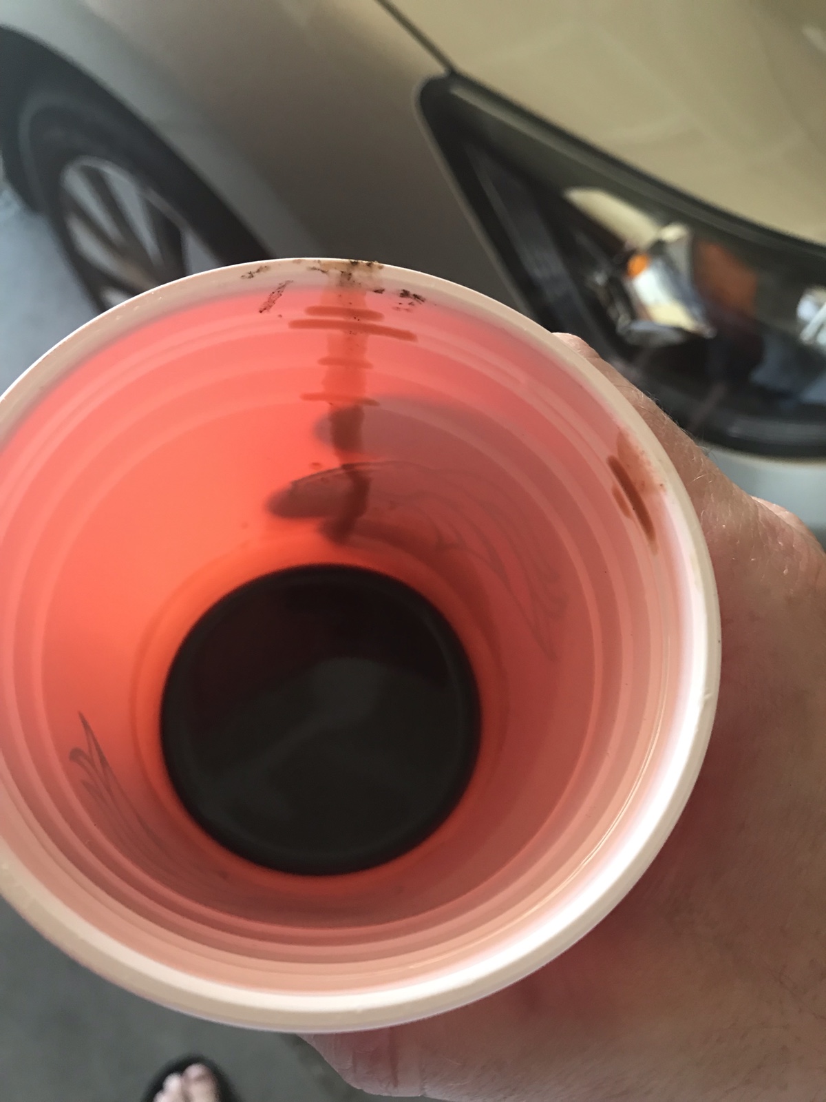

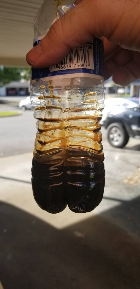

I didn't. I dumped it into a clear container and it was nasty ass dirty. So I disposed of it. As as far as I know this is all original. I could not find an updated VC for this model and year. 2007 5.3 Tahoe LT 4WD.
On the plus side, you know your catch can is working and kept that crap out of your intake.
Were you doing a lot of heavy driving?

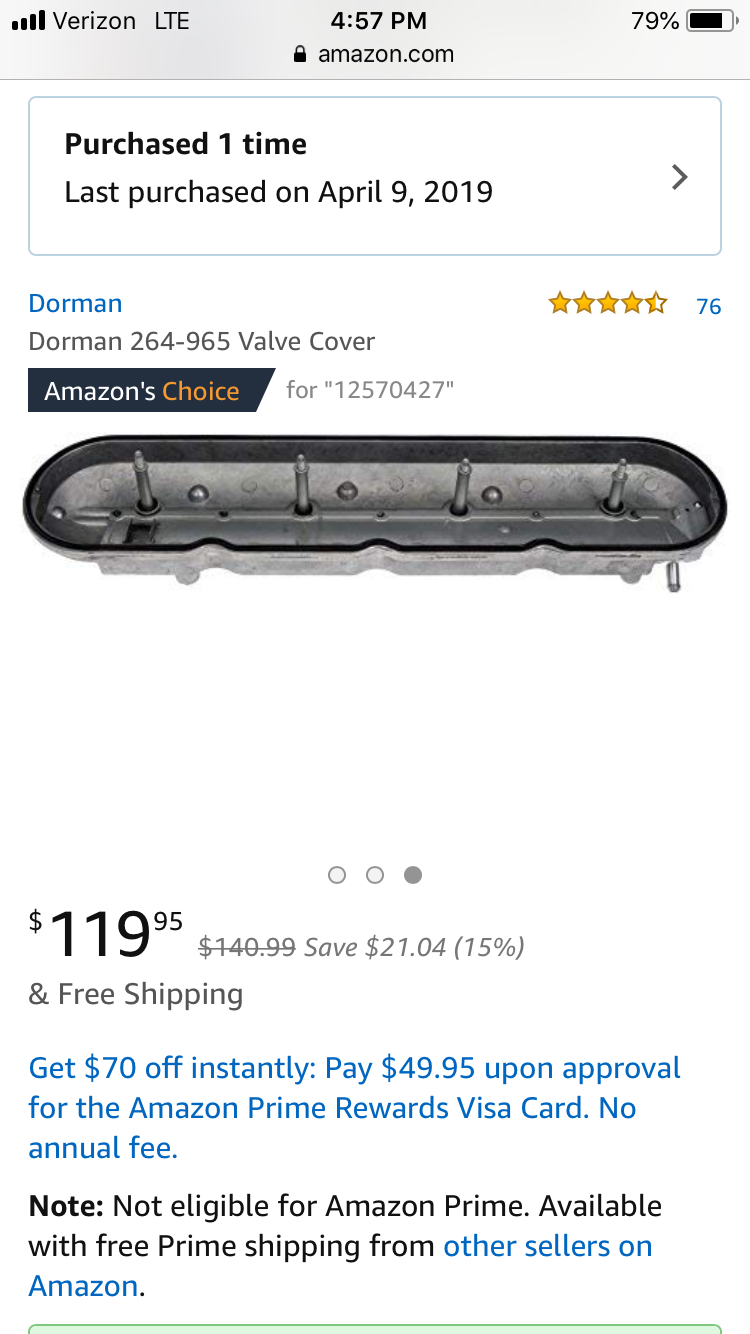

I put a genuine GM VC# 12570427 on mine, from amazon for $111.
The TSB says to install valve cover # 12570427 on 07-08, and valve cover # 12642655 on 09 and later engines ONLY. There is a *NOTE* stating "These rocker covers are for specific years. The PCV orifice is different for each. The correct cover must be used or an SES light may set". There is a lot more scary info in it. I suggest you read it thoroughly.

Yes apparently it is working very well. I baby this rig as much as possible.
89Surburban, you obviously need the valve cover, and you should probably do the rest of this Technical Servive Bulletin - TSB# 10-06-01-008M .I did it to my engine and it all is well now. I catch 1 oz every 6000 miles now. Before I did it, I was collecting 1 oz every 100 miles.
https://f01.justanswer.com/ebrock63/cec66346-04c1-48e0-98a6-74c35af2c84e_2014+Engine+-+Oil+Consumption,+MIL+ON,+Engine+Runs+Rough.pdf

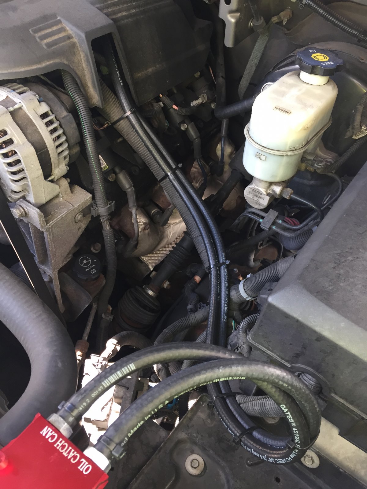

On a positive note here is the new hose routing pic:

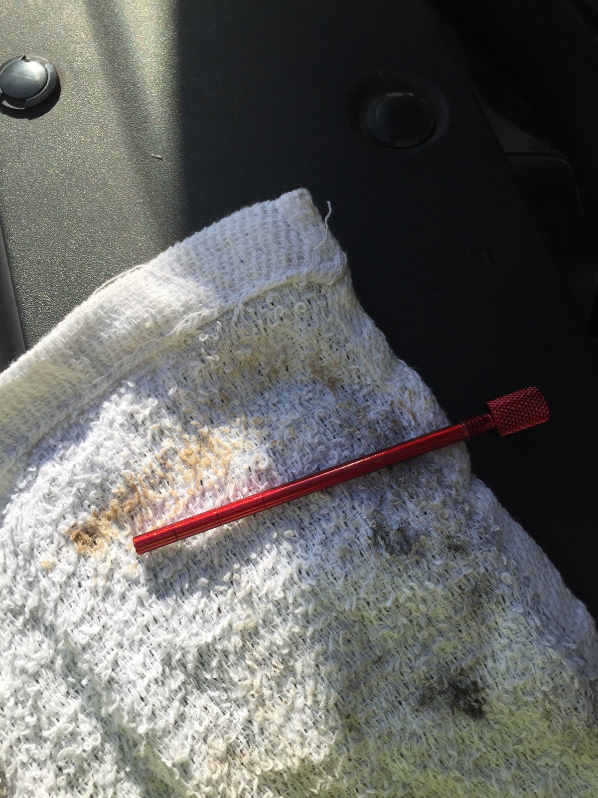

And I did a swab test of the dipstick on a rag to see what kind of residue it left behind:

How do you have it plumbed? Input of catch can runs to where, valve cover or top of intake?

It is plumbed correctly. Inlet to PCV on VC and outlet to intake manifold.

Hose reroute looks good, man
