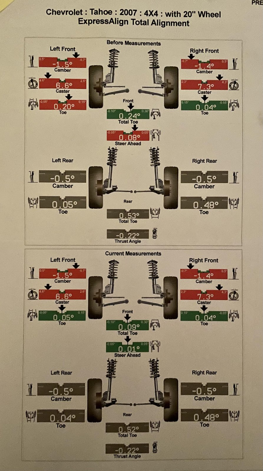

So after doing a 3/4" Belltech drop kit I had the truck aligned. Even with the 2* camber bushings pressed into the UCAs, I can't get any better than -1.5* of camber (on each side). That's not even in the normal range. On top of that the caster is WAY off, like 7*, but I don't care about that too much. Toe aligns correctly (thankfully) so tire wear shouldn't be too bad.
Do you guys a camber of -1.5* is going to cause any major issues? I'm kind of fed up and don't want to throw more money into this project. For a 3/4" drop this is causing me a lot of hell. And all my control arms are new BTW (nothing bent)!

-1.5° camber will eat the inside of the tires. Alignment specs call for 0°- 0.5° negative camber.
Not sure which drop kit you have. Did it come with drop spindles?
The 2° bushings aren't needed if you are using drop spindles.
My 4/6 dropped Burb aligns perfectly with just the 1° camber plates.
My guess is the bushings weren't installed in the correct orientation.

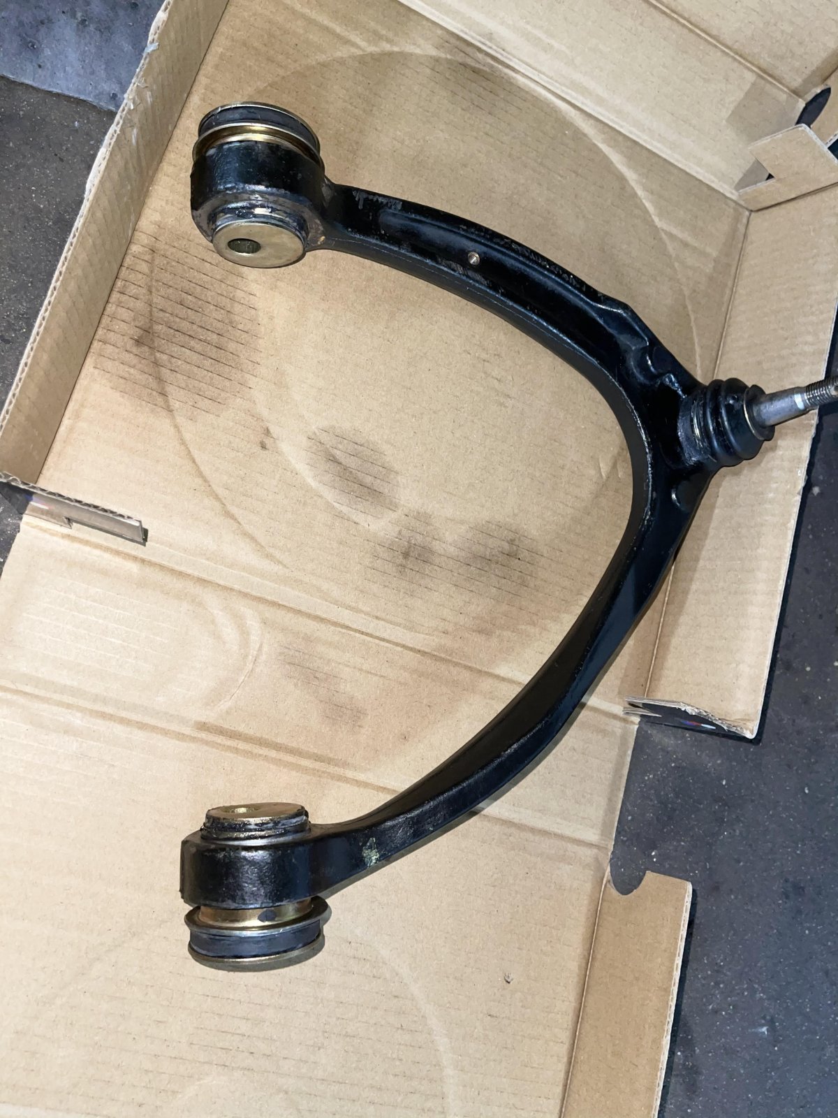

I do not have spindles. This is via "drop struts" entirely in the front and 4" drop coils in the rear. All Belltech stuff, from a kit (738SP) that includes the eccentric camber bushings.
I had the shop send me a pic of the bushings before install, and they are correct. You can verify that below.
Below is my latest alignment printout. The guy at the shop said that negative camber doesn't wear tires much -- toe is more responsible for that. Not sure on that? Regardless, that much red on my printout doesn't sit well with me.

The alignment guy is mistaken and should not be saying that. He is saying that because he went as far as he could with adjustments and wants the rig off the alignment rack.
Too much negative and positive camber WILL wear tires, period. So can too much toe in and toe out. That is alignments 101.

I'm not sure what to tell you.
I am curious how you get 3" of drop out of 2" drop struts?
The Belltech struts are good for 2" of drop with no rings installed. So to get 3" you would need shorter springs or a dropped spring perch to get the other inch. Or I suppose you could mount the struts below the lower control arms, with grade 9 hardware, and then set the struts for a 1" drop.
My truck had 2" spindles and I had the drop struts set at 2" of drop, zero rings on the struts, and I only have the 1° camber plates.
If you take out my drop spindles then I would have effectively had a 2" strut drop and the 1° camber plates had plenty of adjustment.
I would perhaps take it to a different alignment shop and see what they say.
