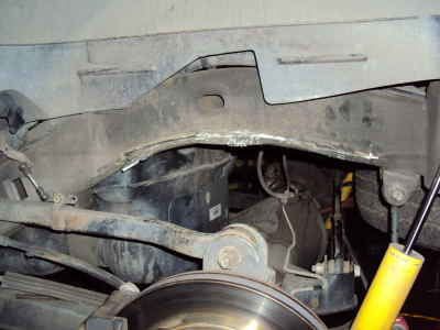

Finally got around to removing the factory bumpstop bracket on my truck and damn it was a pain in the ass. Here is the factory configuration:
With bumpstop cut out via sawzall

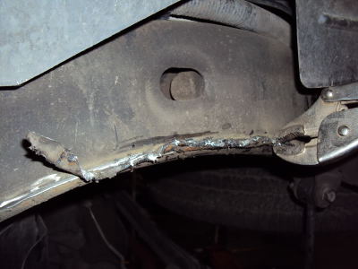

Bit of grinding and elbow grease

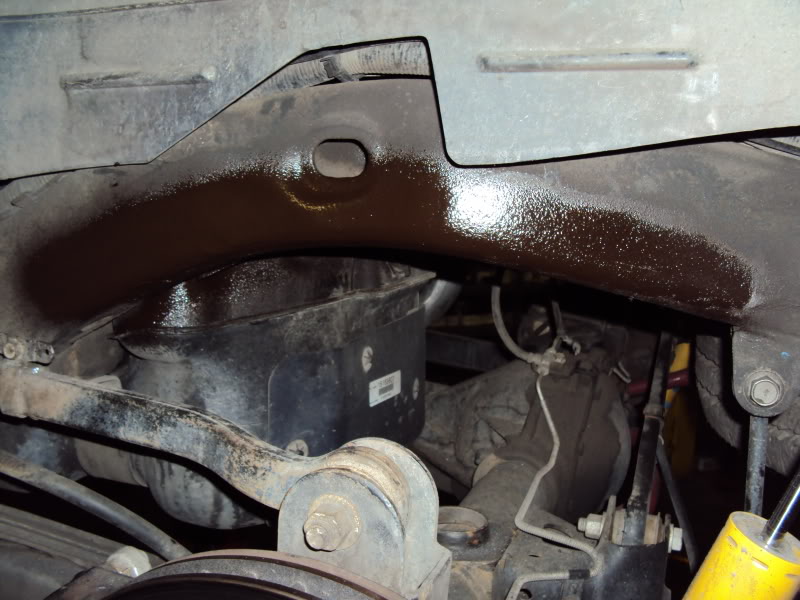

Final product with rubberized undercoating
I am now able to drop the pressure in my helper bags to 2 or 3 psi and the truck rides just like it did stock. I plan to add a pair of lower profile bumpstops at some point though the bags do an excellent job of stopping the travel. Kind of a pain in the ass to do the mod but completely worth the effort.

So does this allow the suspension to travel a further distance under compression? What part of the truck actually comes in contact with the bumpstop?
