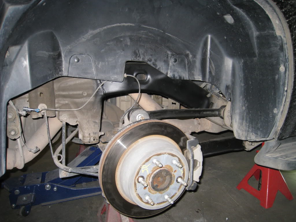

I did my girls Tahoe a few weeks ago:

really clean looking red. need to do mine now that i got shocks, im sitting on the bumpstops in the rear. Got to find someone that will do it for me. (no tools)
