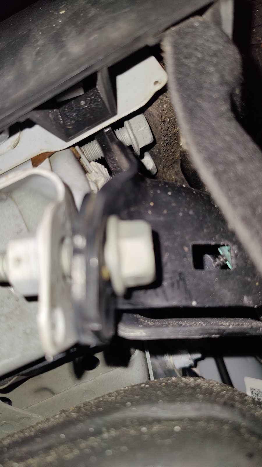

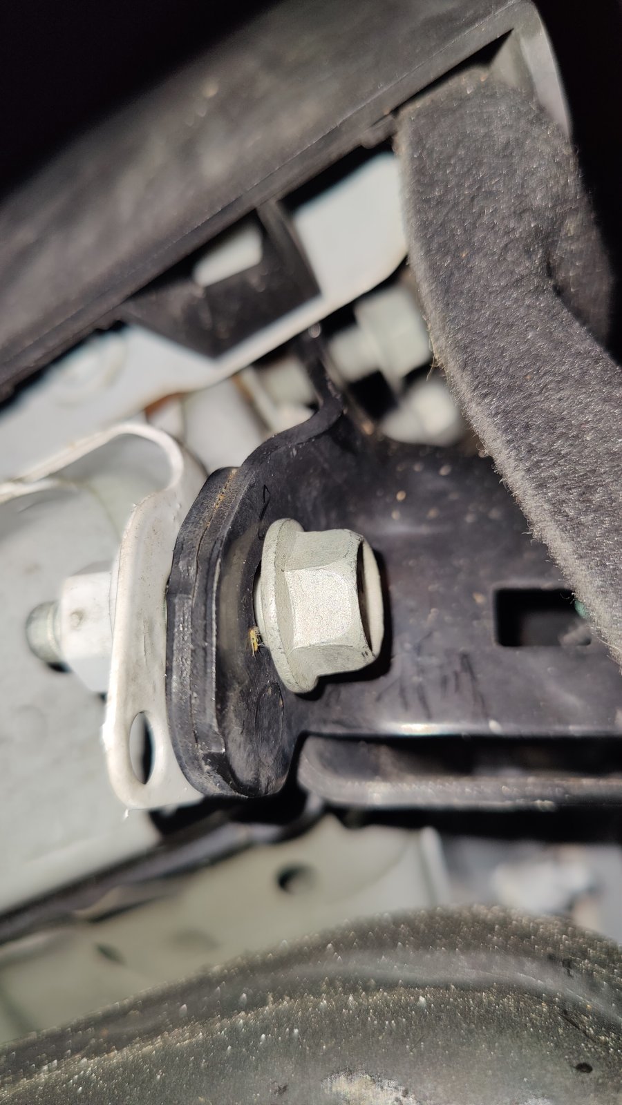

On a side note, once the repurchase was approved, I did trouble shooting on the Tahoe. My wife drove and laid the passenger seat flat and stuck my head under the glove box. The rattle was coming from the lower end of the A-pillar. Used a rubber mallet to replicate tapping on the a pillar and discover a loose screws at the end of the running board. Removed the fender liner on the passenger front wheel and noticed that the bracket that holds the front side of the running board was complete unbolted from the factory.
So basically, when you hit 80 mph or above, and the grill louvers shit to increase aerodynamics, the air gets rerouted to the fender vents. The air going through the fender vents makes the fender liner vibrate. The fender liner vibration makes the loose screws rattle causing the rattle sound to travel up the A-pillar. Sucks dealer didn't try. I tightened the bolts and the rattle went completely away. The dealer could have easily done this, but they don't get paid to diagnose issues. And I'm sure they get paid nothing in wrench time to tighten a few bolts. Sucked. I'd of kept the truck if they'd fixed it.

They refused to even ride with me with me driving. I'll take the ticket. But they just weren't having it. But in the end, the issue could have been found by just a visual inspection on the underside of the front right quarter panel. They never did.
