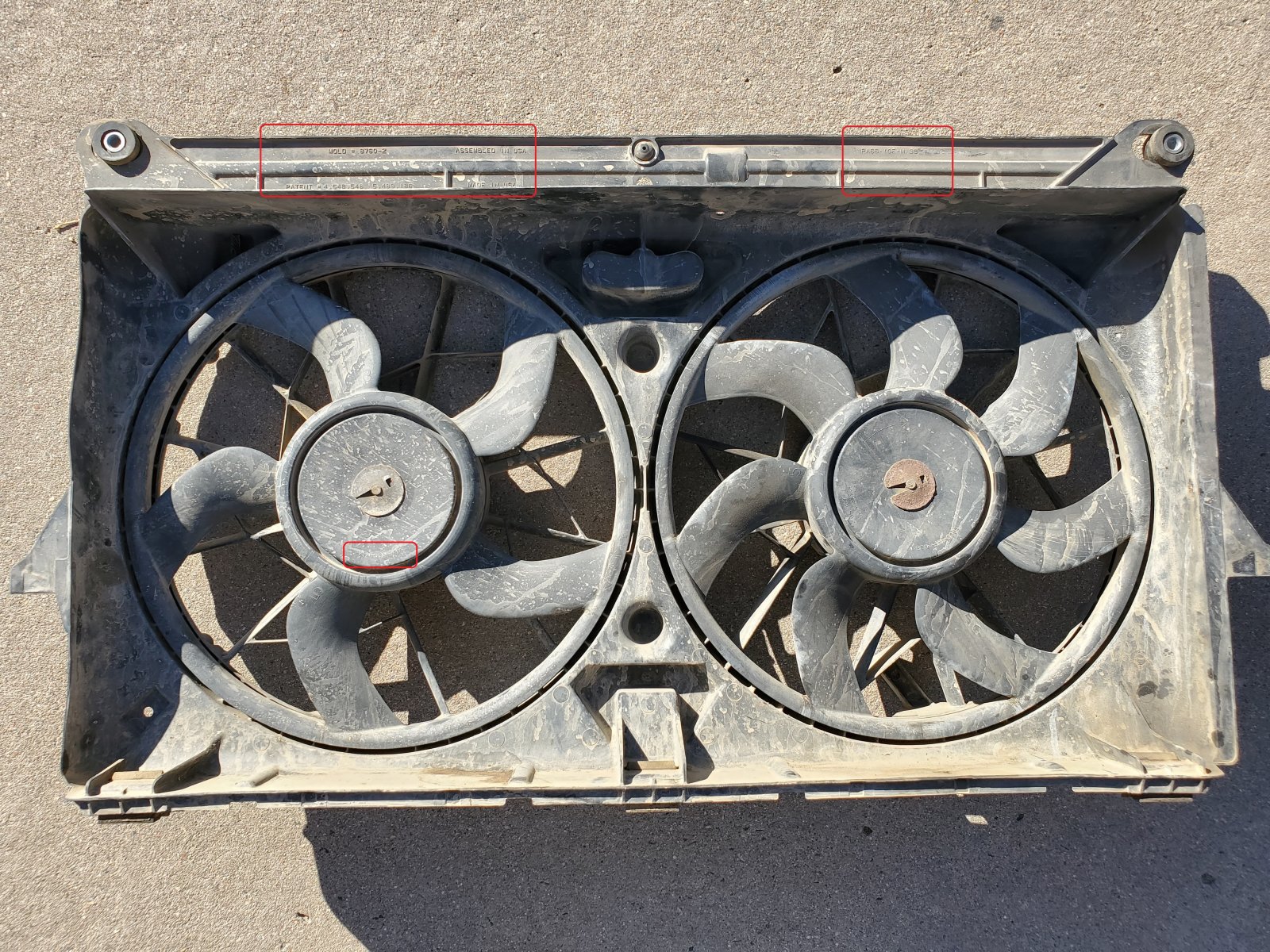

Here's a pic of a 2005 OE fan, with your classic 5- and 7-blade fans. I've put rectangles around where most of the molded-in numbers will be (don't miss the numbers on the motors). There is another large 7-digit number on it but I don't recall where it is. Might be on the other side or one of the edges.
As you view the pic, "up" is up, and you're looking at the side that mates to the radiator.
@Sam Harris look familiar? Although I did clean them up after the pic... ;)
