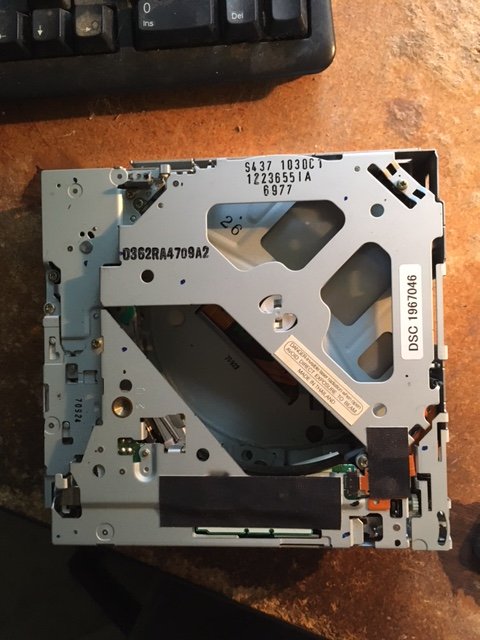

Does anybody know who makes the CD unit in the GM 10359577 radio in my 2004 Tahoe. Also is there a model number for this unit? I took it out of the radio to take a closer look, but don't find anything. Googling any of the numbers on the CD player doesn't do anything. I am trying to find out if I can find a new unit somewhere because the old one is not working. Attached is a picture of the CD player.

DDG.AI says Delphi/Delco for standard units and Bose for upgraded units...
"The GM‑branded 6‑disc CD changers used in 2004 Tahoes were supplied by Delphi (formerly Delphi Automotive / Delco Electronics) — Bose provided the premium-branded systems, while Delphi/Delco made the standard GM OEM units."

I once took apart my 2002 Bose 6 CD Changer when it wouldn't work. I found that spot lubrication was all that was needed. It was an exceptionally intricate disassembly and reassembly particularly because I took apart more than I needed to. That required me to re-index part of the reassembly.
