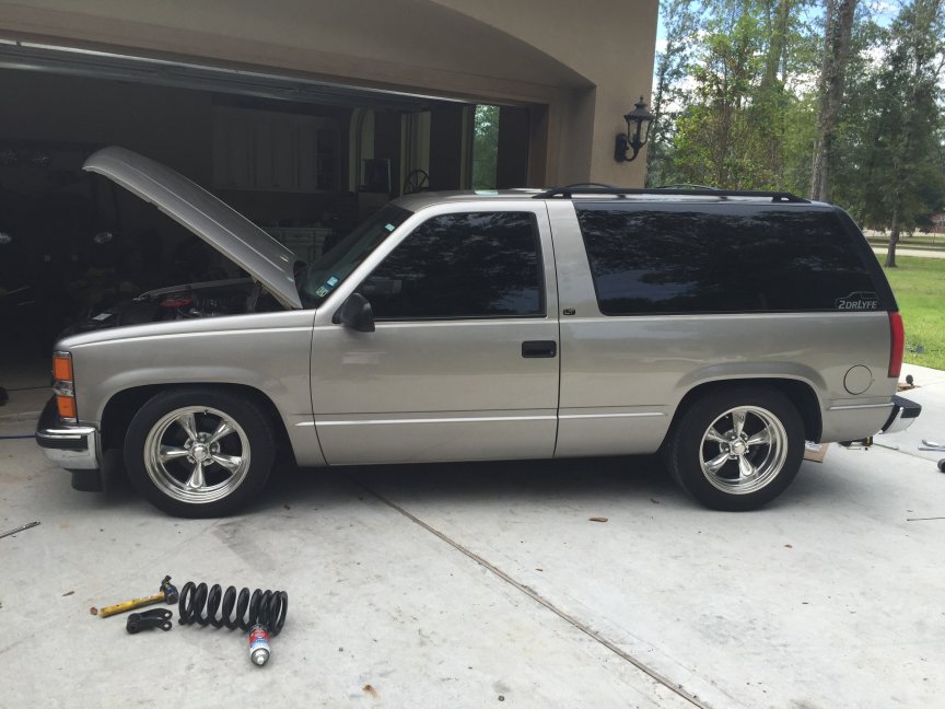

Went ahead and added the 2" springs and a 1" shackle out back.
Getting a notch this weekend and then will ad a 2" shackle to make it a 4/5.5
Rides surprisingly well. Shock extenders made a huge difference.

So final parts list to get it to this point
Belltech
2" Spindles
3" springs set at 2"
3.5" drop leafs
1" shachle
DJM
Shock extenders ( they are not the right ones but i made them work)

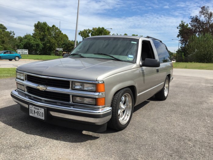

American Racing Torqe Thrust 2
18x8 and 18x9
The front has settled and I thnk with one more inch of dropout back it will be the perfect rake on it.
