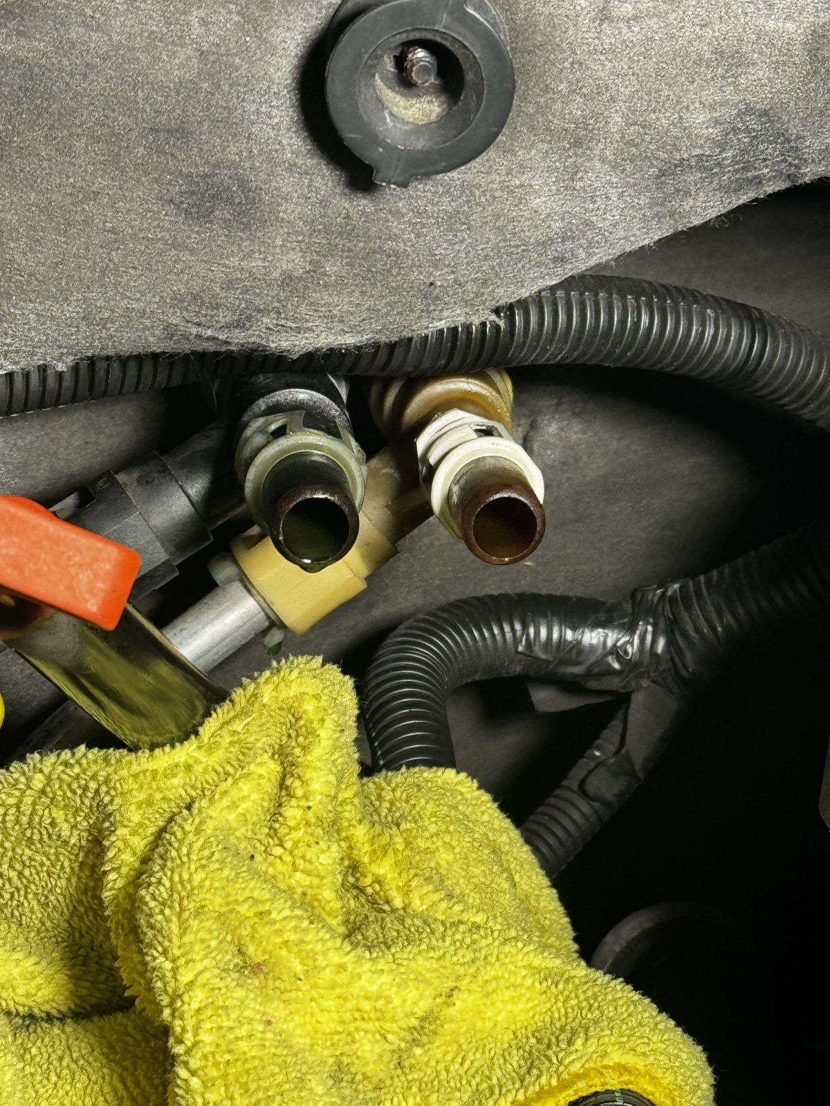

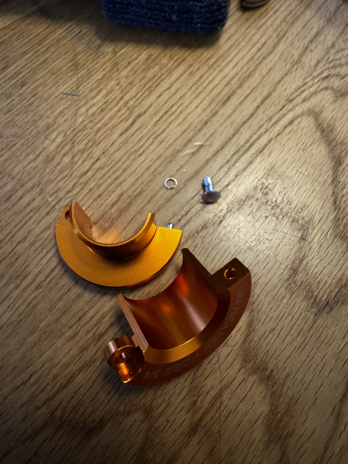

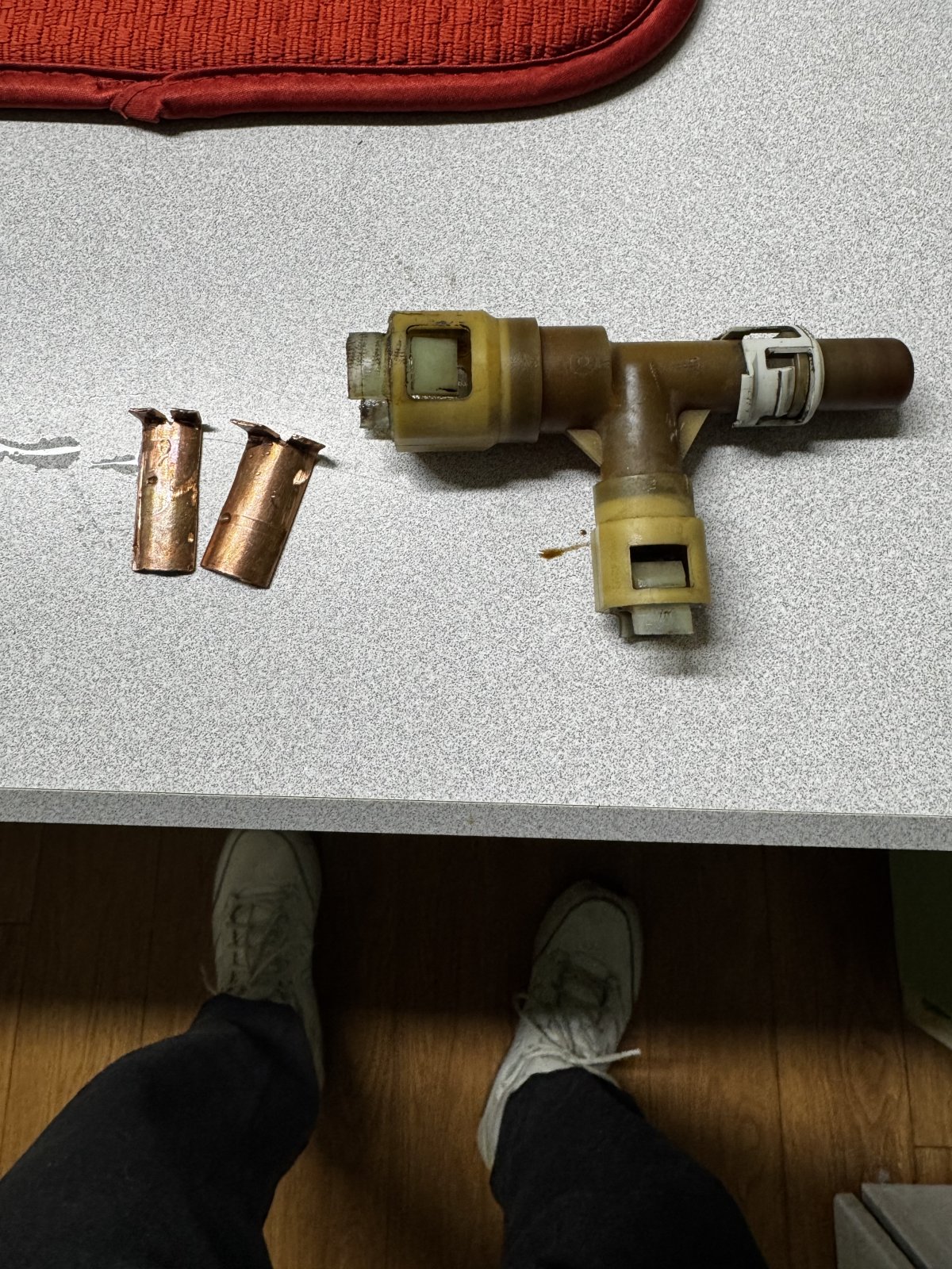

I started this project because I had a bad thermostat. I replaced it with an AC Delco only to have the brand new one fail out of the box. I also replaced the AC belt, water pump, thermostat housing and fan clutch when I did the first thermostat. Not only di I have this one fail twice My 2002 jeep WJ failed stuck open after replacing it only a couple of weeks before this one so lightning does strike four times in the same spot!!!!! Symptoms in both vehicles was no heat. I still don't have rear heat in the Yukon but that is going to be another post. I bought what I thought was the correct tool (upgraded to aluminum) that slips under the clips on at the end of the T fittings. Didn't work out so well. The rivet holding the two halves together fell apart immediately so I used safety wire and to hold it together and tried again. It was not long enough once under and into the clip.

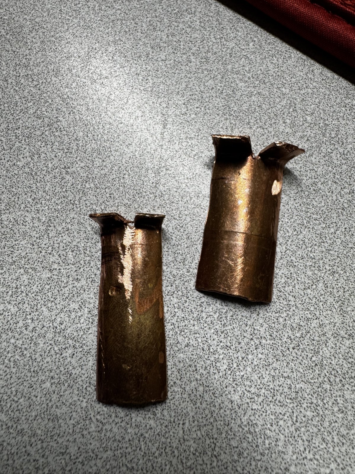

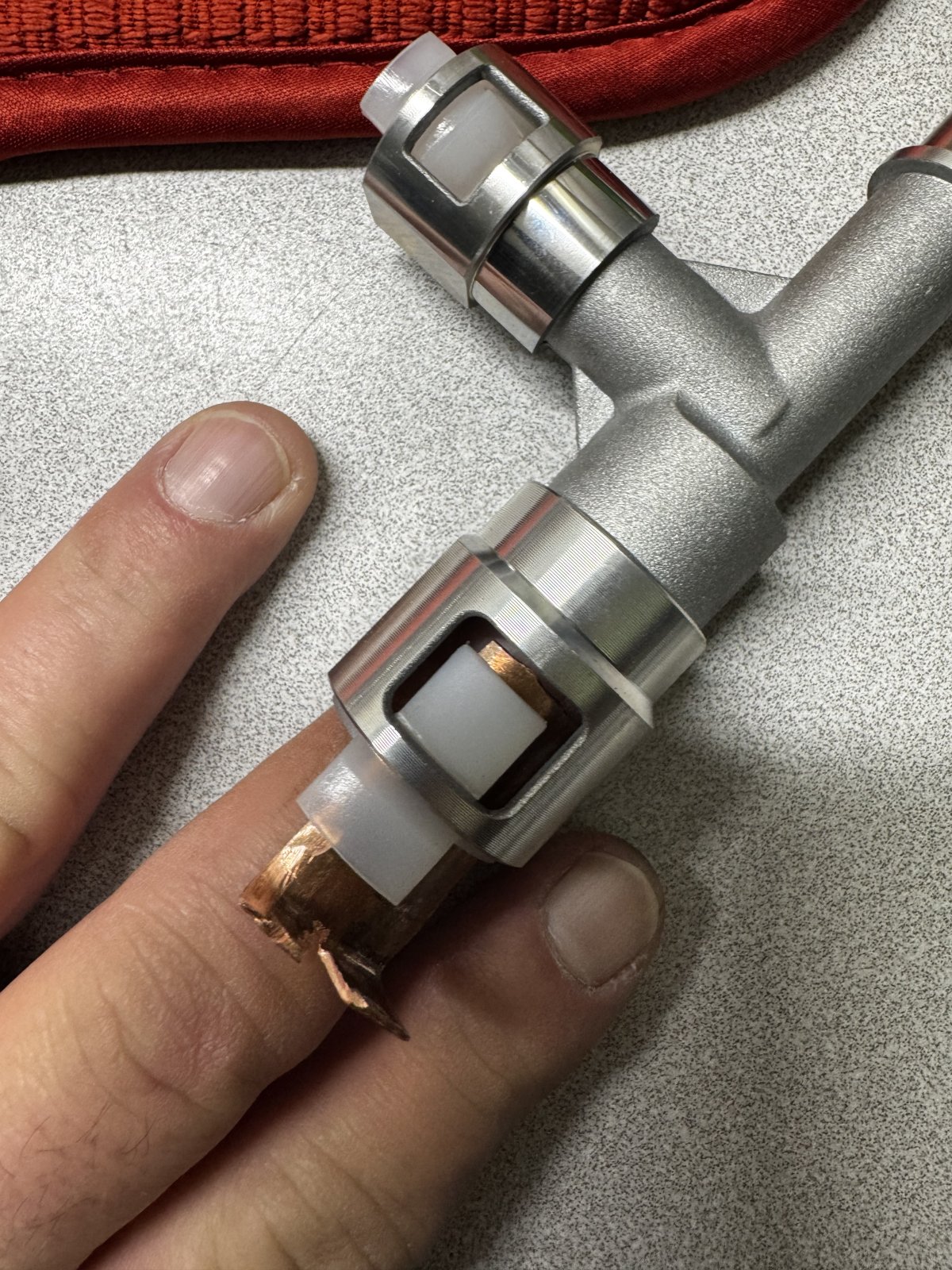

I spent and entire day in the cold garage (bought a propane heater) trying to get these fittings off then called it a day very frustrated. After sleeping on it I came up with an idea that I hope helps anyone that will have trouble getting these tittings off the Heater core tubes. I went to home depot and bought a 3/4 copper pipe coupler cut it with my dremel tool ad made tabs on the end in order to have something to hold onto with my fingertips and it worked.
You may have to tweek the radius a little, I did this by putting it in a vice. It really depends on the width of the piece, one I made was a little narrower than the other. If anyone has any questions feel free to ask, I will do my best to answer and help. PS I flushed the entire cooling system, front heater core, rear heater core, engine and radiator with some hoses I made up. If anyone is interested in the hoses I can post some pictures of them as well. On the initial flush of the front heater core a Large chunk of rusty something came out. The car is an 04 with 93K on it.

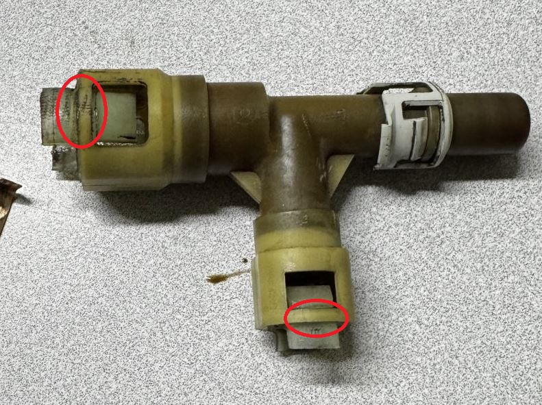

Yes, I struggled with those Tees, as well. I cut the tab retainers, as @Doubeleive suggests above, and I was able to remove the Tees. This method definitely works.
Then, someone on this Forum suggested the following:
"Push the Tee further onto the pipe, turn/twist it a little bit while pushed in, then depress the tabs on the Tee, and with a twisting motion, pull the Tee back."
This really works, most of the time. (I never thought of twisting during the removal attempt.)
When you change out the tees, be sure to wear gloves, as the firewall insulation is quite aggressive, and your hands will itch for days.
30,698
48,333
pushing those tabs does absolutely nothing when those clips have melded to the pipe for years, they just bend on the outside
might work for ones that are not that old or maybe have spent there entire life in a mild climate, try it on a 15 year old vehicle that has never been done...and has been in a hot climate.
for one the black plastic and the white plastic "tabs" are different types of plastic, the black gets brittle and or deteriorates/deforms, the white plastic softens & deforms
so the final word is "GOOD F-IN LUCK" if they do not just pull off, save yourself a headache and cut those tabs off.

and anyone could save a whole lot of time, money and frustration by simply cutting these plastic tabs (both sides) with a good set of needle nose pliers, they are usually brittle anyway by the time there done and basically snap right off.
I did think about that however I was thinking to use a dremel tool and it would have been kind of awkward. I like your way much better. I struggled with the idea because I figured the rear hoses would have to be cut first and then removed so you could rotate the fitting to get to the tabs on the tubes coming out of the firewall. There isnt much room to pull the rear tubes and once they were removed I wasnt sure if I could rotate one of the fittings with them both still attached to get at the tabs on at least one. I do like your method, I just wasn't seeing it at the time. Thanks!!! I am hoping I never have to do this job again lol

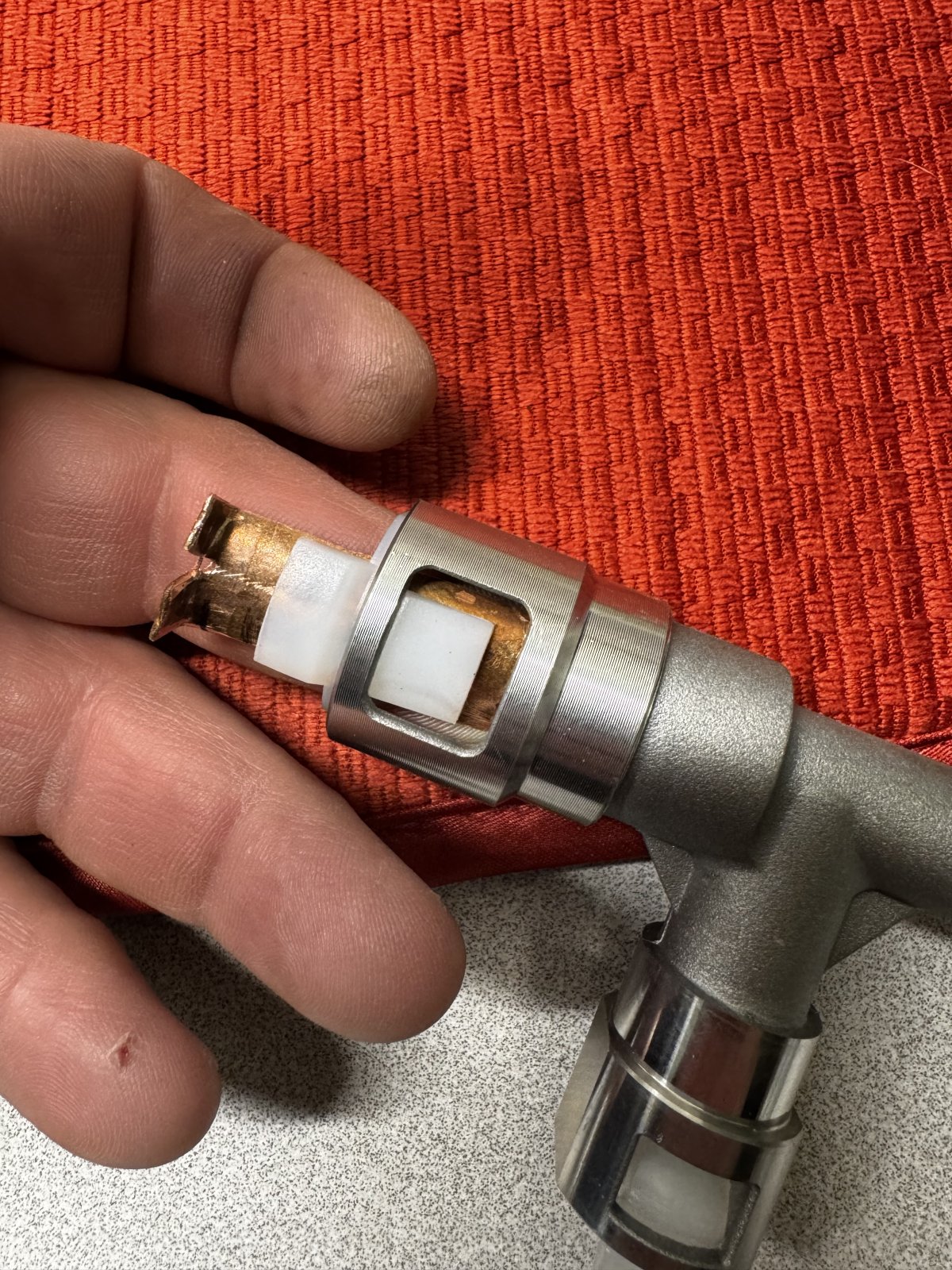

Has anyone tried these metal ones??

Looks to be the same 800-413 and 414 but with HP on the end.
30,698
48,333
I have not I think a couple people have. it is the same part just aluminum, which won't break but I wouldn't want to try and get one of those off if it started leaking down the road.
It is probably a solid fix though, then you just have to replace the hoses once in a while.

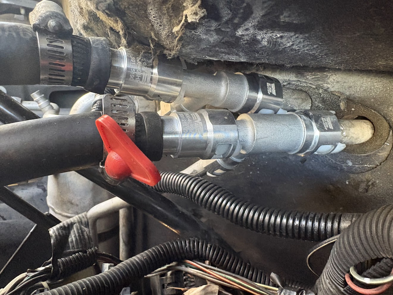

I just got done reading a thread about someone using the metal version of those fittings. He seems to be happy with them so far. I will be ordering them tomorrow and installing them soon. If you're interested, I can let you know how they workout for me and keep you updated on the future if I ever have a problem. It looks like I can get both Dorman metal connectors for about $50 total, plus tax from my local Advance Auto which is only a few bucks more than aftermarket (Dorman) plastic ones, and cheaper then new OEM plastic pieces from AC Delco, or whoever makes them for GM
TheAutumnWind
Jan 8, 2015
3,255
1,997
I installed them all about 3 weeks ago.
I feel much better about these than the plastic versions. The ones that I replaced were aftermarket plastic that weren't leaking, but they sure fell apart well I was removing them Very brittle.
