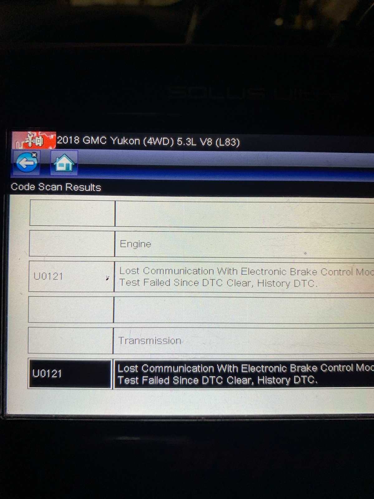

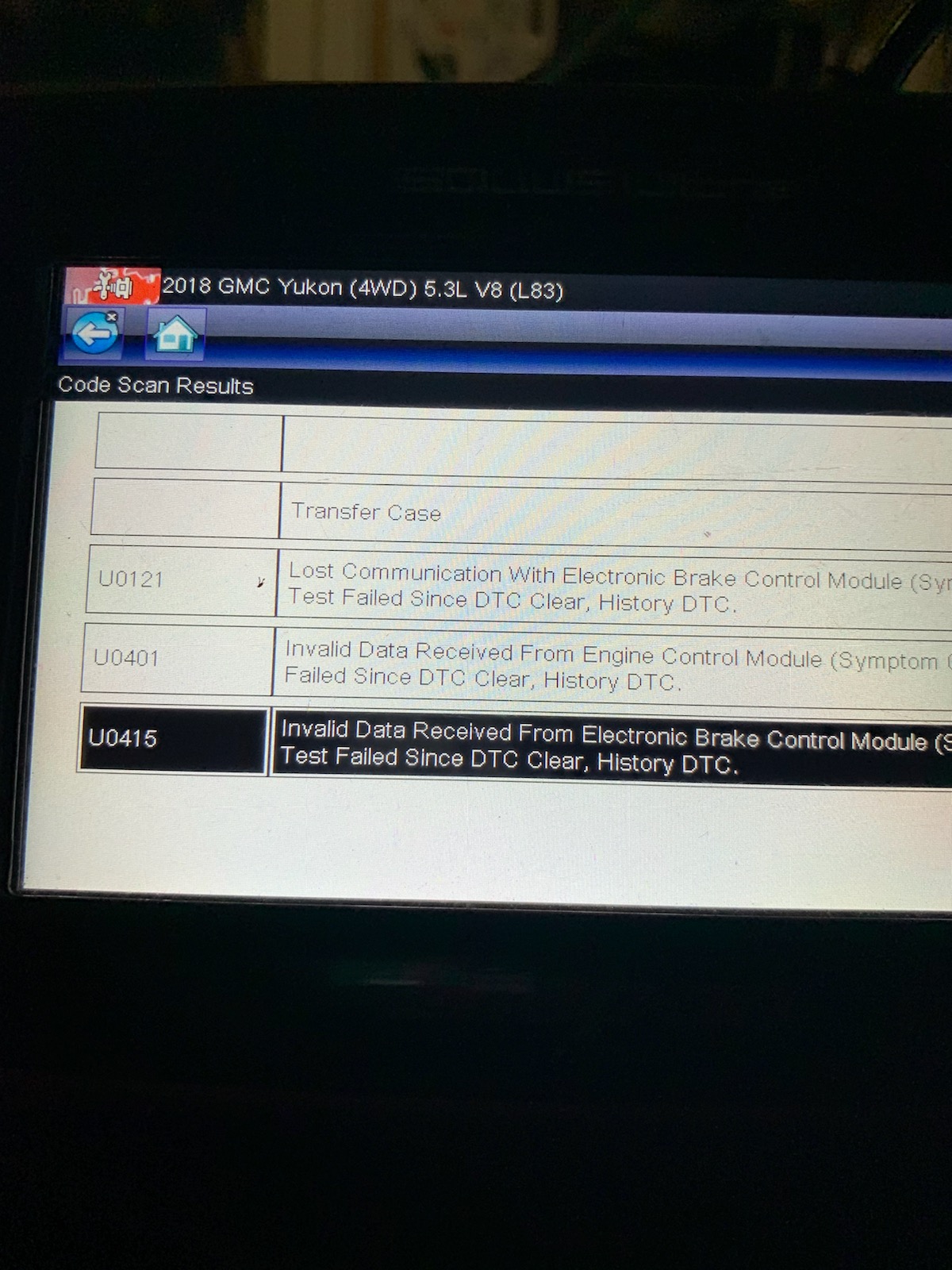

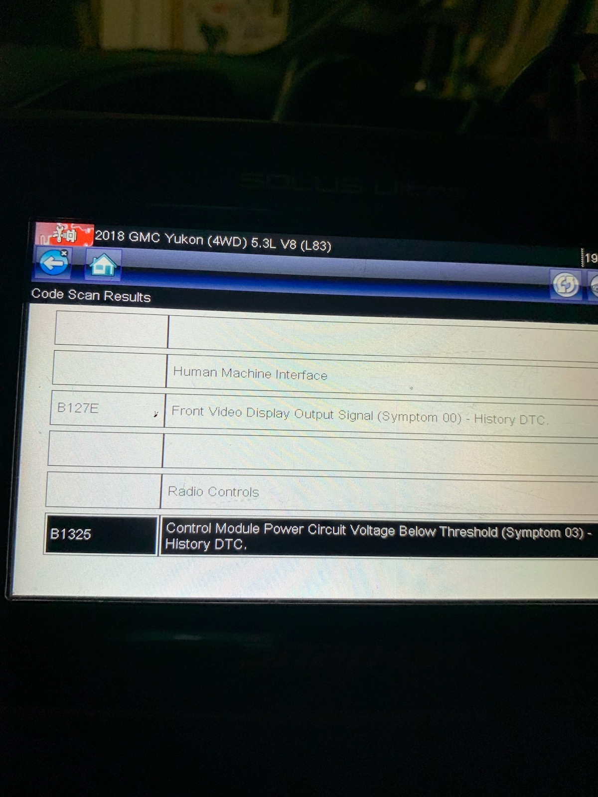

While dealers said no codes, I met with another local GM mechanic last night, he drives GM trucks himself, he works on them. He tested the truck and found codes, his theory that these codes point to a different problem rather than themselves amperage with battery, ground or something else. Because there are 3 codes that he saw. There was no Check Engine light for any of them...
B1325
U0415
U0121
B1325
U0415
U0121
View attachment 236401 View attachment 236402 View attachment 236403
What did he recommend as a course of action based on his assessment?

He stored them on the scanner, took photos, cleared them and now wants me to drive for 500 miles and see if any new codes pop up. In 500 miles I have to return to his shop and he will load test the battery and will see if any more codes are popping up on his scanner. If new codes pop up, there is enough evidence to take the truck back to a dealer with the Scanner logs and have them start explaining why codes, what electrical problems and ... why rough idle.

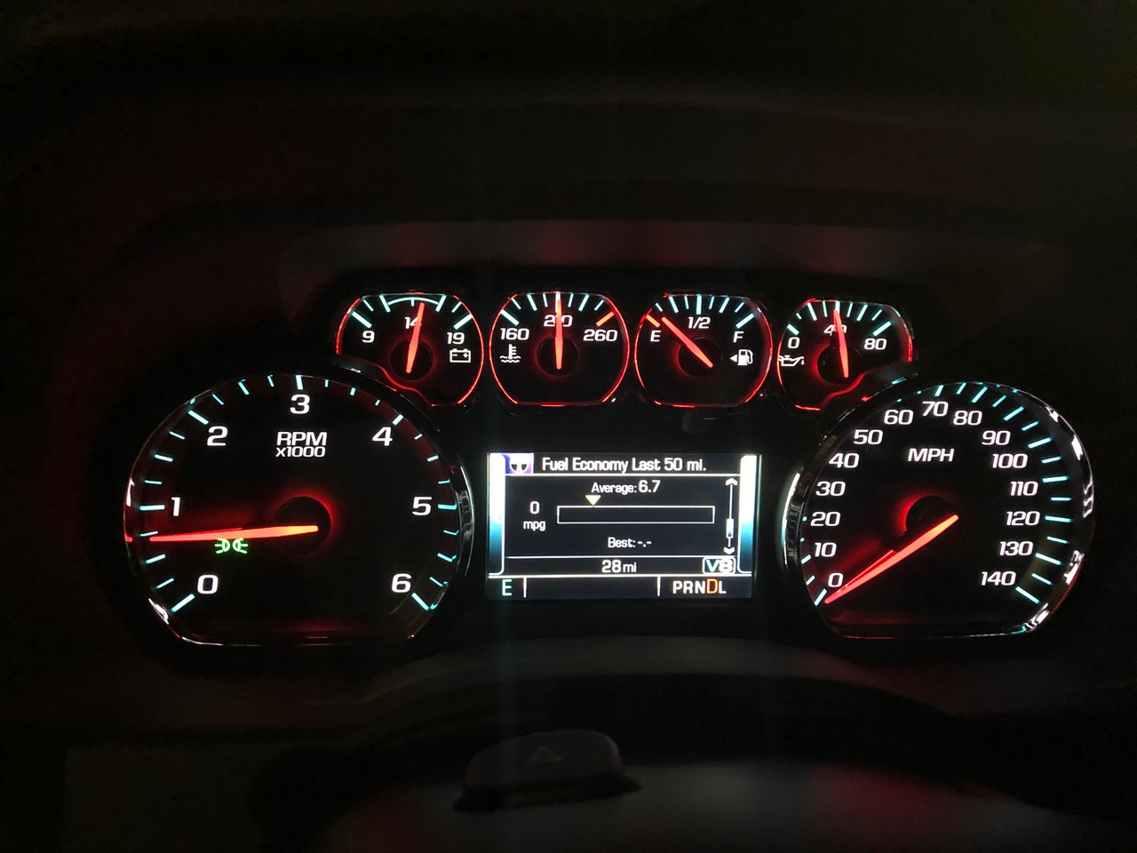

Interesting observations from last night's 2020 LT 4x4 brand new test drive. Drove the truck for 10 mins at 50+ MPH, came to the stop kept in idle in D and even after a minute in idle look at the idle RPMs - malfunction or ECM still learning?
B1325
U0415
U0121
found this on another site regarding B1325
"I'm a GM World Class Technician and I get nothing but problem vehicles like this. I've worked on a ton of the 2014's with random electrical problems like this. You know what just about fixes them all?.........Battery cables! I replace both positive cables and the negative cable. I bet you if a technician pulls some DTC's they'll find a bunch of B1325 in a lot of modules. The code will be a low battery voltage code. Basically, there is high resistance in the cables not allowing the full battery voltage to come through, so when a module gets around 9-10 volts instead of 12-14, it does crazy stuff. I would also change the battery a well. I'm almost confident this will correct the concern".

Thank you, I definitely now have electrical problems too B1325, U0415, U0121 were cleared but now vehicle has C0800, it all points that after last service some electrical connections were impacted... On top of my rough idle I now have electrical connections that are impossible to troubleshoot. I am taking it in on Tue again to address idle and to address now electrical. This truck is a royal pain...

Are these fresh codes? Do you have a subscription to AllDataDIY? If not, why don't you sign up for one and check out these codes. Mine has some of them and they all point to a voltage problem which is usually a bad battery with a faulty cell. If we've all learned on thing on these forums with these trucks, a bad battery can cause all kinds of grief and mischief with the electrical system. Kinda like that guy Chaos on those car insurance commercials!

As for electrical (5-6 codes appeared there after truck was from the dealer 12 days ago), no codes before
Codes found and cleared:
B1325 Control Module Power Circuit Voltage below Threshold
B127E Front Video Display Output Signal
U0121 Lost communication with Electronic Brake Control Module, Test Failed
U0401 Invalid Data Received from Engine Control Module
U0415 Invaid Data Received From Engine Control Module
Code found not cleared
C0800 Device power #1 (low current#1) circuit malfunction

You are spot on, everyone suggests the cables and/or battery. I have called the local dealer, asked them if they would take the truck in and check it, they said "these codes are common and nothing to worry about" we would clear them for you...
Battery cable(s).

It isn’t just connections. The cables have high resistance internally. They are common but are something to worry about because they can cause problems such as just the radio screen going blank up to the engine stalling if they’re bad enough.

This is how truck shakes when is fully warm, stopped in D in idle. Running 93 Octane Exxon. Bottle test shows the pattern of shaking if you watch carefully. BTW, if I put Regular gas - shaking pattern is the same except amplitude is wider.
