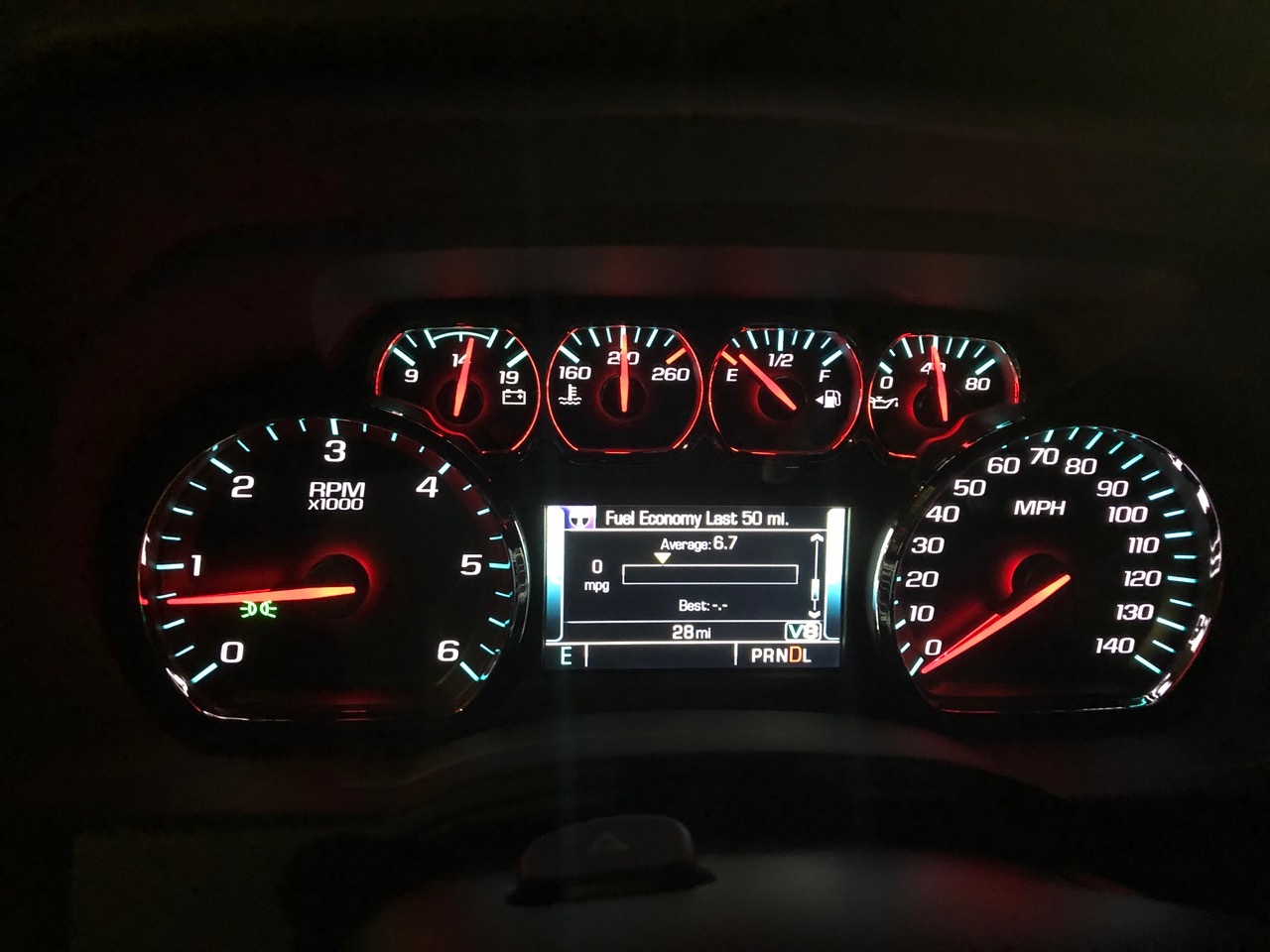

Interesting observations from last night's 2020 LT 4x4 brand new test drive. Drove the truck for 10 mins at 50+ MPH, came to the stop kept in idle in D and even after a minute in idle look at the idle RPMs - malfunction or ECM still learning?

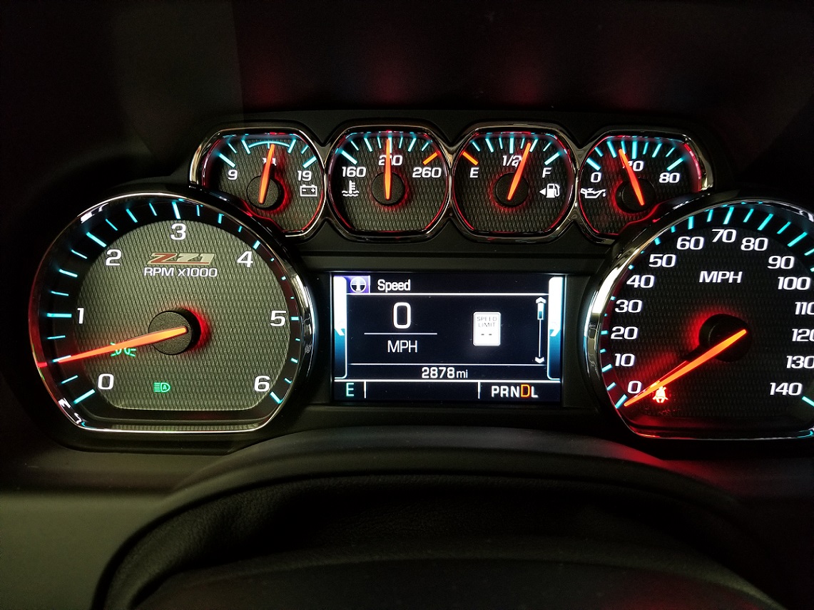

Hmmm.. Here's mine: this is fully warmed up, premium top tier fuel... I have a '19 though, so maybe that won't help you. But, for what it's worth -- ?

Thank you, this is about where mine sits in idle when it misses. So it sounds like that 2020 LT that I drove and saw it idling at ~700 was an anomaly.
Hmmm.. Here's mine: this is fully warmed up, premium top tier fuel... I have a '19 though, so maybe that won't help you. But, for what it's worth -- ? View attachment 236700

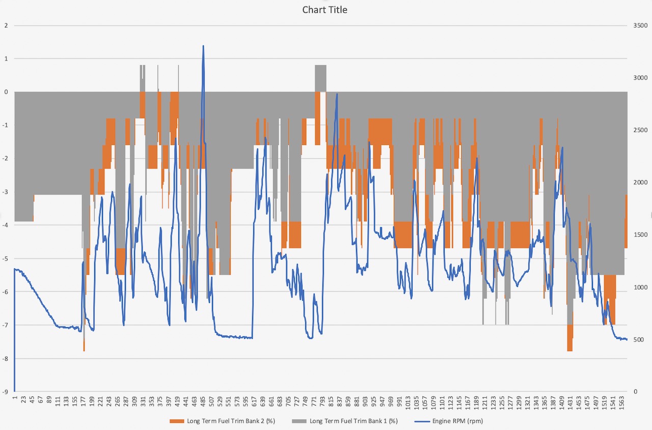

Seem fine to me. Was that a drive or just idling and raising the rpms in park? Have you checked your grounds and the battery cables? It's common for the trims to be negative, up to -10 or so while idling and then it will attempt to get to zero and if you are driving at a steady speed for a while the computer will get there usually. Sometimes not but close. Depends on fuel, weather, driving habits, etc.
It was driving. I have checked the battery connections all seem to be tight. I thought about disconnecting every connection at the body but I will need to figure out which connections and wires to re-tighten.
I dont know. Seems wonky to me. I don't like how low they are. Looks like a downward trend over the course of the drive. I'm having a hard time visualizing the graph vs the rpms. Doesn't seem consistent to me. What do the o2 b1s1 and b2s1 graphs look like? Have you messed with or replaced the o2s?
@HiHoeSilver
I am trying to plot, everything is far in negative territory, I must be running rich?
No I did not touch o2s ever and I do not have plots for them but will add them to the BlueDriver logger for tomorrow.

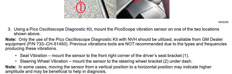

I am curious if there are folks here who are familiar with Picoscope process for this TSB 17-NA-166. Truck shakes very noticeably when cold and I would like to find a way to measure for this TSB. From the reading I have done, Picoscope measurements are hugely sensitive to the mounting location, method, etc. I would like to attempt to convince the dealer that my truck is a candidate for 17-NA-166.

I have spent a lot of time studying Picscope measuring procedure and talking to other mechanics and margin of error is so significant on these tests that the whole notion of Picoscope being the criteria for the decision is highly questionable. It takes 1+ hour to setup the Picoscope and then another 30 mins to calibrated for different types of measurements. Basically local former Ford Master mechanic told me that if you want to can get Picoscope to register or not register and you achieve all that by just slightly adjusting the position of the scope. I highly doubt that dealers will be doing it intentionally, it is simply too time consuming to measure properly.

It doesn't take anywhere near that amount of time to setup the Picoscope unless you have no clue what you're doing. I thought the last dealer you went to measure it with the Picoscope per that bulletin and it was below spec?

What I have learned that the only Pico that is approved is CH-51450-A. None of the dealers confirmed if they indeed used CH-51450-A. Another concern was that single-axis is measuring 10-12% less in E1.5 so only tri-axis should be used. I have no way of knowing if they used tri-axis. Given that one measured 1.2mg and another 1.5-1.75 it is not completely out of the question that simply mounting error creates big enough error to give incorrect reading and not in my favor. I wonder what would they do if I had a GMC performance exhaust, what I have heard that exhaust will cause all numbers to rise considerably.

I'm almost positive the Picoscope is a required essential tool for all GM dealers. The three-axis sensor is not required but the bulletin clearly states how to measure for this problem with the one-axis sensor also so it isn't that difficult. One thing you should understand is that you are talking to service advisors, not the tech(s) actually working on your vehicle. No offence to any service advisors out there by any means because the techs don't want their jobs but they generally only have a rudimentary understanding of what goes on in the shop, most of them likely have never even seen the Picoscope.

Yes, I was only led by this statement in the TSB mandating specifically CH-51450
