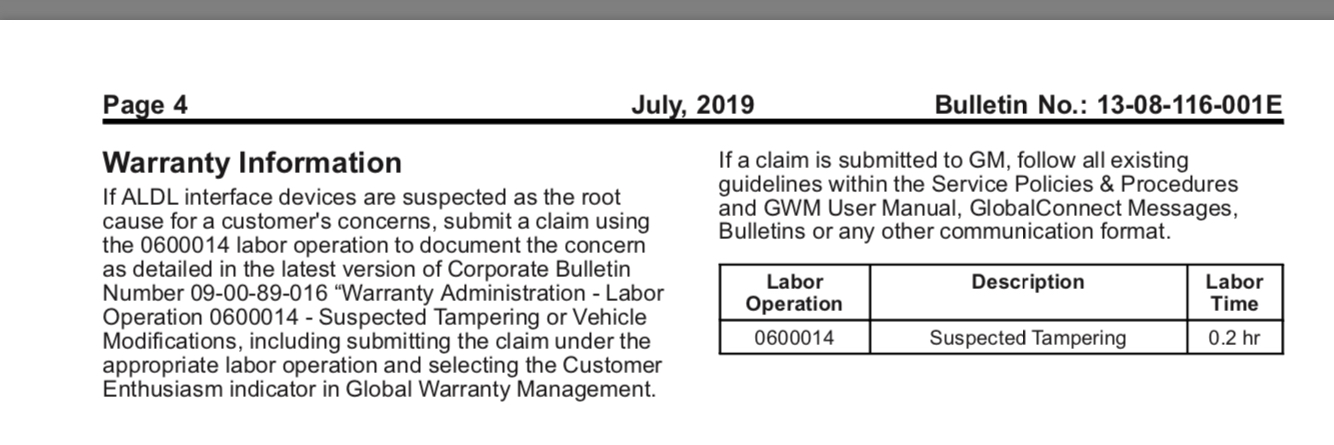

I bought and had to return the BB tune. Last time I visited the dealer with this complaint + DST codes I was having, dealer told me that my VIN is now flagged by GM because I am plugging these OBD aftermarket devices. Apparently BlueDriver causes flooding on the bus and all kinds of electrical codes pop up similar to mine, he did give me a copy of the TSB. There is a TSB out for OBD device users and dealers are now logging these users.

Was that TSB 13-08-116-001C?

Curious as well. When I had my mounts replaced dealer never said anything about my OBD use. At the time I was using a generic OBD not blue driver. The only way I think they can see it is that if you cleared the codes, they would determine it by mileage. It states how long ago codes were cleared by mileage and know someone other than them has cleared the codes. Just a thought.
I read over the TSB mentioned above and I think it’s more informative for the tec. I also find it funny they have a work code for “suspected tampering”. If they ever questioned me I would say it’s one of those insurance OBD readers or the one that tracks. I know onstar has the ability but those OBD ones are a fraction of what onstar charges for service each month.

I had to explain how I got to know that there are codes in the system. Bluedriver has shown me the codes to begin with while causing those codes. Another mechanic cleared the codes with the SnapOn and they appeared again. Some dealers are just really good and just there to help.
TSB they gave me #13-08-116-001E from Jun 26, 2019.

I was reading the bulletin.
https://static.nhtsa.gov/odi/tsbs/2019/MC-10163272-9999.pdf
There doesn't seem to be anything that voids the warranty by just using a reader. But, I don't think I would disclose to the dealer/GM that I was using any other device.
What is seen in the bulletin is people were dumb enough to take their vehicles into the dealer and leave stuff plugged into the OBD. I don't think GM has programmed the ECUs to track when a device access the port.
I don’t see where it will void the warranty. I can’t imagine GM telling a large fleet operator that their warranty is void if they find a fleet tracking device plugged in. However, the last section where it states if the technician suspects that the device is the root cause of the issue, they are supposed to flag it under labor code suspected tampering. That does put a flag on your VIN in GM’s data base and that is what @dvzzz mentioned. It will give a lazy Tech or tight warranty reviewer a reason to deny a warranty claim and put the burden on you to prove that the device was not the caused an issue.
That being said, yeah, remove your device before taking it in for service and keep quiet about having it. Don’t just unplug it and throw it into the glove box either. Leave it at home.

I do not imply that it voids the warranty. My problem is that I had multiple codes (posted them earlier in the thread) and one morning USB ports stopped working. Prior to that I ran Blue Driver for 2 days trying to log my fuel system and cats. Once I unplugged the Blue Driver and drove it for 2 hours, all codes disappeared and ... USB port started working again, and working up to now and no new codes either. Problem is when you use Blue Driver while engine running it does load the bus more than 99% of the OBD GPS devices that fleet managers or insurance use. Blue Driver is highly highly intense on bus traffic.
Another good reason to run the dealer's scan tools. Can't complain if you're using the same equipment they are.
