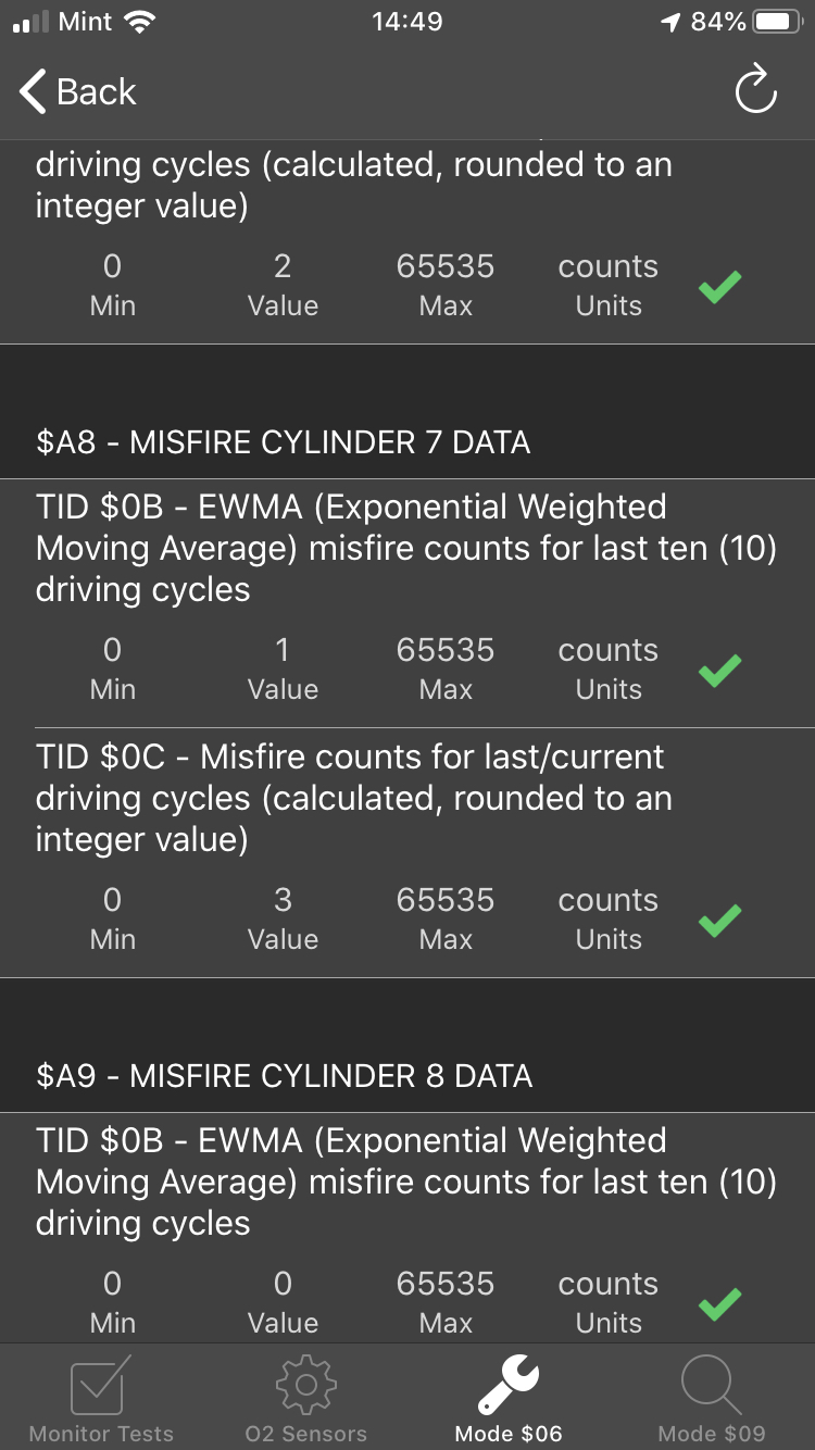

I drove it for several hours since the pickup, absolutely no change, still misses as before, $06 monitor still shows misfires on cyl 7, cyl 6, cyl 4, cyl 3, cyl 1. Engine still makes noise on the acceleration up the hill in higher gear.
