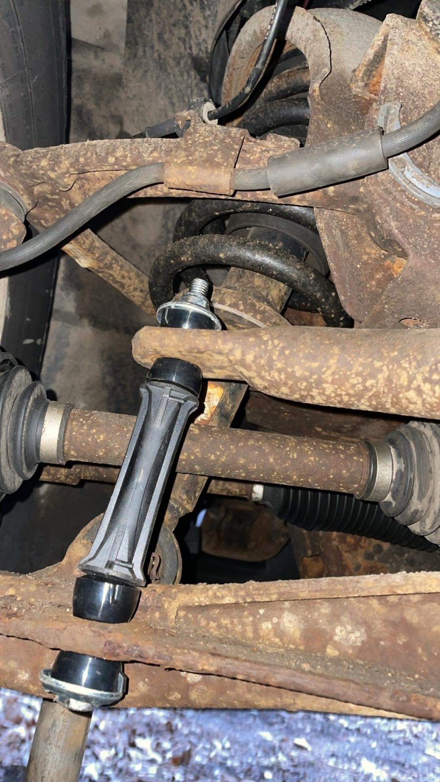

Yes, the front driver side is the one that looks the most suspicious. Your tire changing jack on just the driver front would be sufficient . Just trying to get some load off the link. Then do the same on the passenger side. If one is bad, you’re replacing both of them. They are pretty inexpensive. Actually, I would recommend you just plan on replacing them anyways because if they are not broken, they are well on their way.
My dad swears that that is what my clunking noise is that is happening random and intermittently. He says I don’t need a jack and I should be able to use an angle grinder with a cutting wheel to just cut them out and then put the new ones and he said it’s a five minute job each side.
He’s not wrong.

Where can I place the Jack to lift the whole front end? Cross member?
You don’t need to jack the entire front end up. Definitely not if you don’t have good jack stands or a proper floor jack.
However, I have lifted on the front cross member when I’ve had the appropriate equipment.

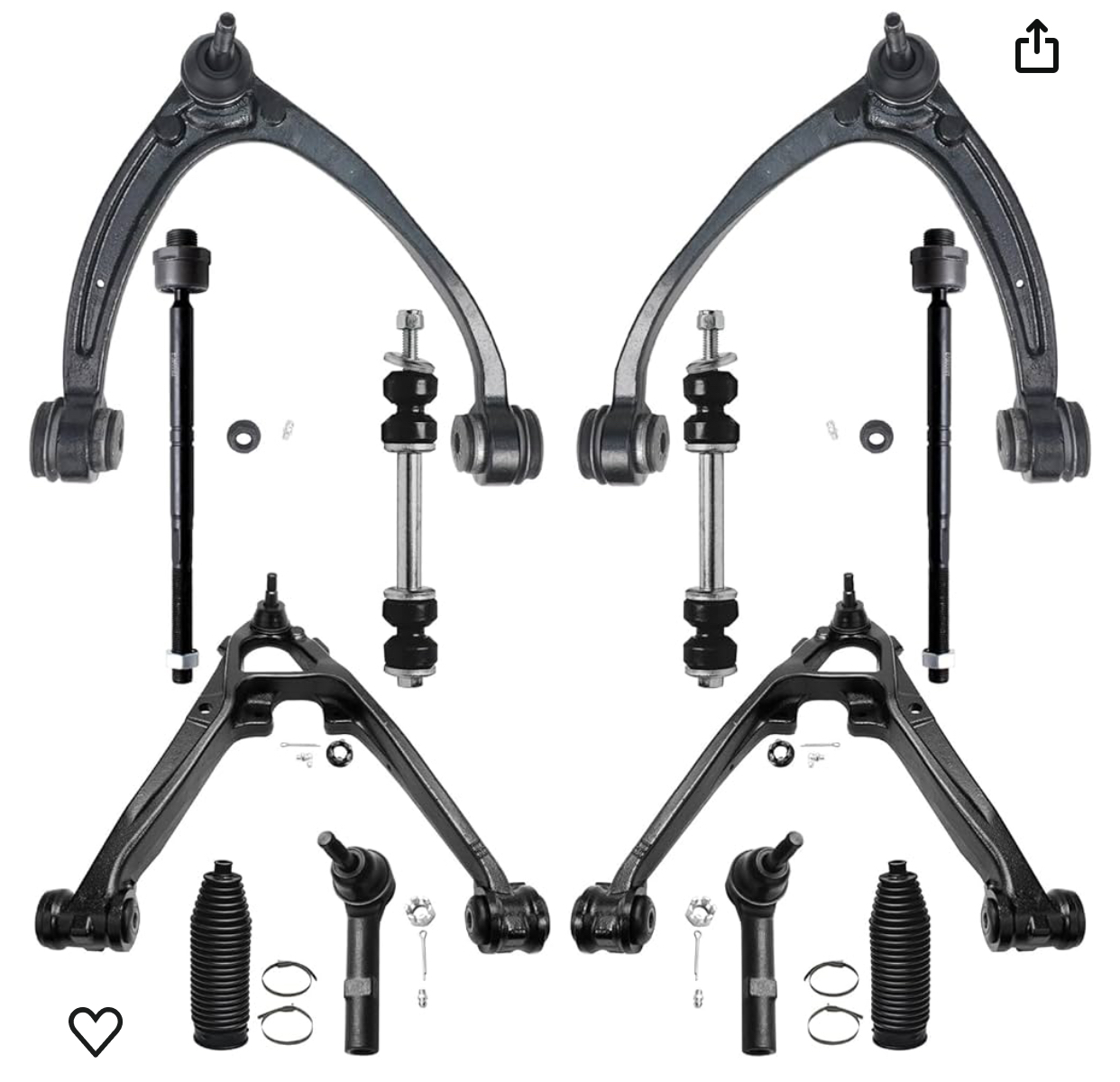

Put your feet up and watch YouTube on …
* 07-14 Tahoe sway bar bushing replacement.
* 07-14 Tahoe UCA / LCA replacement.
Assuming all your parts are forged steel (vs stamped steel and or aluminum) This is a generic kit that ships to the house for $298 + 10% off. Ships free.
Both left & right side New Upper & Lower Control arms, new bushings pressed in, new ball joints pressed in, tie rods & new boots to the steering rack, tie rod ends, sway bar bushings and hardware.
Either install some or all of it yourself or go to an independent shop and ask them to install only what’s most important right now. Keep the other parts for your next go at getting done what should have been done 75k miles ago.

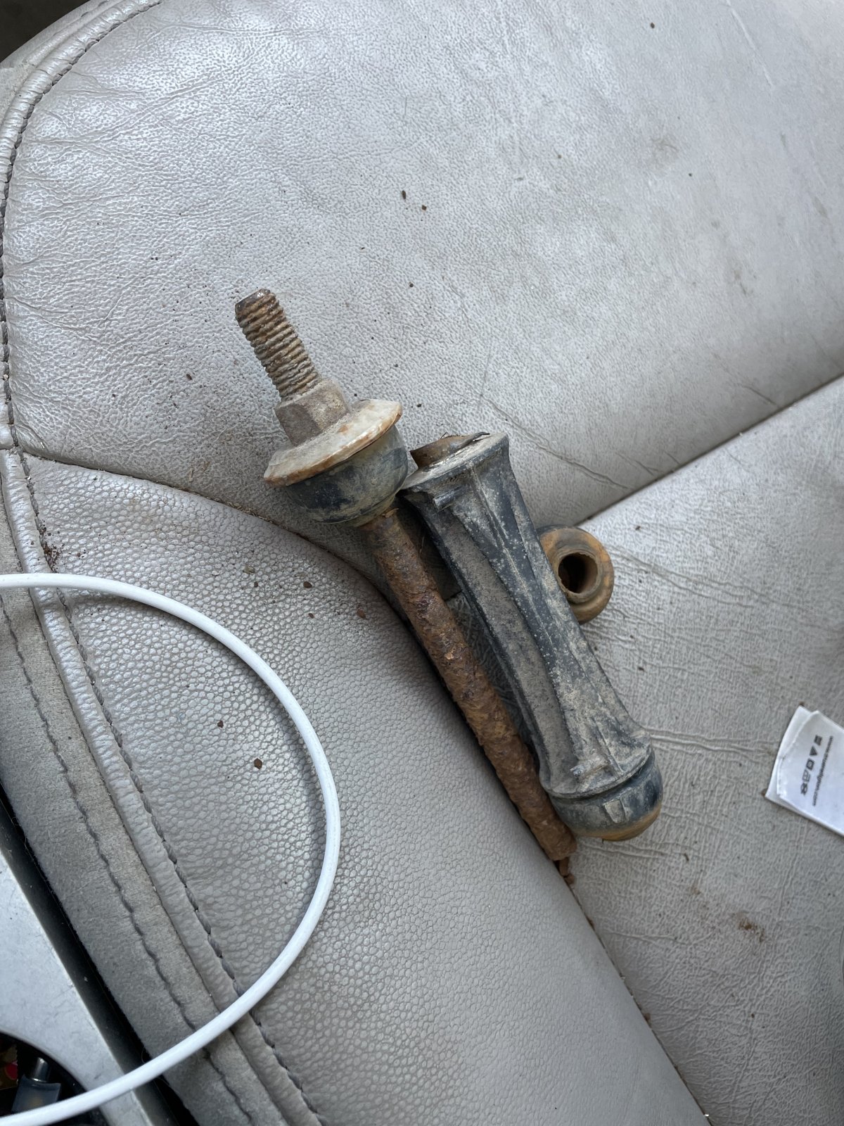

I believe it just needs the outer sway but bushings. Replacing those and going from there to see if it eliminates the pop.

Ok so what are you saying. I don’t have the funds to do all that stuff right now I can afford the bushings so that’s why I’m just doing the bushings. That is what is broken. Everything else looks fine. There’s no slop.
