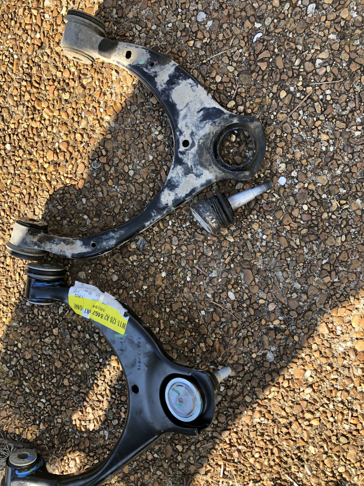

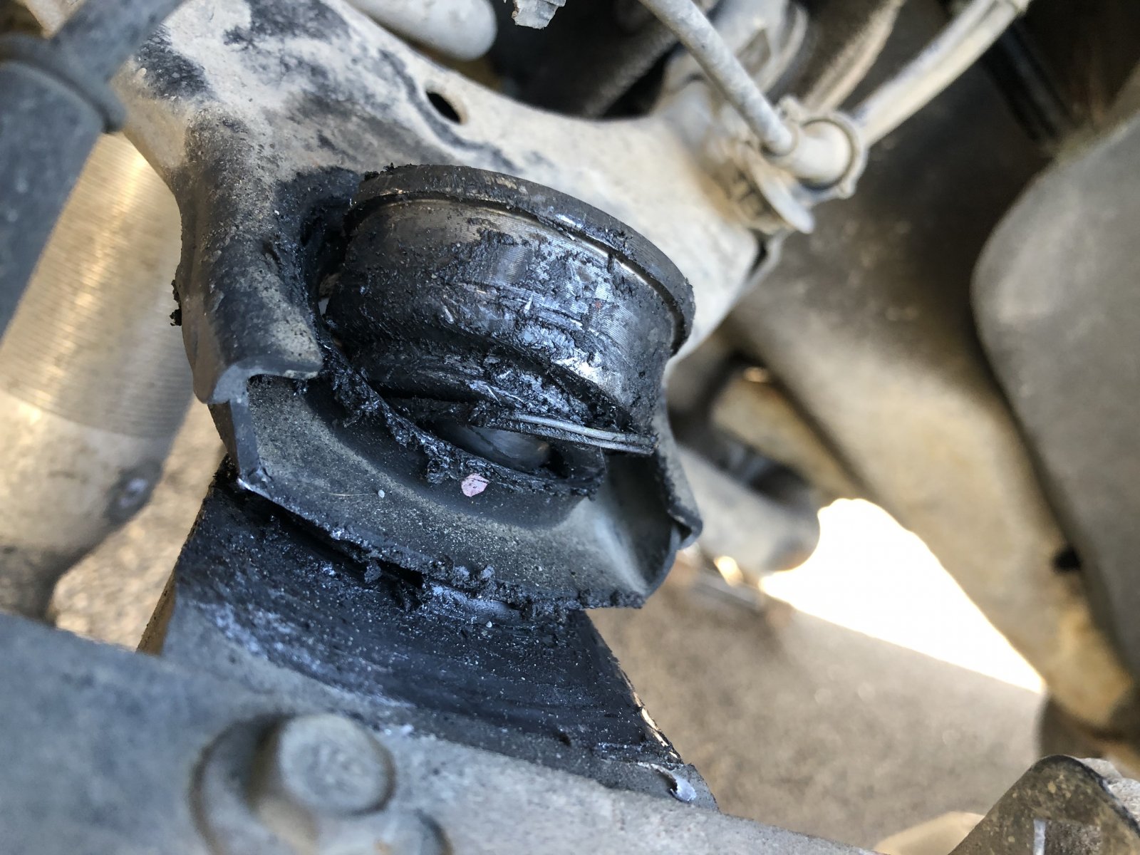

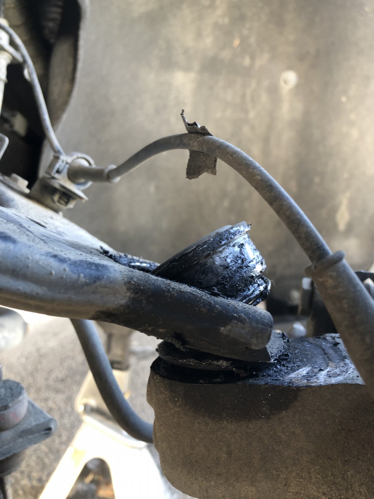

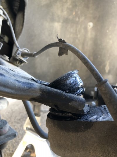

Well, found and fixed my problem. The first time I took the tires off, the ball joint wasn’t visibly loose, and as you can see my ball joint completely failed and was only still in because of the weight of the car holding it in place. Replaced both sides upper control arms. Needs another alignment but should be all good now. Replaced them with factory GM control arms. 103k miles.

That'll do it. Glad you're still here to post.
