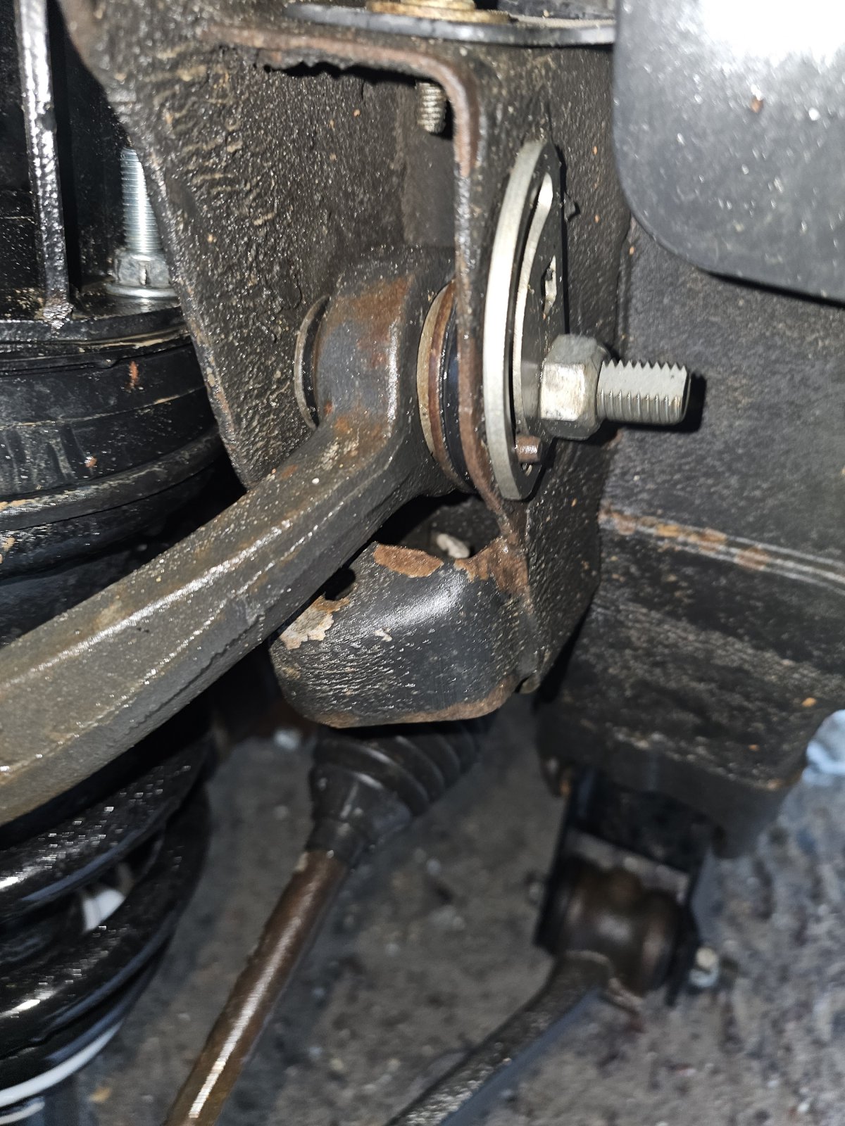

update i impacted the crap out of the top strut bolts and took it for a spin without the sway bar in line it seemed fine i did hear still some up and down metal to metal sounds but not as concerned about that but from a stop sign on take off i do not hear it i then came back put the sway bar back in line and i hear a faint thud so to sum it up i think the 2 main problems was orginally the strut (which i never removed until yesterday)and the sway bar link even though i replaced the end link but i did go cheap on sway bar link. i think my up and down metal to metal (maybe) is coming from the top control arm hitting the frame with it being stretched out but not sure. so all in all as long as it does not do it on take off i can deal the rest of the crazy noises this thing has made. the pic i attached is where i think the top control arm is hitting. hopefully all this will maybe help people who have the same issue that i did
