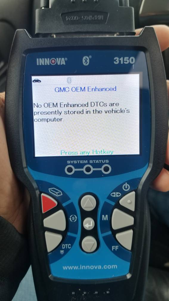

I cleared it through my radio before thinking to pull out the Innova 3150 to see what it brings up.
But we don't have a 3rd o2 sensor on either bank, do we? Just 2 up and 2 down I thought?
Or does this code refer to something else on our platform? When / if it come back on, I'll scan it to see what the 3150 brings up.

For all of yous who doubted me.
Only took 400 miles to pop back up. I will put the scanner on it during lunch to see what it says.
